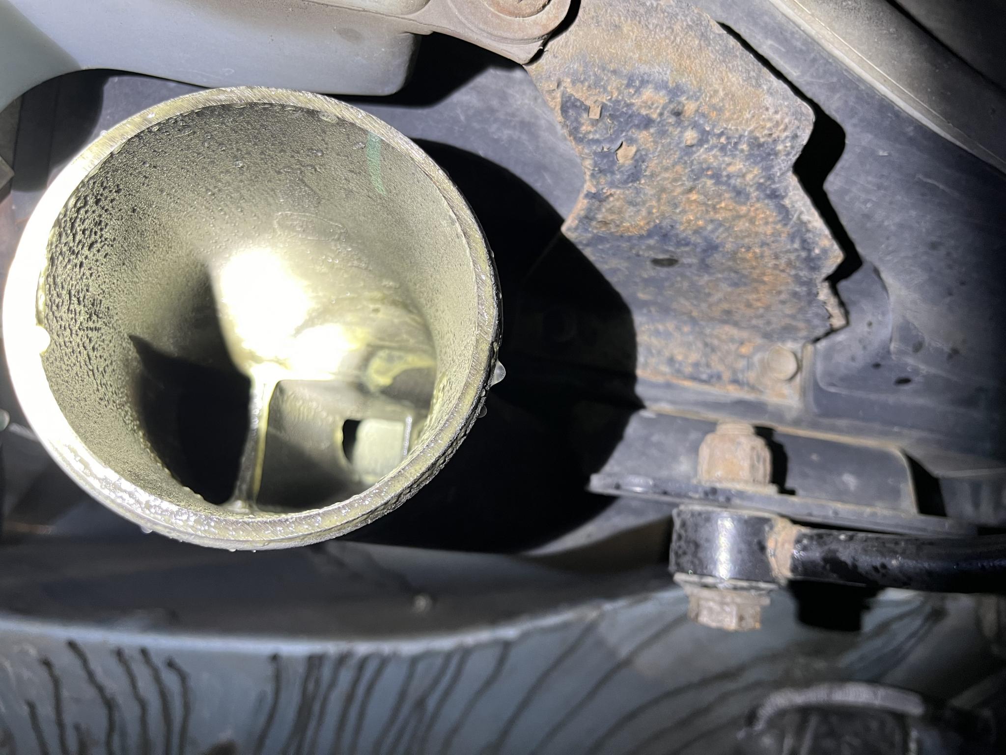

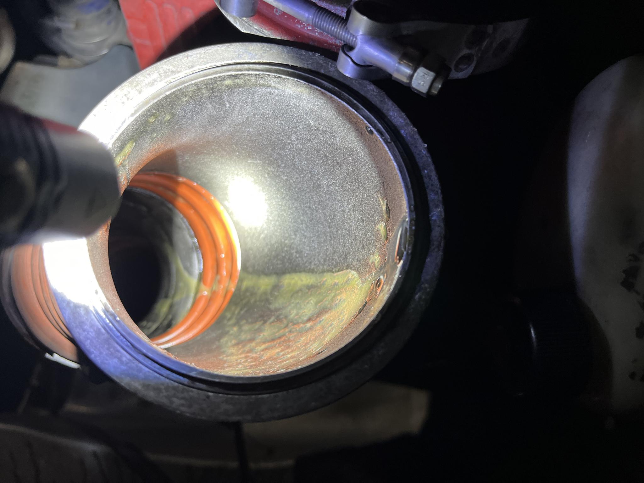

Moisture in CAC - Mrkentee - 02-20-2024 I know I have a little oil getting past the turbo. But I opened up the drivers side pipe and found moisture/condensation in it. I parked an hour ago after a long day, with some big pulls. Is the moisture to be expected? As far as the oil us concerned, it’s not much. I haven’t replaced the turbo yet, because I don’t want to waste the money if that’s not it, but I’ve checked everything else. [attachment=9347][attachment=9348] RE: Moisture in CAC - Rawze - 02-21-2024 the rule of thumb.. if it is getting the intake manifold wet as well, then its time to replace it. However.. most turbo slobber is the result of not enough positive pressure at idle.. or there being a crank case ventilation restriction. Make sure neither is the case. |
