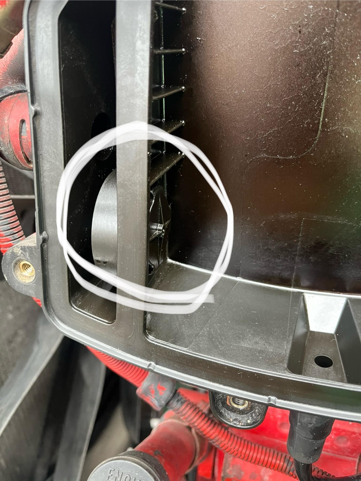

CCV box spring flapper - Mrkentee - 04-07-2024 Would it be worth it to remove this spring flapper, and not have any restriction of crankcase gases? I am using maintenance free filter, which is also drilled. In other words, is that likely to stick and cause excess cc pressure? Thanks[attachment=9404] RE: CCV box spring flapper - Rawze - 04-07-2024 I have not seen where one does, myself. RE: CCV box spring flapper - Weekend warrior - 04-16-2024 Maintenance free inserts are not restricted therefore no drilling of holes is necessary. If in fact you have high crankcase pressure faults need to do a blow by test and then eliminate what is causing it… turbo, air compressor or base engine. |
