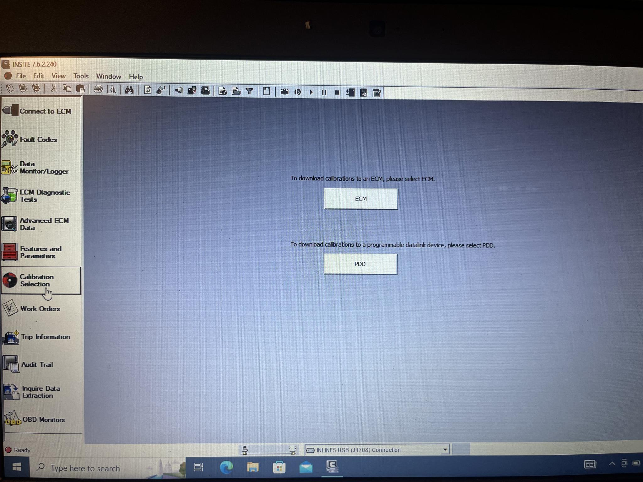

cm870 insite calibration - 3406E - 04-22-2024 How do i get calibration for insite 7.6.2. I'm fairly new with insite. RE: cm870 insite calibration - Rawze - 04-23-2024 (04-22-2024 )3406E Wrote: How do i get calibration for insite 7.6.2. I'm fairly new with insite. All the latest Calibration files are free from cummins. Straight from their website. The files are in a collection called 'Incal' disks. As far as Insite-7.6.2 goes ... it will not read them any more at all, as all the passwords change every so often on the disks/calibration files. Matter of fact, NO version of Insite will read calibration (incal) files that are more than 6 months old. It will delete them from your PC as soon as it sees them. Its some kind of kindergarten crap that ensures stealers%its do not use any older files (more than 6 months old) on engines when they have to update or re-flash the engine Here is how I get around this issue... ref: http://rawze.com/forums/showthread.php?tid=7435&pid=80171#pid80171 |
