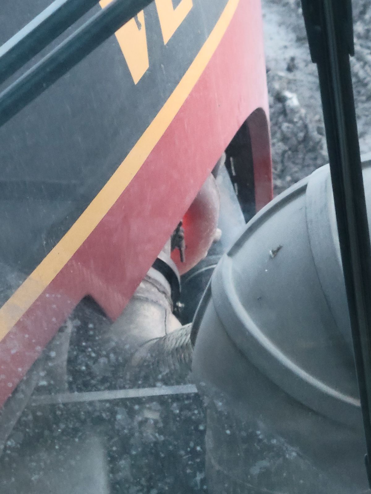

For entertainment purposes, this is what it was like before.
https://youtube.com/shorts/RbpD16rbW9g?si=dZa6CMHXHesNChTP
