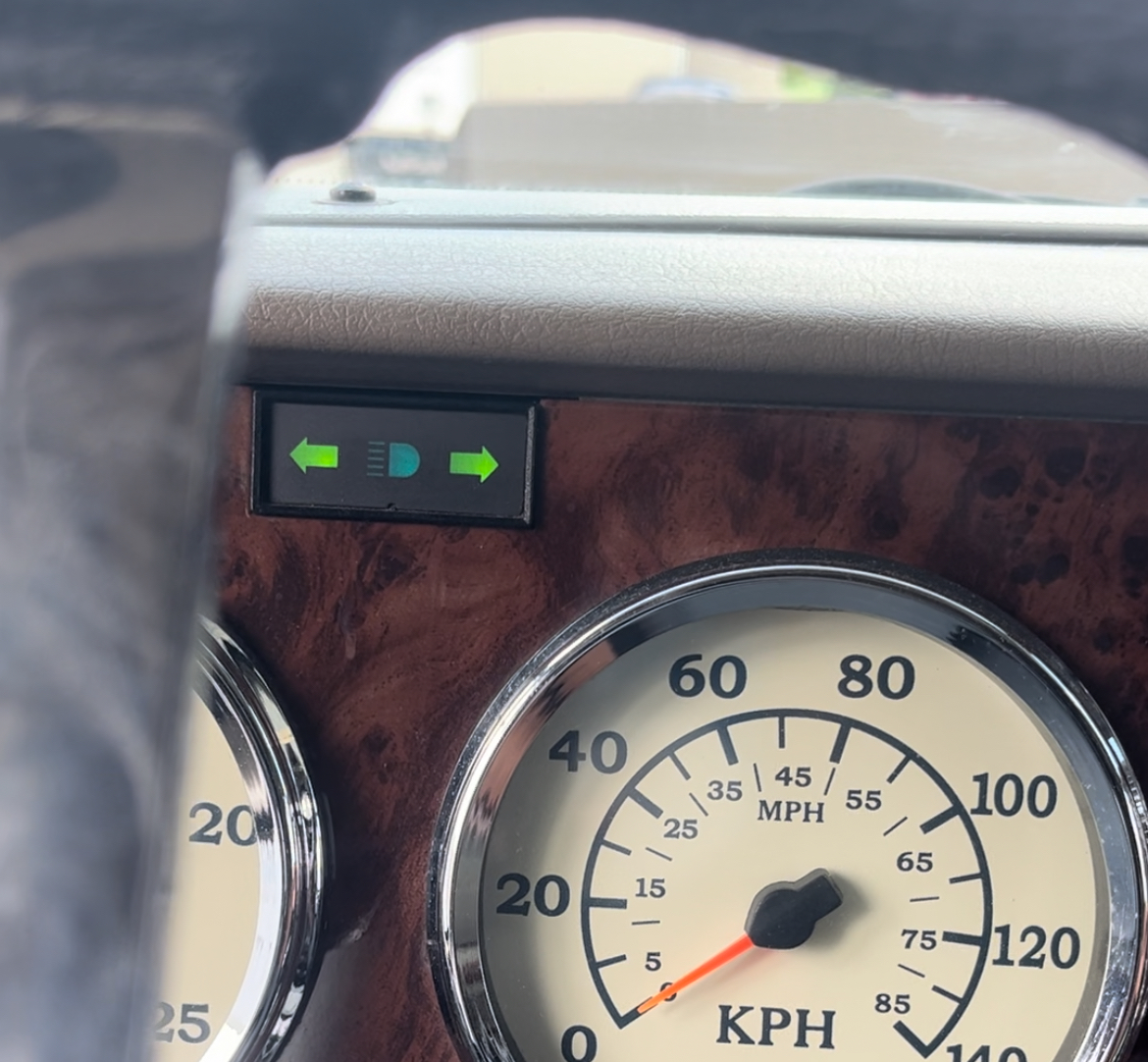

Lights - 3406E - 08-10-2024 9900 eagle 2005 / Was going through Indiana on the i70 on the bad roads and my headlights kept going on and off when I the bumps. Afterwards everything started to act up, when I turn my blinkers on the whole side panel lights starts to act as a blinker now. Headlights currently not coming on now both on high and low beam. Also when I turn off the blinkers it still showing it’s on in the dash meaning the blinker icon in the dash is still flashing even though it’s off. Any suggestions. Thanks RE: Lights - 3406E - 08-10-2024 My first thought was the headlight wire is shorting out on the blinker wire. Idk. Is there a control system for these lights on this truck? RE: Lights - tree98 - 08-10-2024 All those probably go through the cab control module which could possibly be going bad or have a wiring issue. RE: Lights - 3406E - 08-10-2024 (08-10-2024 )tree98 Wrote: All those probably go through the cab control module which could possibly be going bad or have a wiring issue. Don’t think this truck have that system, I think only the prostar and upwards RE: Lights - hhow55 - 08-11-2024 Perhaps if ypu were to start shaking wires the problem may reveal itself. RE: Lights - hhow55 - 08-11-2024 Could also be a bad headlight assembly.............See what occurs when disconnect the headlight assembly. Your situation is similar to a past problem i once had. RE: Lights - 3406E - 08-13-2024 (08-11-2024 )hhow55 Wrote: Could also be a bad headlight assembly.............See what occurs when disconnect the headlight assembly. Your situation is similar to a past problem i once had. thanks RE: Lights - 3406E - 10-05-2024 Forgot to update this. This was due to green death. Wire pigtails were corroded and broken. RE: Lights - 3406E - 10-05-2024 See attachments |
