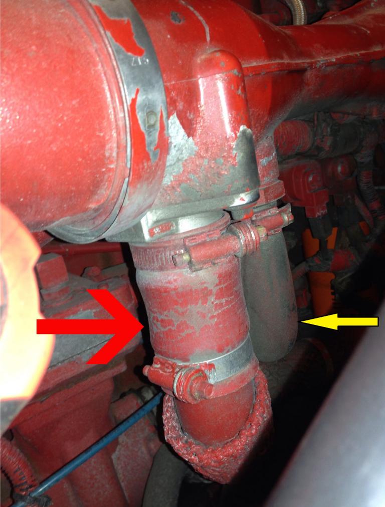

Check the air compressor intake connection to the intake manifold. There is behind air compressor head piece of rubber between head and pipe. If clamp is loose or rubber is bad it will do what you have.

(10-07-2016 )snailexpress Wrote:  Check the air compressor intake connection to the intake manifold. There is behind air compressor head piece of rubber between head and pipe. If clamp is loose or rubber is bad it will do what you have.
Are you referring to the hose with the red arrow or yellow arrow or both?
