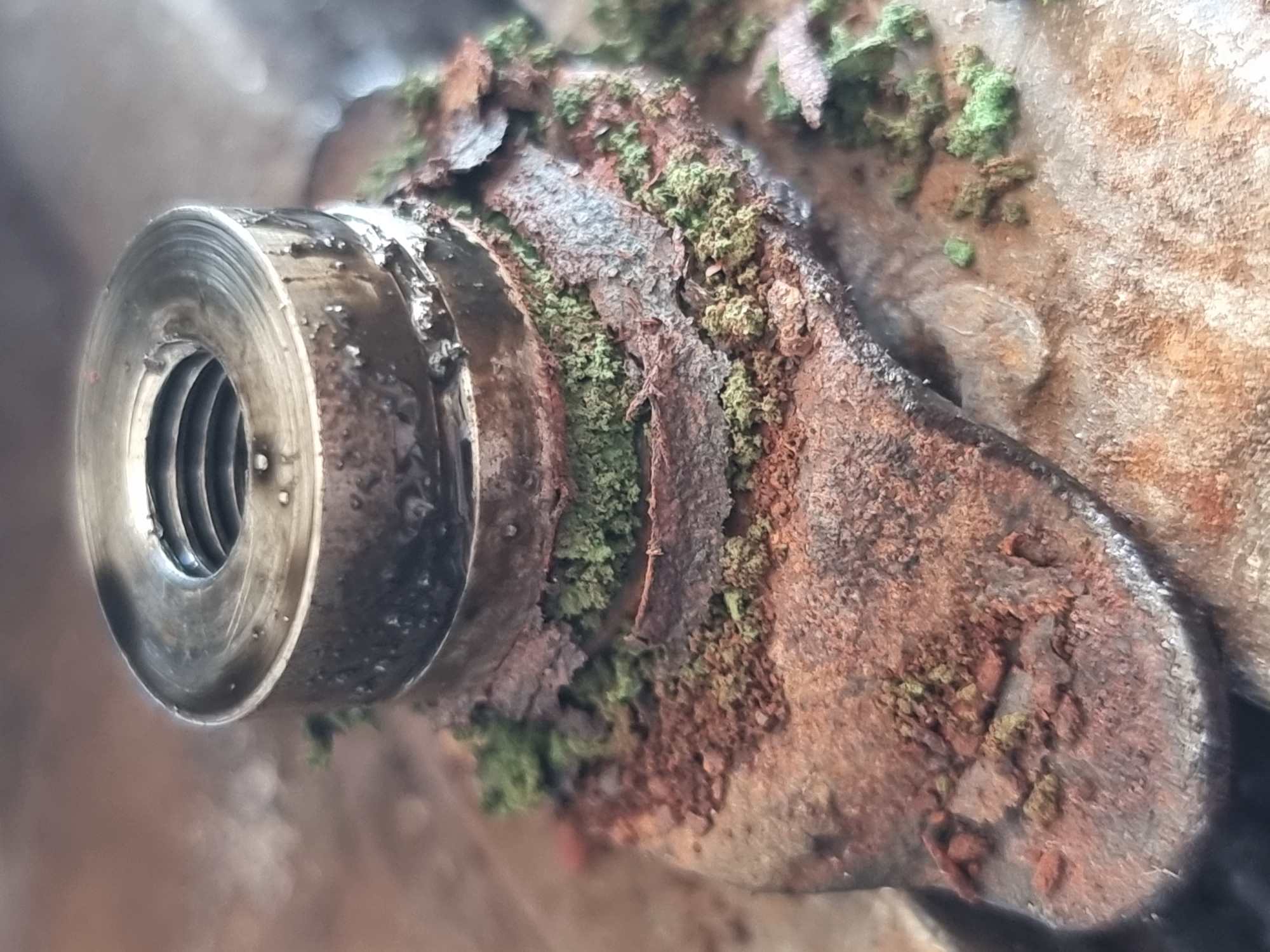

"Wheel bearing got little noisy"
The driver says how he checks every day if bearings are getting warm, and even lifts tag axle weekly to check if bearing spins freely and there is no play.
Looking at the picture tells another story.
./uploads/202511/post_7210_1763017852_77e1c923a36d10fc669b39dde4f761e1.jpeg
 Thanks given by: hookliftpete , marek4792
11-13-2025, (Subject: Tag axle wheel bearings )
RE: Tag axle wheel bearings
Someone can stare at stuffs all they want to,.. but if they never grease them,.. the result is that picture you have there.

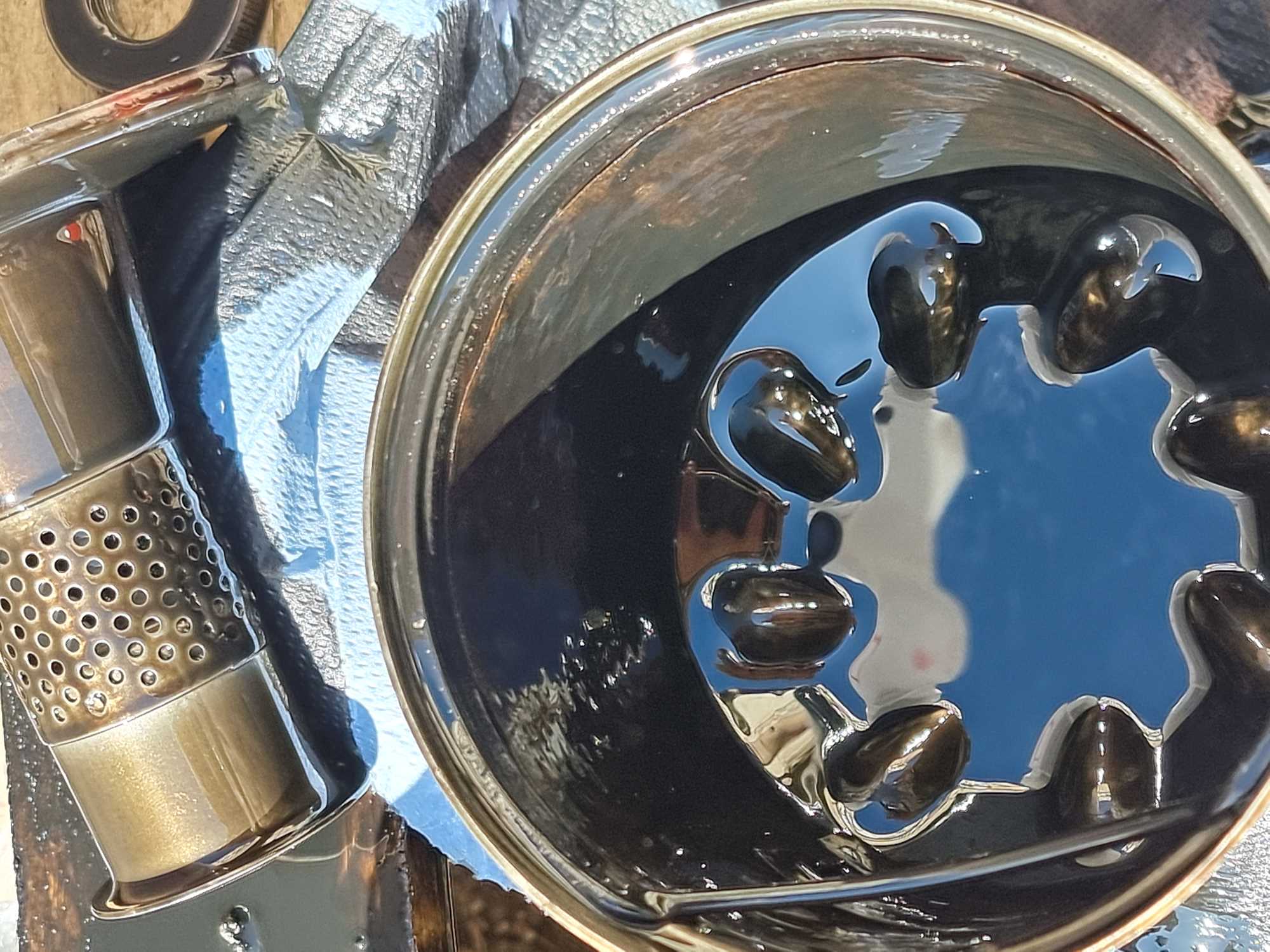

First time I did an oil change on this truck couple of years ago I cleaned out the oil centrifuge.
Top nut o-ring disintegrated between my hands, truck was 15 years old then. Maybe the guys who fix that brand truck have no idea that oil centrifuges exist on that brand for like at least fourty years on them already and they are supposed to be cleaned every oil change.
./uploads/202511/post_7210_1763051002_ad3f1eb870bfc0616e7a4b90965d4b1b.jpg
Oil centrifuge O-ring was misplaced and centrifuge did not work!
./uploads/202511/post_7210_1763051009_098ed146eb55f2a5dd4edba3b4313b0c.jpg
Common sloppy work present almost everywhere nowadays.

Usually the earliest sign of bearing end-play being loose is tire wear and then the subsequent vibration. Especially if you're pulling someone else's trailer and they only band-aiding it with new tires masking it instead of checking them yearly. 5 minutes with a jack and a tire iron per wheel end and you'll know right away, yet it's one of the most neglected parts and it has killed people... One can only retorque bearings so many times before replacing if the rollers aren't chewed up.

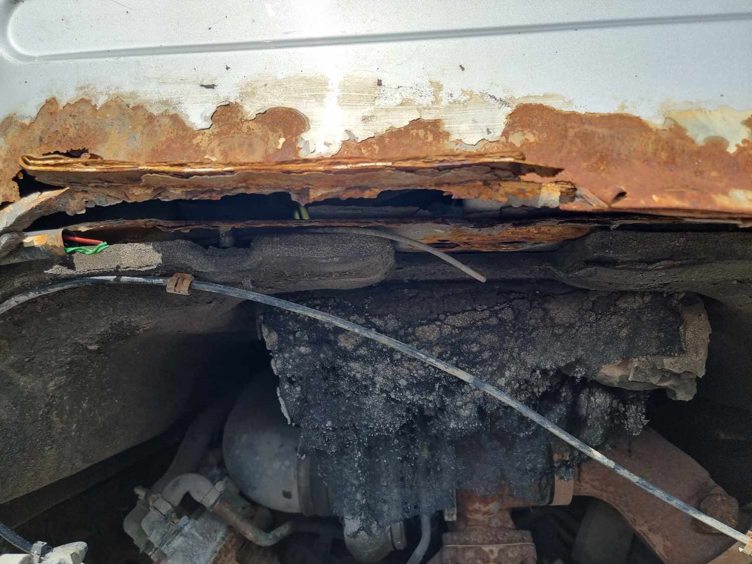

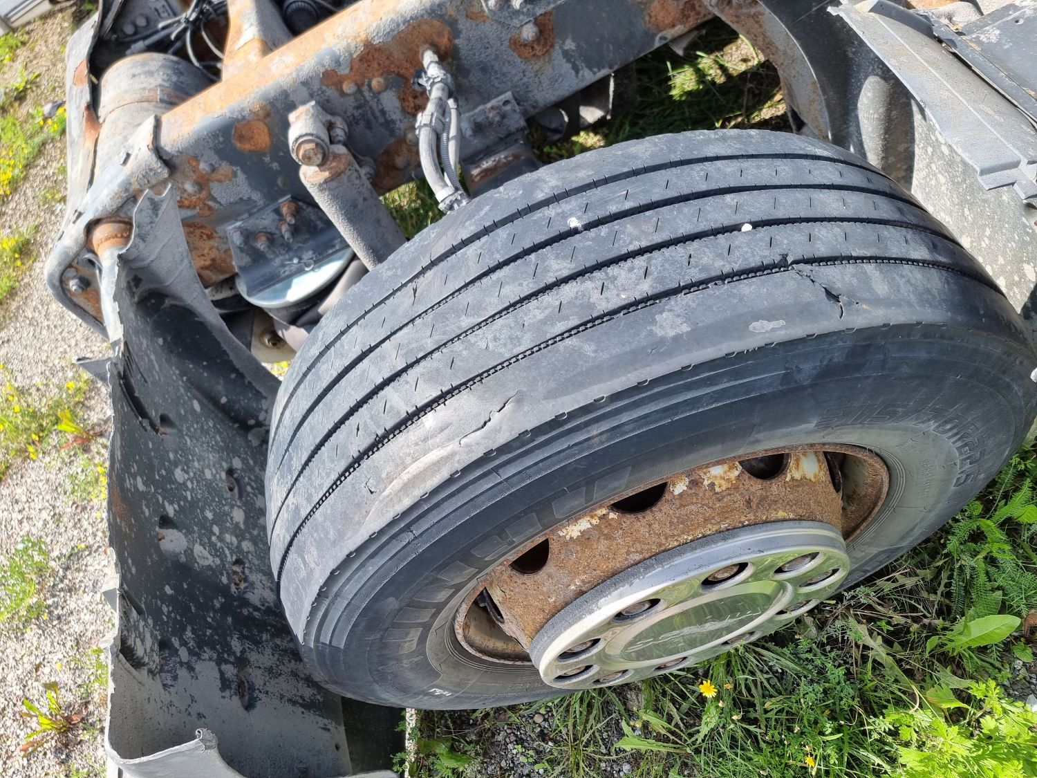

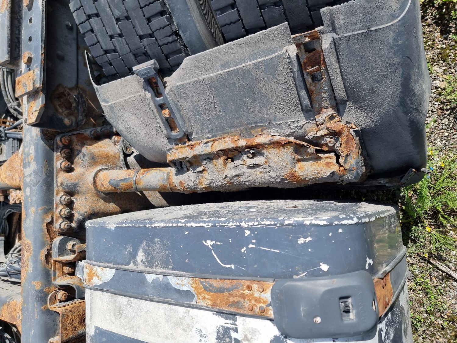

Two years ago I had in plans to buy five year old 25t tracked excavator and tri axle tractor + heavy haul trailer and also tipper trailer. Well I looked at quite a few trucks that were 5 years old, 10 years old, 15 years old, that had tri axles and and hydraulics fitted for trailer. Tri axle trucks are really common in Scandinavia, but there are harsh winters and lots of road salt used. As of today I have not bought big excavator or semi truck. Last year there was one well priced 10 year old excavator for sale, that dealership highly reccomended to steer clear of, there is reason behind the cheap price on excavators. Machine looked way good to be true, no big dents, no worn tracks, no hydraulic leaks. Maybe hydraulic pump has failed and it was just fixed up just to pass problems to somebody else.
Well 15 year old trucks I looked at were complete utter scrap metal, well they started and ran, somebody even used (or still uses) them daily to make money. But all the issues - enormous oil leaks, rust attacking (back of the cab had so big holes you could fit your hand through). They still had valid yearly inspection on them, somehow. PARTS ONLY in my opinion, some of the electronics there was fine and probably worth something, engines were rebuildable cores too.

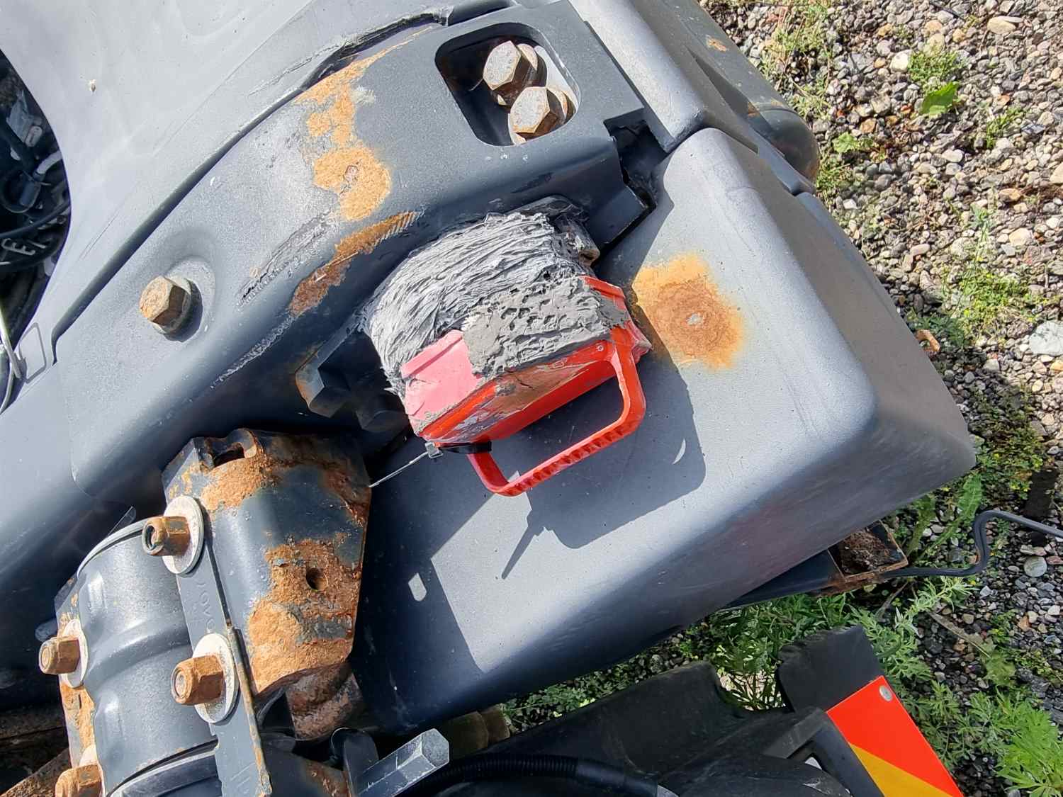

10 year old trucks most of them had some issues popping up, but repairs were done super cheap, retreaded drive tires were really common. Probably the reason for selling was hidden engine issue (liners dropped) or some other expensive issue meaning that truck is financially totalled if you pay somebody to have it fixed properly, but if gotten for cheap enough price it could be fixed up DIY and it would make sense to buy it IF you do not count time spent fixing.
Pictured is a jump start socket "repair". That jump start pole has LIVE power to it all the times.
