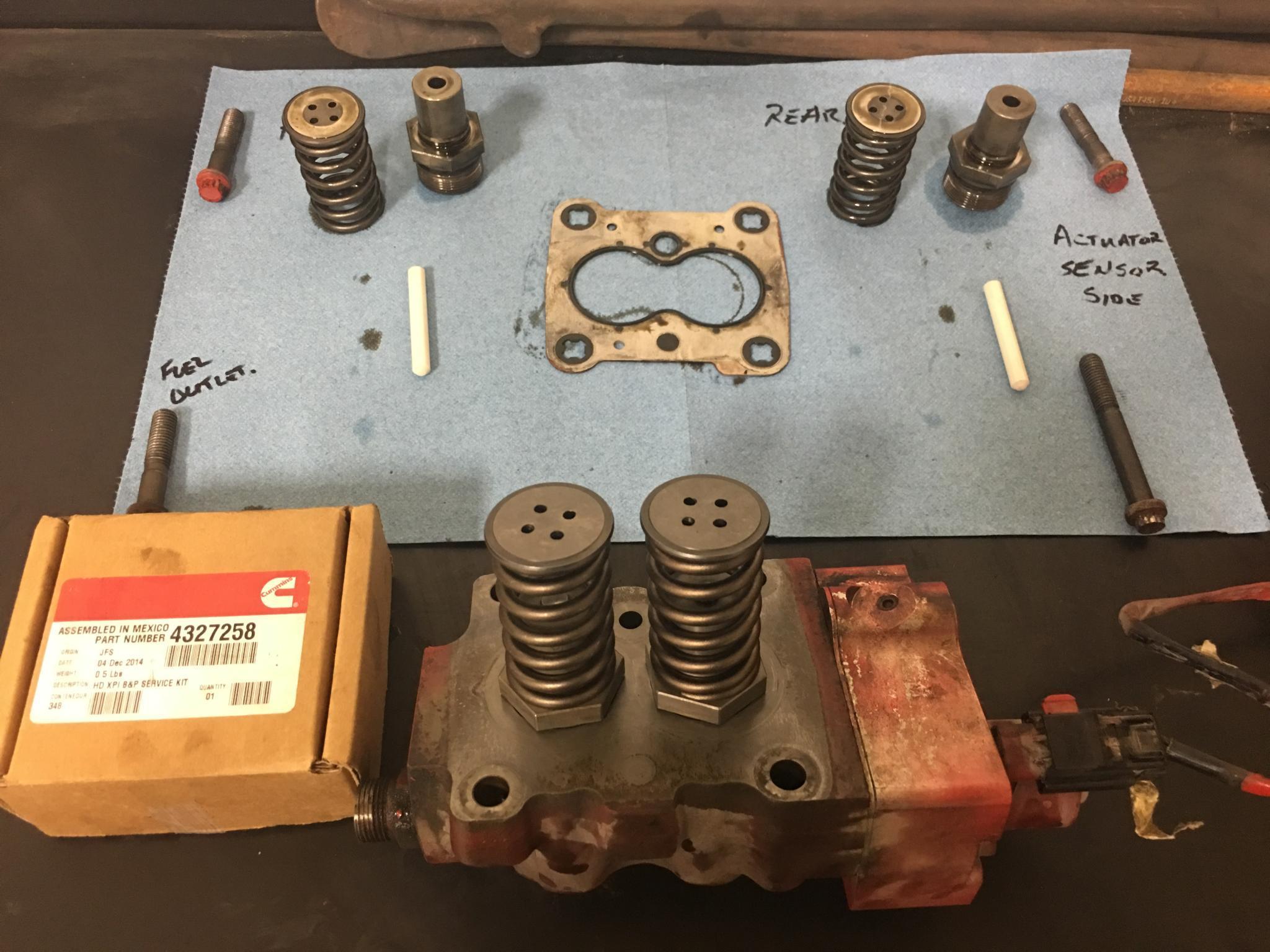

Helping a friend out with his CM2250. He decided as crazy as I sound, I'm actually beginning to make sense and he became concerned about his fuel pump. He was assured that this was an updated pump. Date of mfg on the valve cover is 12/12. A two cylinder pump...yup, you guessed it, with ceramic plungers! Or should I say, it now used to have ceramic plungers. Do not take anybody's word for it if you own one of these engines. Have it inspected, and inform whom ever you choose to do it to allow you to personally inspect them. He was told it had already been verified to have steel!
The white cylindrical pieces are the ceramic plungers.
You can note that I purposely included the box that had the "HD XPI B&P SERVICE KIT" with part number 4327258 in the photo for reference.
