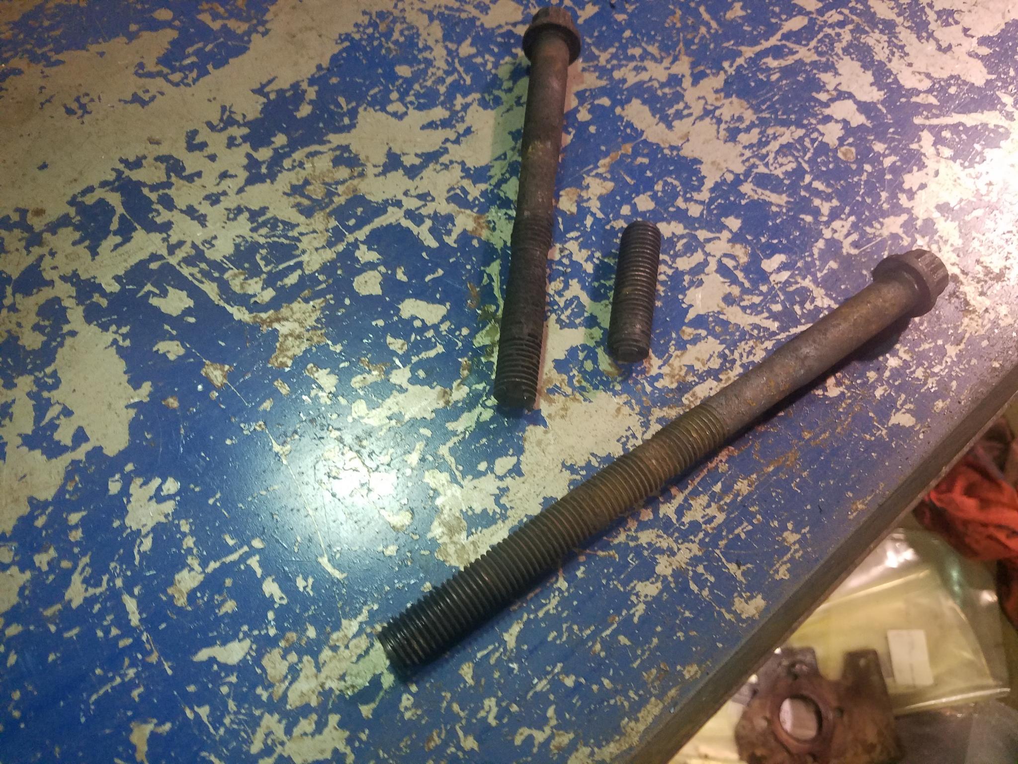

Update on Columbia/Mercedes 4000 blown head gasket My Mercedes 4000 engine from my 2009 Freightliner Columbia blew a head gasket. Dealer asked for enormous money. We found someone who works fixing these engines for a living. This guy said right on the phone, "probably a head bolt broke". He came to look, confirmed that it was likely, and quoted $800 in labor plus I buy all parts. I bought parts for $1,500. This guy and a helper fixed it in one day and one additional evening. The truck starts and drives now and I will try to use it today for something. I am kind of happy with this outcome, but he warned me that this is a specific problem with these engines and more heads (it has six separate heads) may break later down the road. | |||

RE: Update on Columbia/Mercedes 4000 blown head gasket ...maybe the bolts are made in China? Seriously. Got a picture of the broken ends of the bolt? If that were the case, I'd call up ARP and get them to spec a set of head studs for you. User's Signature: 2010 T2000, CM871, 13spd, 977k, tanker yanker Overhauled @ 927k | |||

RE: Update on Columbia/Mercedes 4000 blown head gasket (03-27-2018 )dhirocz Wrote: ...maybe the bolts are made in China? The picture of the ends of the broken bolt was attached to my original post. Please take a look. It looks like the bolt broke a while ago. | |||
