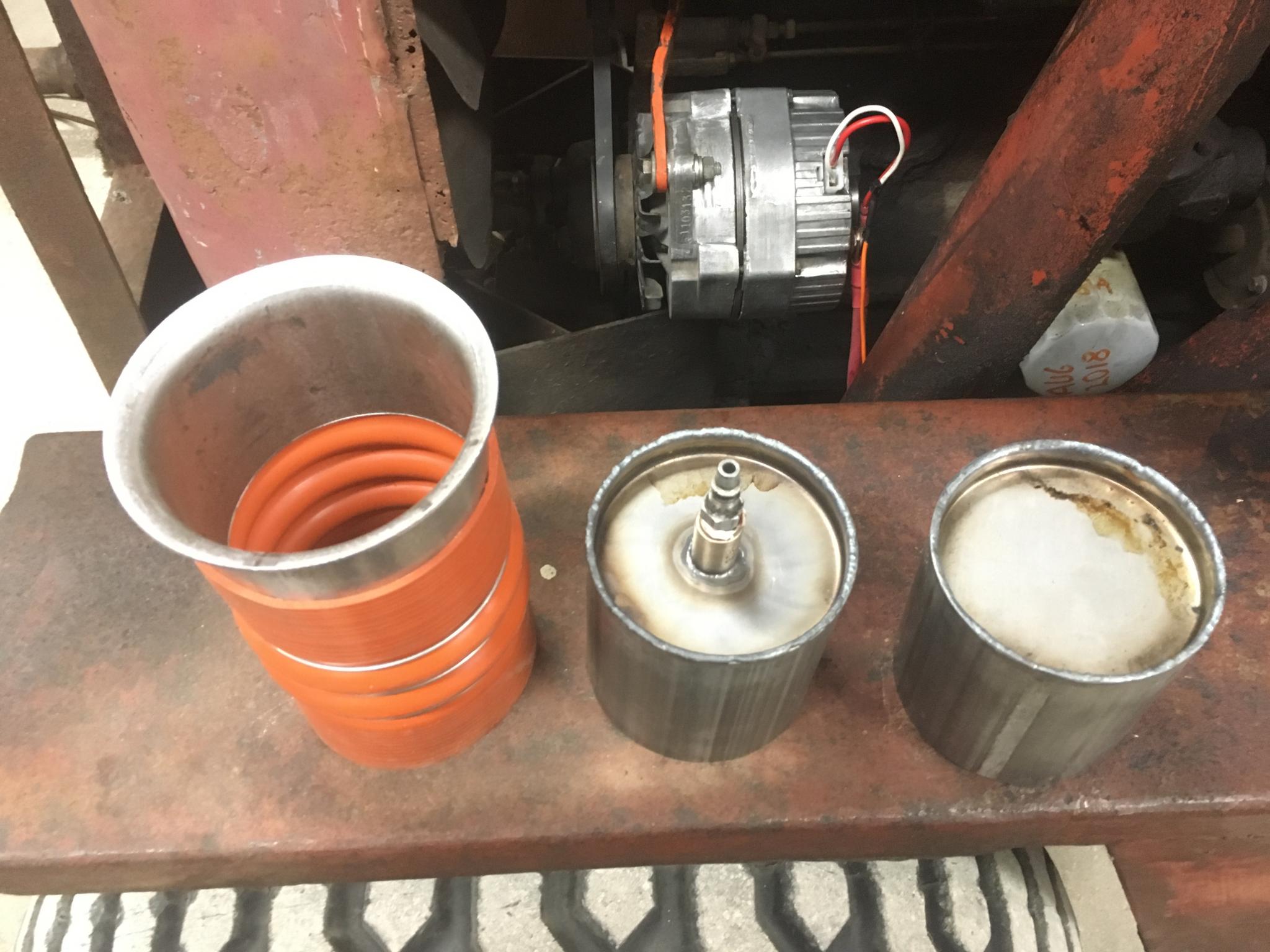

RE: Fuel mileage (10-02-2019 )Rawze Wrote: pressureize the whole engine to 30 psi. Check for leaks.You read my mind. I started collecting pieces to be able to do this last week Do you usually pressurize on the exhaust side of the turbo? Block off at the CAC air pipe where it goes into the intake? Or actually try to pressurize the whole motor? User's Signature: I have no idea what I’m doing and probably need supervising | |||

| RE: Fuel mileage I had these made up this week, and had my exhaust guy make up an extra turbo flange. I just didn’t have time to play with them today. User's Signature: I have no idea what I’m doing and probably need supervising | |||
