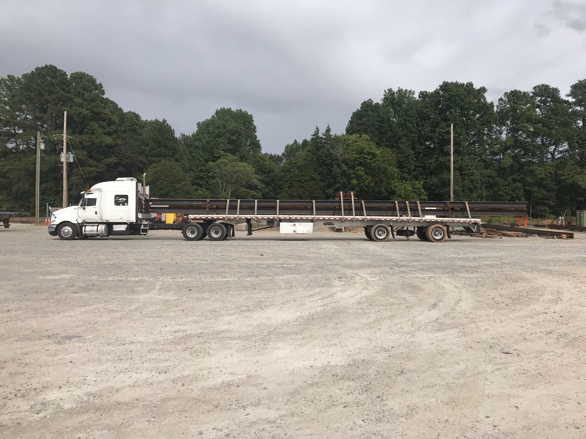

| RE: What would you have done differently?? I'm on the bridge division but we haul anything. Recently bought this truck and figured id join in the fun. ![]() Only 133' long and was 50,000 lbs I think. Fairly small and light so it was an easy trip. Having a police escort at night sucks, you cant see shi#t. | |||

RE: What would you have done differently?? (01-06-2020 )hkerekes Wrote: I'm on the bridge division but we haul anything. Recently bought this truck and figured id join in the fun.If I remember correctly these were 75 footers. I do a really lot of long stuff, great money. Did a bunch of 80 foot pipe up in Va this summer. | |||
