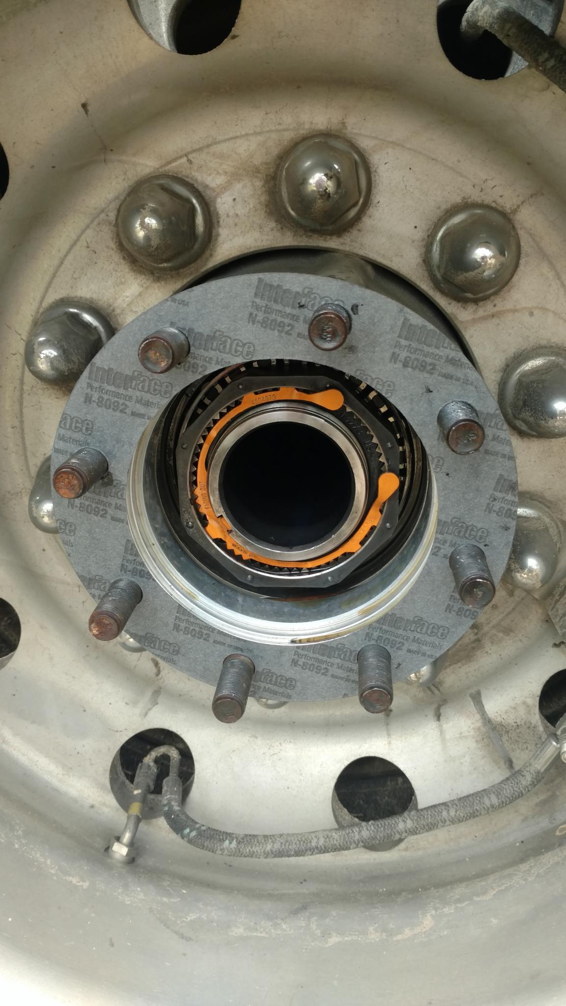

Here is a picture of the type of lock they use.

That picture looks like a stemco brand single nut lock system,I have that style on my steer axle

Ya, now that I looked at that picture. I have the same nut system. But I do NOT have crush sleeves. They have a totally different torque pattern then the ones with the crush sleeve. You can NOT mix the 2 up. It will be very dangerous to move the vehicle if you do. I would verify you have crush sleeves behind that nut before running it. You risk trashing the bearings and catastrophic failure if you torque the nut to crush sleeve specs. Without having them present.
