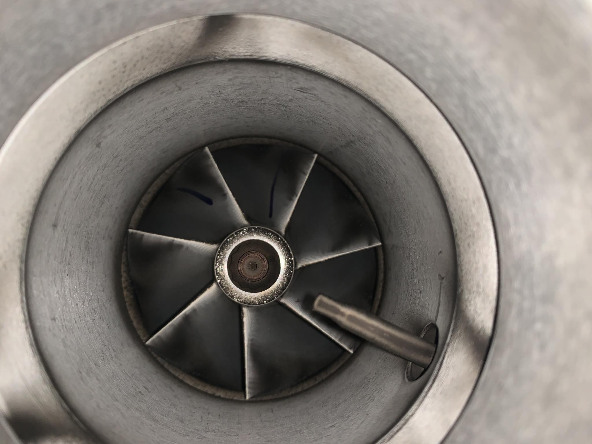

| RE: EGR pipe Any tips on getting the boost pipes off to look at the turbo? Everything is being very stubborn and I don’t want to break the clamp to the turbo or rip the rubber boots. | |||
| 01-24-2021, (Subject: EGR pipe ) Post: #15 | |||
| RE: EGR pipe don't worry about those big clamps on the silcone boots, just remove the small clamp on the turbo outlet and then you can move the pipe side to side enough to look in. Also, remove the clamp on the front of the turbo on the black elbow to see and inspect the turbine blades. User's Signature: "...And as we wind on down the road, Our Shadows taller than our Soul..." | |||
| 01-24-2021, (Subject: EGR pipe ) Post: #16 | |||
| RE: EGR pipe I figured that out after I got it off haha. Well here it is. | |||
