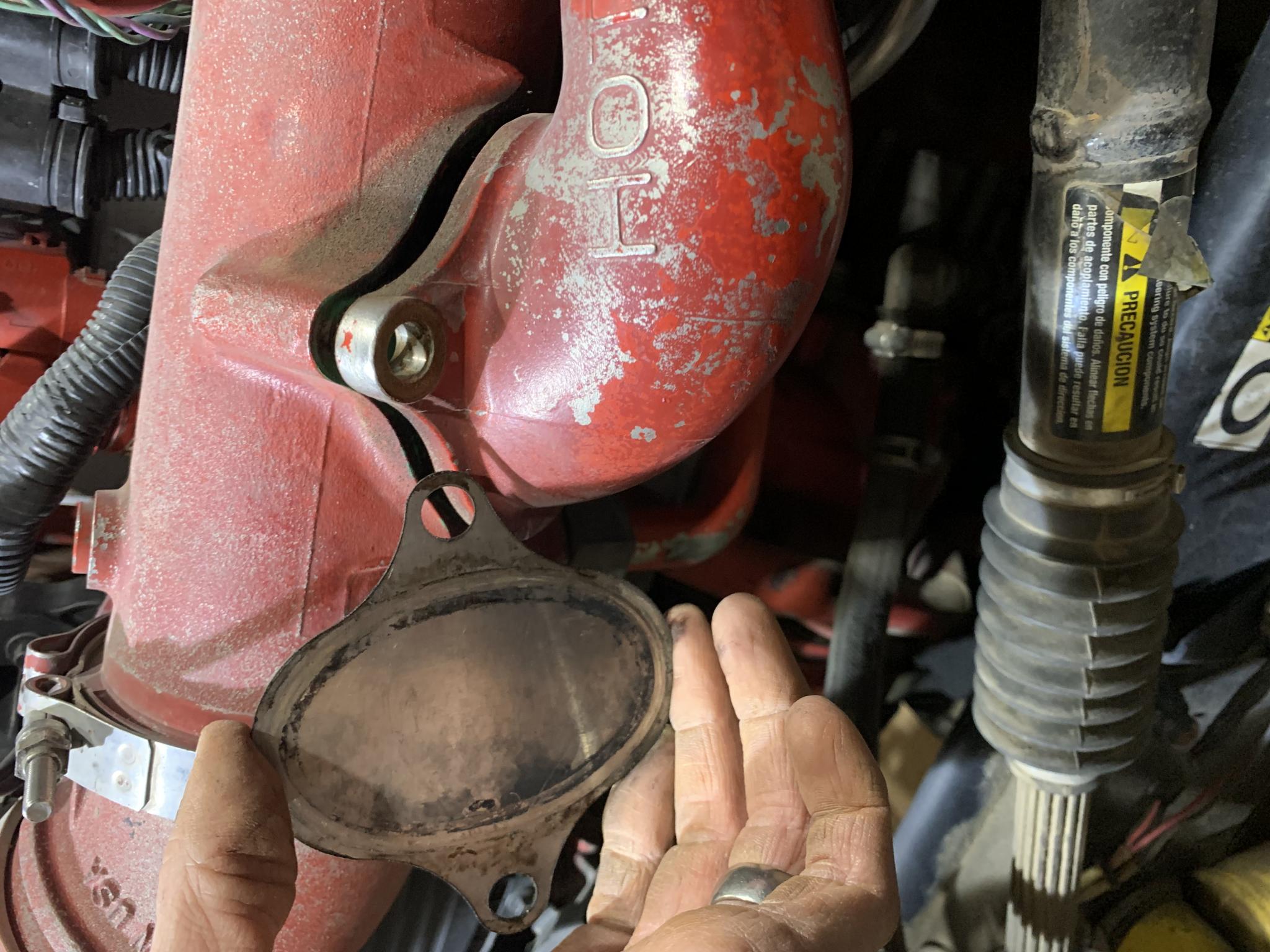

RE: CM871 poor power and fuel econ (02-18-2022 )Grounded Pilot Wrote: More info. I guess this thing is E.G.R. Deregulated or somebody just put a block off plate where it meets back up with the intake tube. Is that a piece of thin clear plastic?? Or maybe just very thin sheet metal?? Either way that's a good way to damage your engine and turbo when that thing let's loose!!! | |||

RE: CM871 poor power and fuel econ (02-20-2022 )tree98 Wrote:(02-18-2022 )Grounded Pilot Wrote: More info. I guess this thing is E.G.R. Deregulated or somebody just put a block off plate where it meets back up with the intake tube. It’s a piece of 1/8” aluminum. Fits the tube pretty perfectly in place of the gasket and is plenty heavy enough to do the job. But I have played phone tag with the mechanic to ask about the programming side of it. | |||

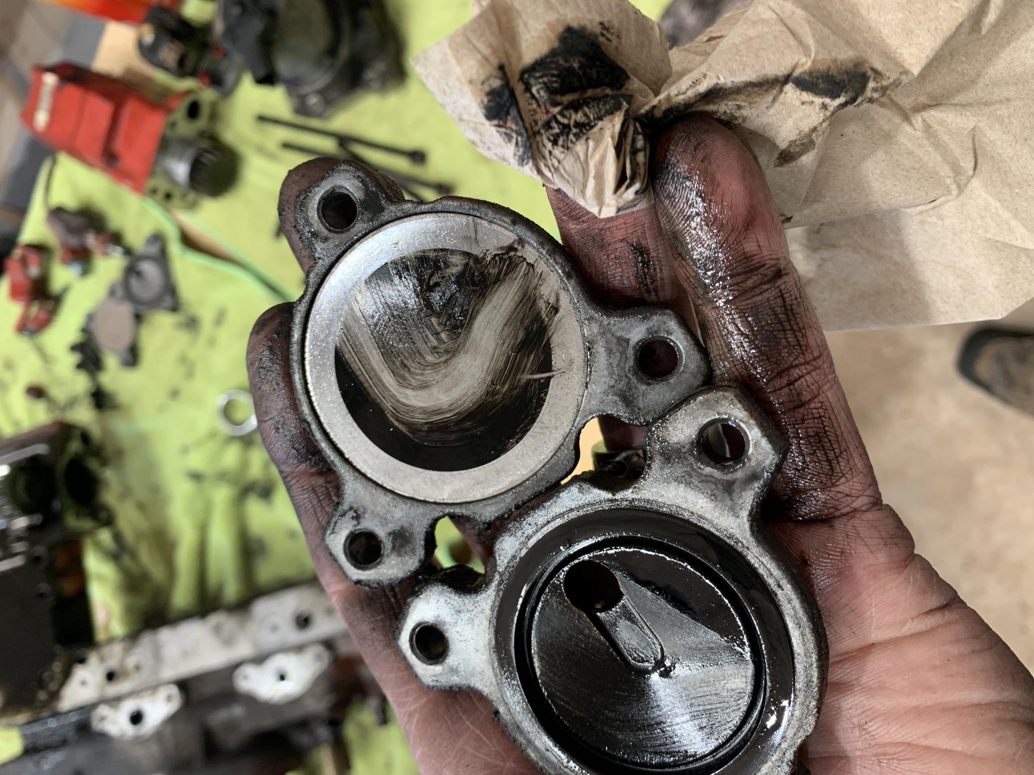

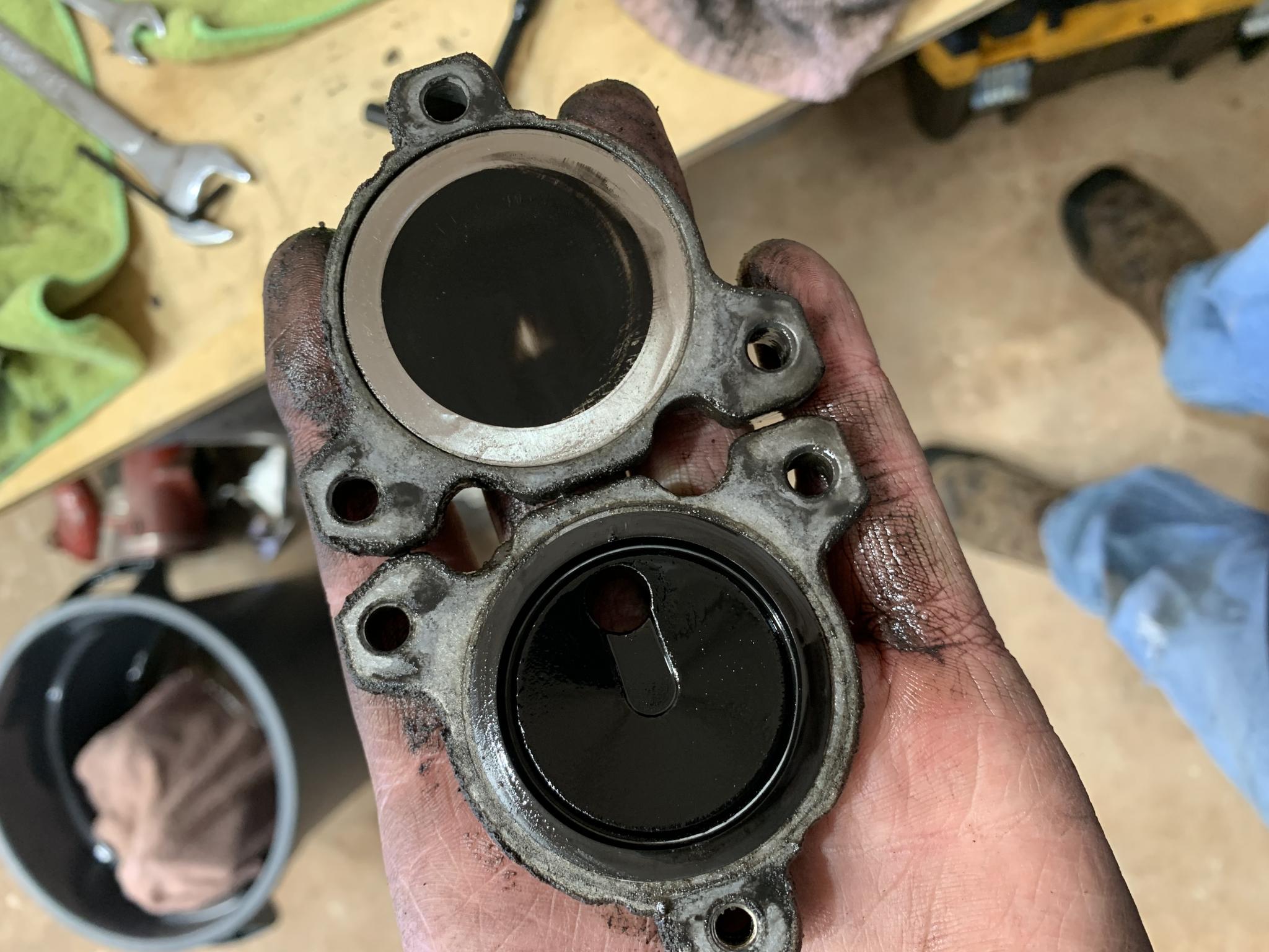

RE: CM871 poor power and fuel econ I put everything back together with the “new” fuel module housing and runs exactly the same. Redneck engineered one of the leak down test plates and found that both front and rear banks are blowing bubbles. Going to work on figuring out which injectors are bad tomorrow. BTW, if you need a test plate in a pinch you can take the base plate off an actuator and a McDonald’s straw fits very tightly through the top hole if you fold the tip and run it through then pull it tight with a pair of pliers and clip the excess off. A 1/4” piece of clear plastic hose fits tight over the straw (had to flare the end a bit to get it started) and whalla!! Redneckerized test plate!! {I can talk about red necks cause I R one!! ;) lol! } | |||

RE: CM871 poor power and fuel econ (02-20-2022 )Grounded Pilot Wrote: It’s a piece of 1/8” aluminum. Fits the tube pretty perfectly in place of the gasket and is plenty heavy enough to do the job. You are absolutely wrong about that. I have seen it at least a dozen times already with people who use thin aluminum plates like that. It is not worth risking your whole engine on that type of assumption ... Maybe you fail to realize that as much as 90+ psi of pressure can potentially build up on the back side of that plate (depends on other circumstances). That plate is too damn thin. If it is made from steel, aluminum, galvanized, or anything less than 304-stainless then it eventually will corrode thru in a few years and the pieces of it will destroy the engine as it goes thru the intake valves and gets into the cylinders!... here is the correct solution for that spot on the engine... REF: http://rawze.com/forums/showthread.php?t...9#pid21629 User's Signature: ->: What I post is just my own thoughts and Opinions! --- I AM Full Of S__T!. | |||
