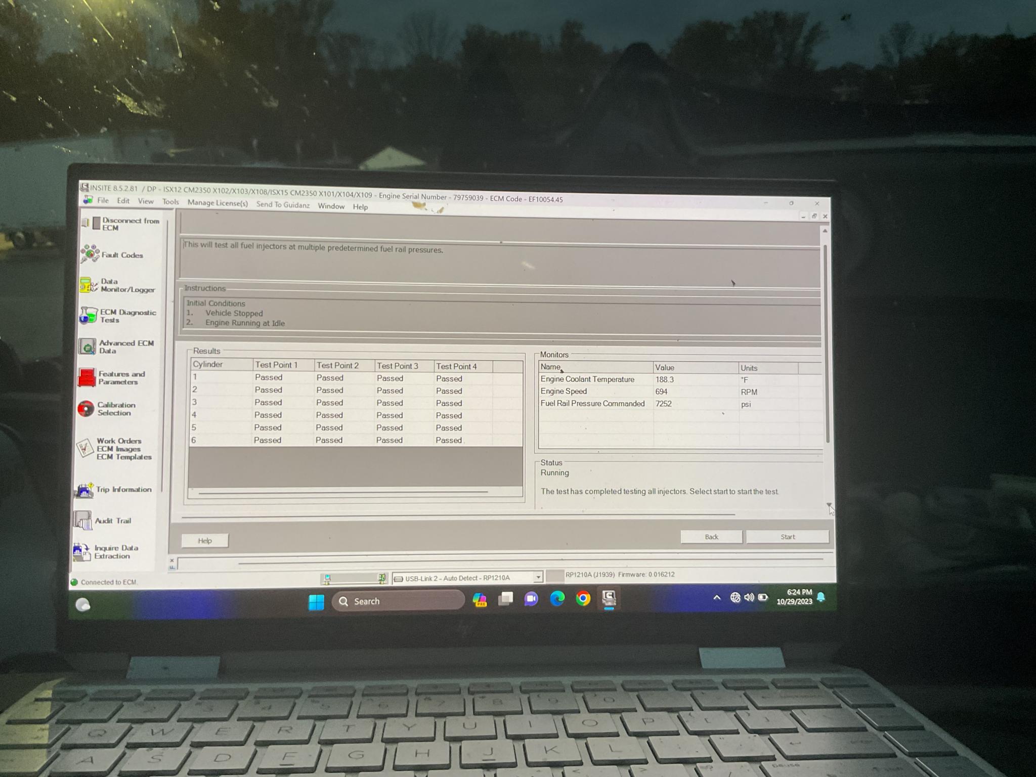

RE: Hello everyone I NEED SOME HELP. (10-29-2023 )Nhramember Wrote: Ok did injector cutout test and all passed. What’s next? YOU NEED TO DO THE TEST EXACTLY LIKE THE VIDEO SHOWS!!!... What is the leak rate in one minute???. What was the starting pressure.. and the ending pressure???. http://rawze.com/forums/showthread.php?t...3#pid75483 User's Signature: ->: What I post is just my own thoughts and Opinions! --- I AM Full Of S__T!. | |||

| RE: Hello everyone I NEED SOME HELP. It droooed 2900 psi in 1 min. It stated dropping fairly quickly as soon as I turned the key off. | |||

| RE: Hello everyone I NEED SOME HELP. I think Rawze has other steps he follows but the first thing I do when the rail pressure falls like that is cap off 3 injectors at the time. First the front bank and then the rear and do the test again to isolate which injector or injectors are leaky if any. If I don’t find any leaking then I change the pressure relief valve. Also you need to pull the head off of your pump and check or replace your plungers depending on mileage on your engine. User's Signature: You can’t buy love, but you can rent it for 3 minutes! | |||

RE: Hello everyone I NEED SOME HELP. (10-30-2023 )Bengy88 Wrote: I think Rawze has other steps he follows but the first thing I do when the rail pressure falls like that is cap off 3 injectors at the time. First the front bank and then the rear and do the test again to isolate which injector or injectors are leaky if any. If I don’t find any leaking then I change the pressure relief valve. Also you need to pull the head off of your pump and check or replace your plungers depending on mileage on your engine. This didn’t start happening till I put biodiesel in . I ran the injector test but I did have code 2343 and 559 at the same time . You asked me that before. I also ran injector test all passed. Thanks nate | |||

| RE: Hello everyone I NEED SOME HELP. Ok I replaced the high pressure relief valve and it came back. I’m still trying to figure it out. Any ideas . Same code 2343 is coming back. | |||
