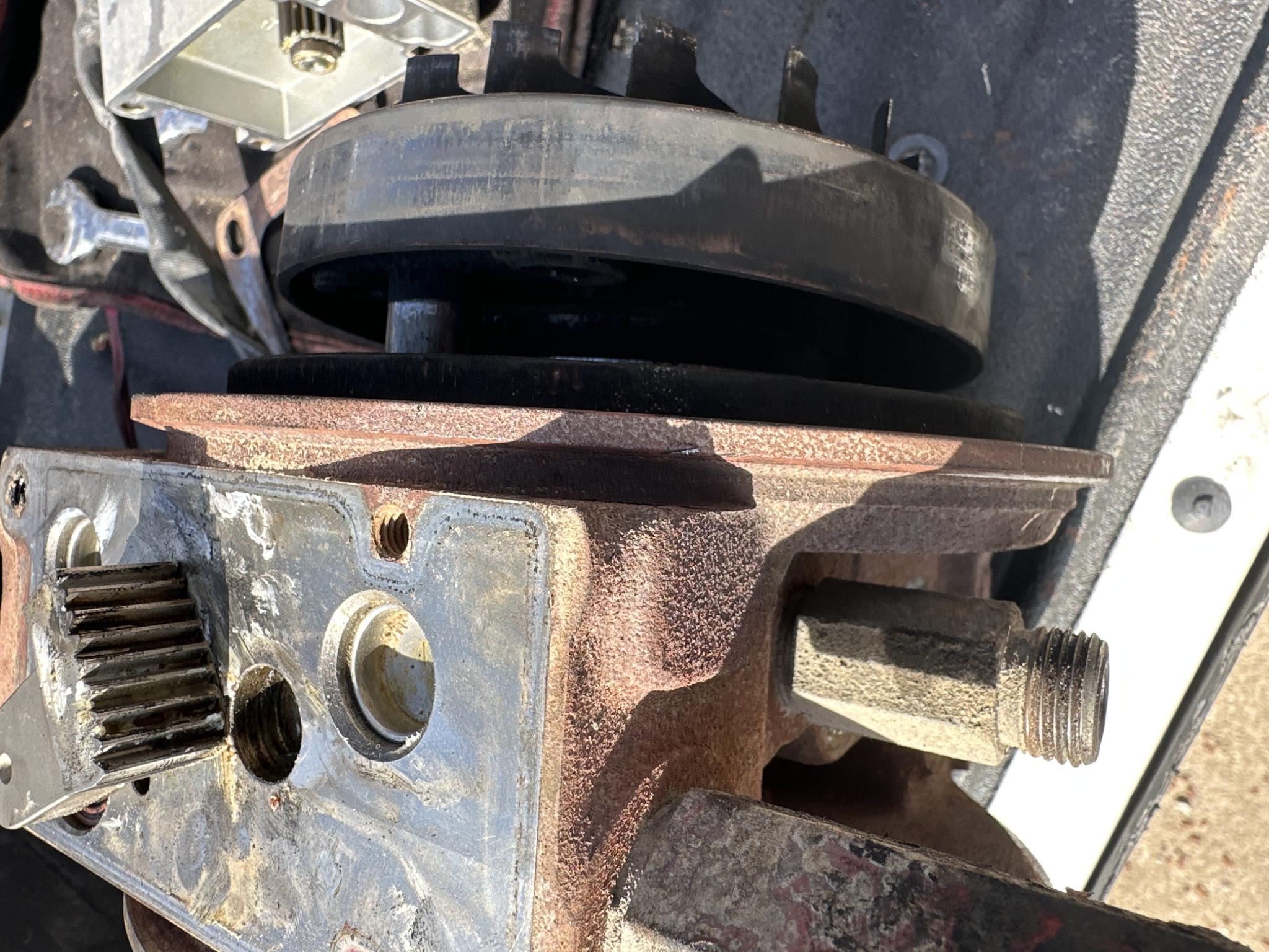

| RE: 2350 excessive smoke poor mileage and poor performance Figured out my bet issue. It broke on one side where it attaches to the arm | |||
| 02-29-2024, (Subject: 2350 excessive smoke poor mileage and poor performance ) Post: #9 | |||
| RE: 2350 excessive smoke poor mileage and poor performance wow that thing looks really worn out and a lot of age on it. User's Signature: ->: What I post is just my own thoughts and Opinions! --- I AM Full Of S__T!. | |||
