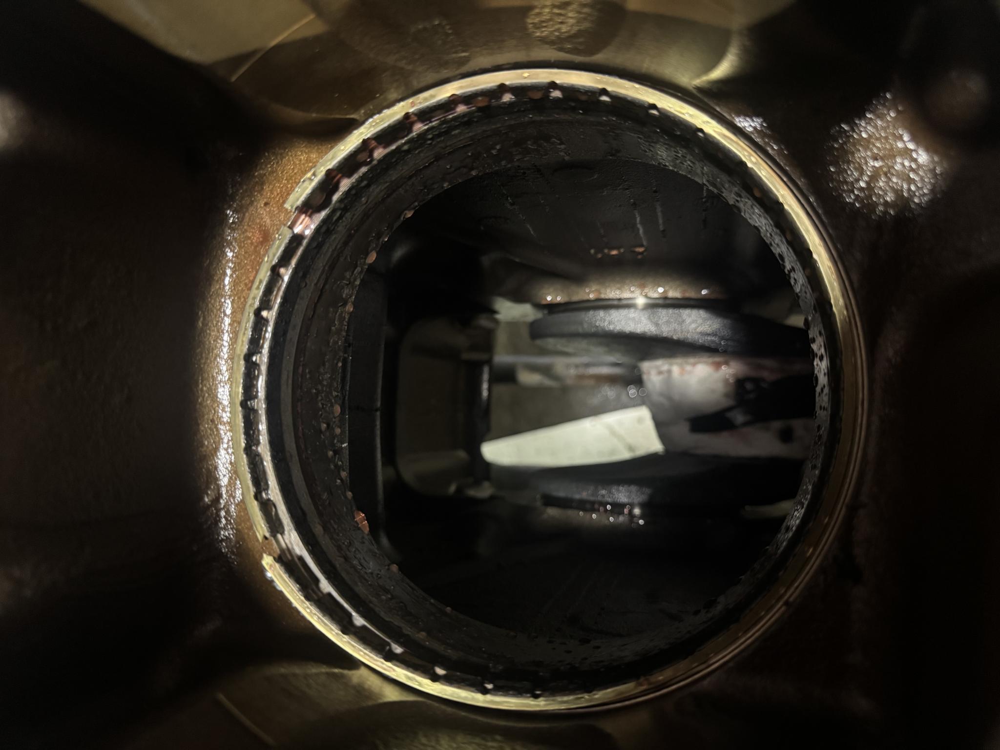

| 05-21-2025, (Subject: 2013 ISX 15 rapid sudden coolant consumption ) Post: #8 | |||

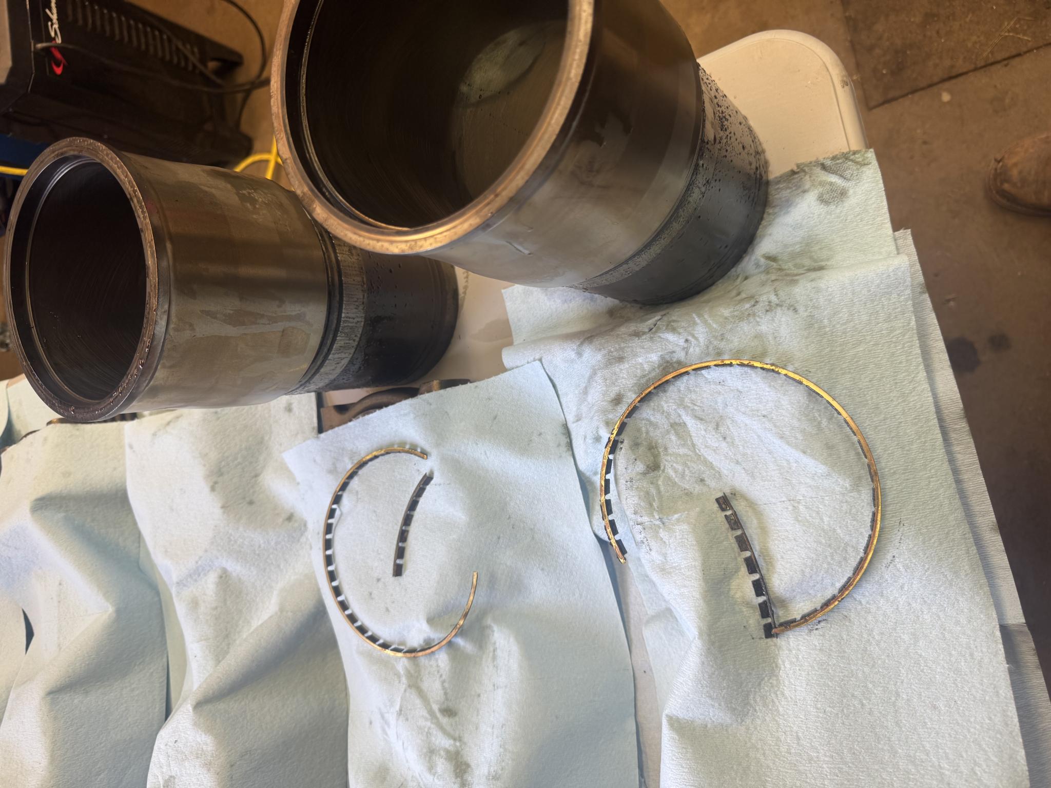

| 05-22-2025, (Subject: 2013 ISX 15 rapid sudden coolant consumption ) Post: #9 | |||
| RE: 2013 ISX 15 rapid sudden coolant consumption Here is #1 and #2 liner they both had 0.032 im guessing oem brass shims. When they were removed both shims were broken. Im guessing this block was never counterbored. Im getting a measurement of 4.688 with a regular depth micrometer, i need to be at 4.752 with a 0.032 shim. That is just using the one that comes with the new liners correct? | |||
