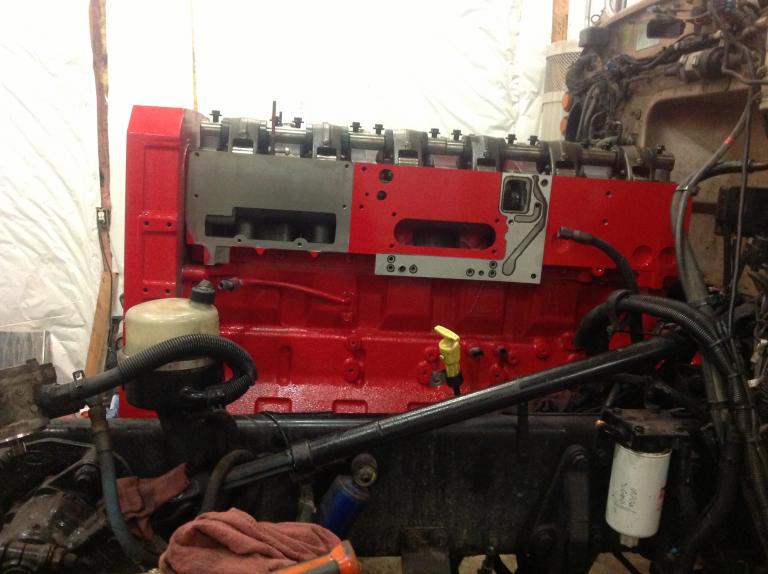

RE: Cm870 upgrades (01-22-2017 )Hammerhead Wrote:(01-22-2017 )Nilao Wrote: Mine were brittle when I took them out for my Inframe at 620k miles and one broke where the nozzle met the plastic. It'd be too easy to crack one during the re-installation and have it fall apart. Then where would you be thinking all was good. Unfortunately there's no simple solution. Clear today, plugged tomorrow. On a good note, it was running fine till it got tore down, even with a plugged up jet. Front cover was leakin pretty bad, owner decided to do the whole thing while he had a spare truck. It's on the flip side now though. | |||
