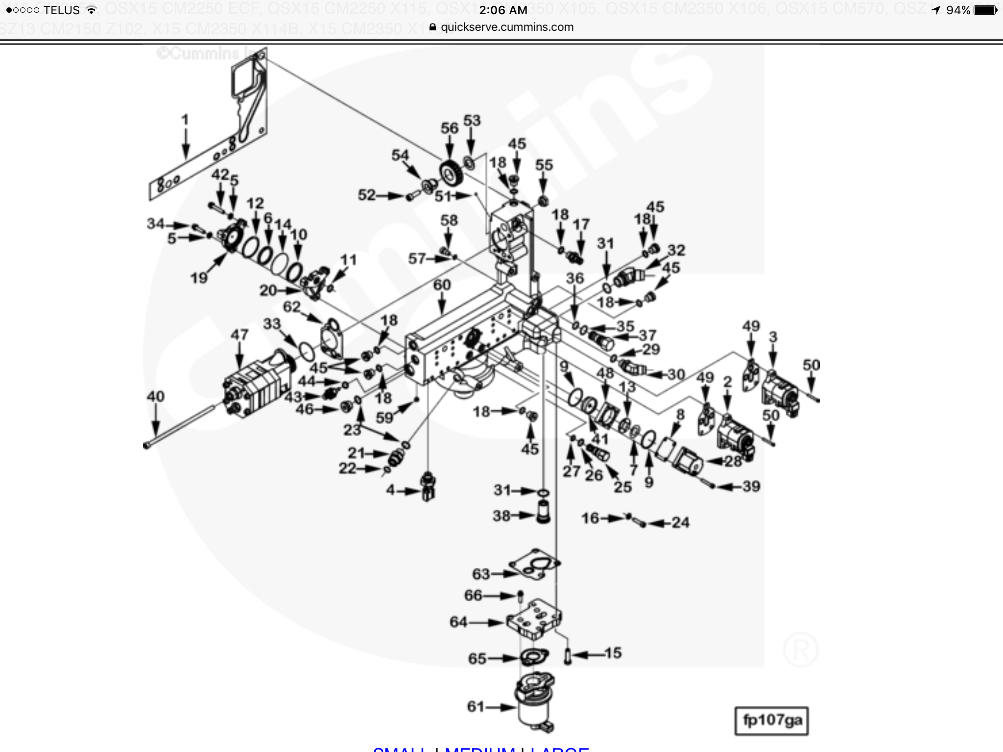

The two pressure regulators, can't remember the exact numbers but I think it's a 260 & 380 psi regulator, as well as the oriface for the timing relief I think.
I'll try and find it for you...
Post number 7 of this thread http://rawze.com/forums/showthread.php?t...3#pid12033
The pressure regulators are #'s 25 & 37. The oriface is under plug #59 I believe. He told me he uses a mirror & a pick for the oriface.
Quickserve->Parts->Fuel System->Delivery System->Fuel Pump drawing # fp107ga
In service, under the IFSM drawing # 05c00201 shows it much less cluttered, but not numbered for a better reference.
