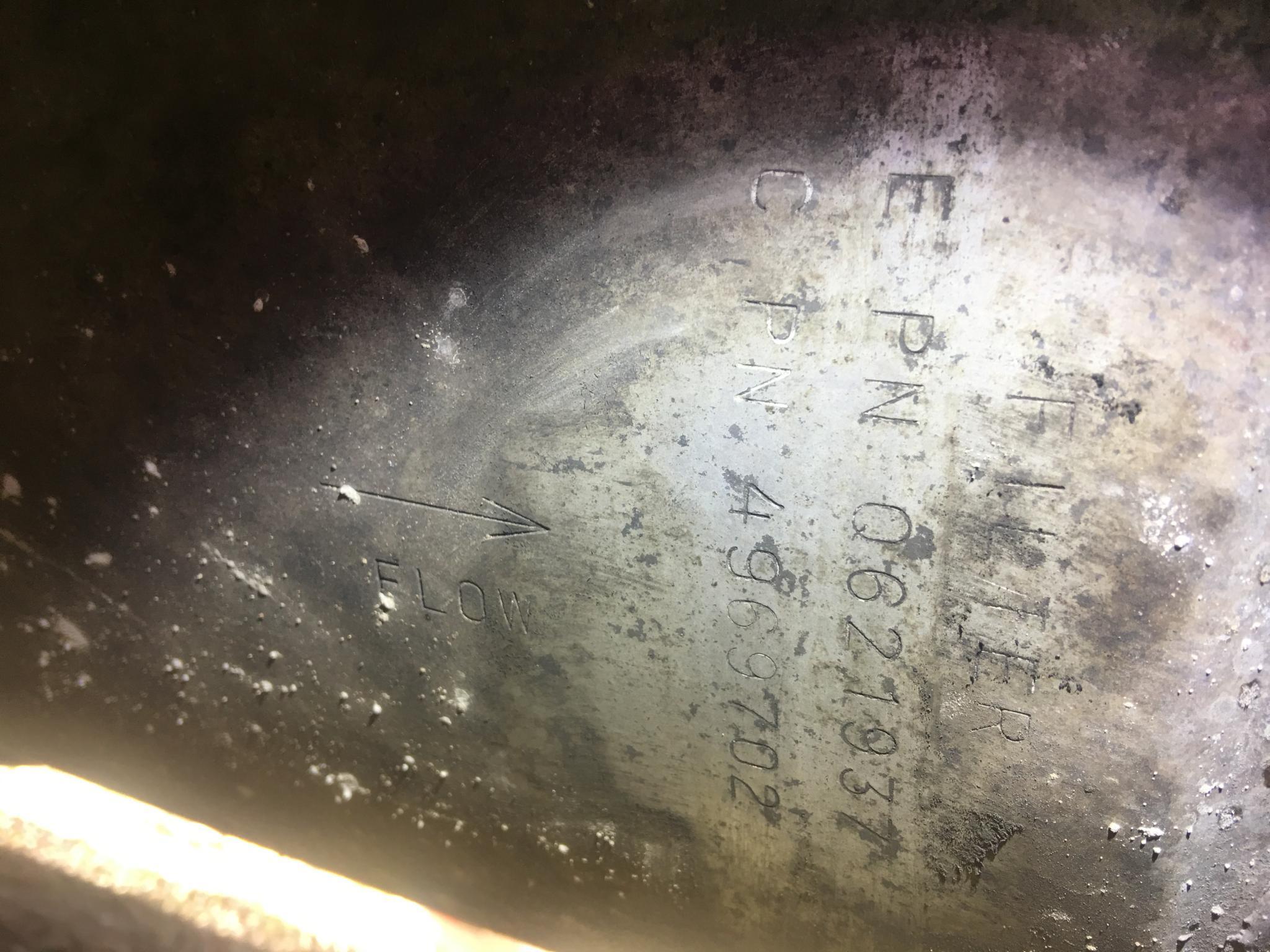

The part number on the side of the can shows 4969702.

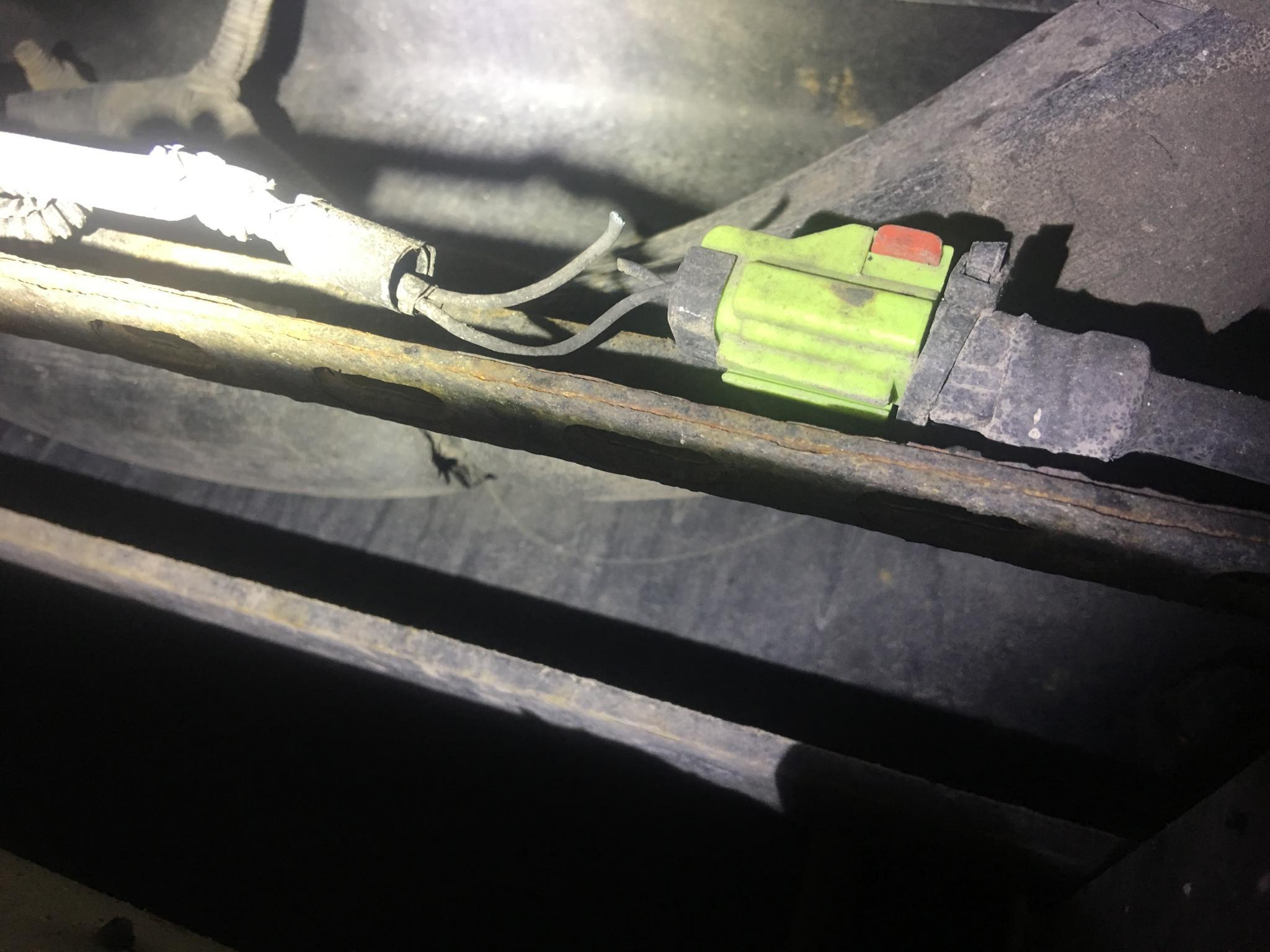

Also found a broken or cut wire that goes to the rear temp sensor of the DPF....

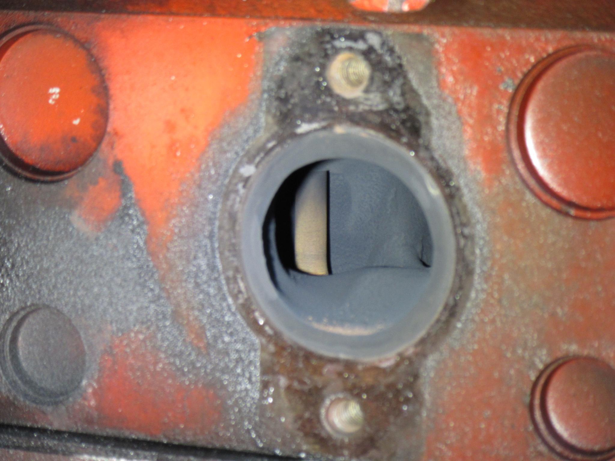

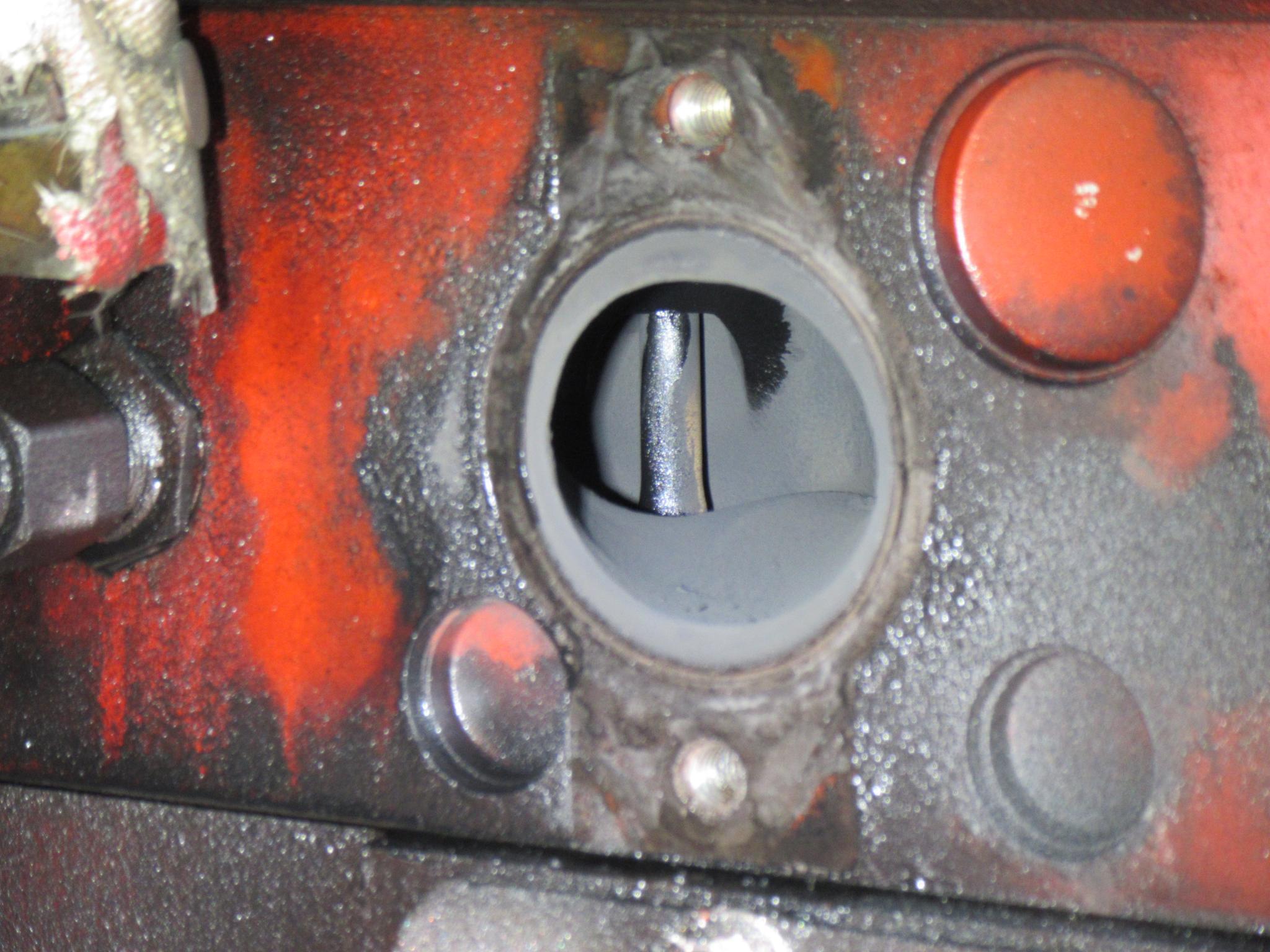

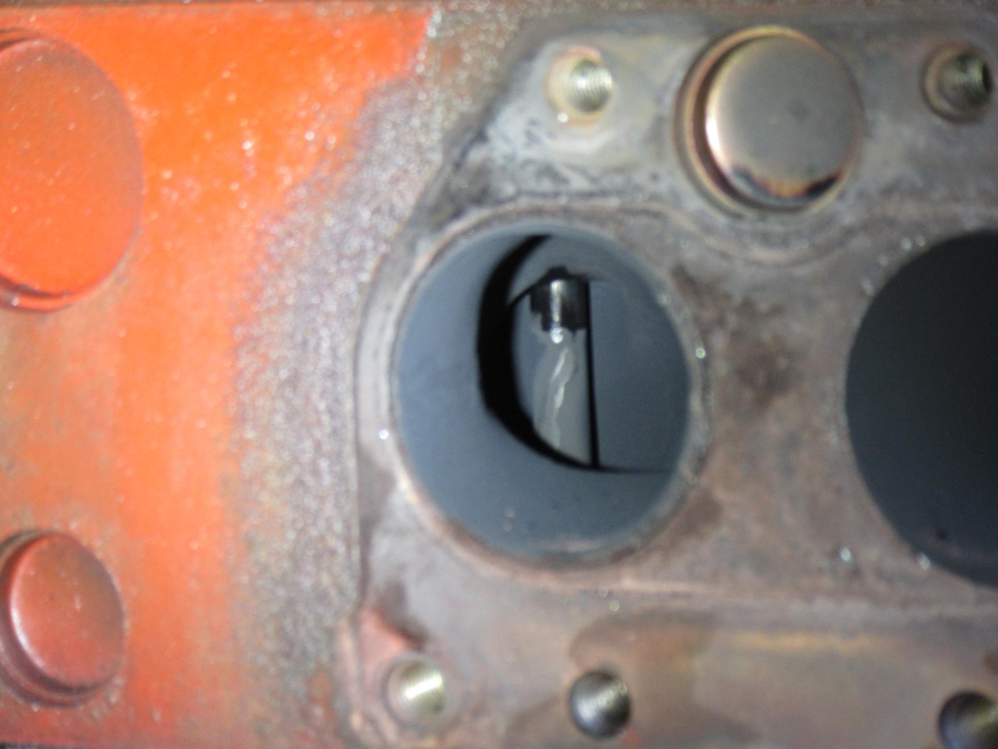

But then after I stopped that leak, I noticed more along the head gasket and exhaust manifold. Not sure if it was just run off from the hose I tightened because I did let it drip for a while. So I pulled the turbo and exhaust manifold off to check the exhaust valves for any oil running down them.
I may have found my smoke problem.
