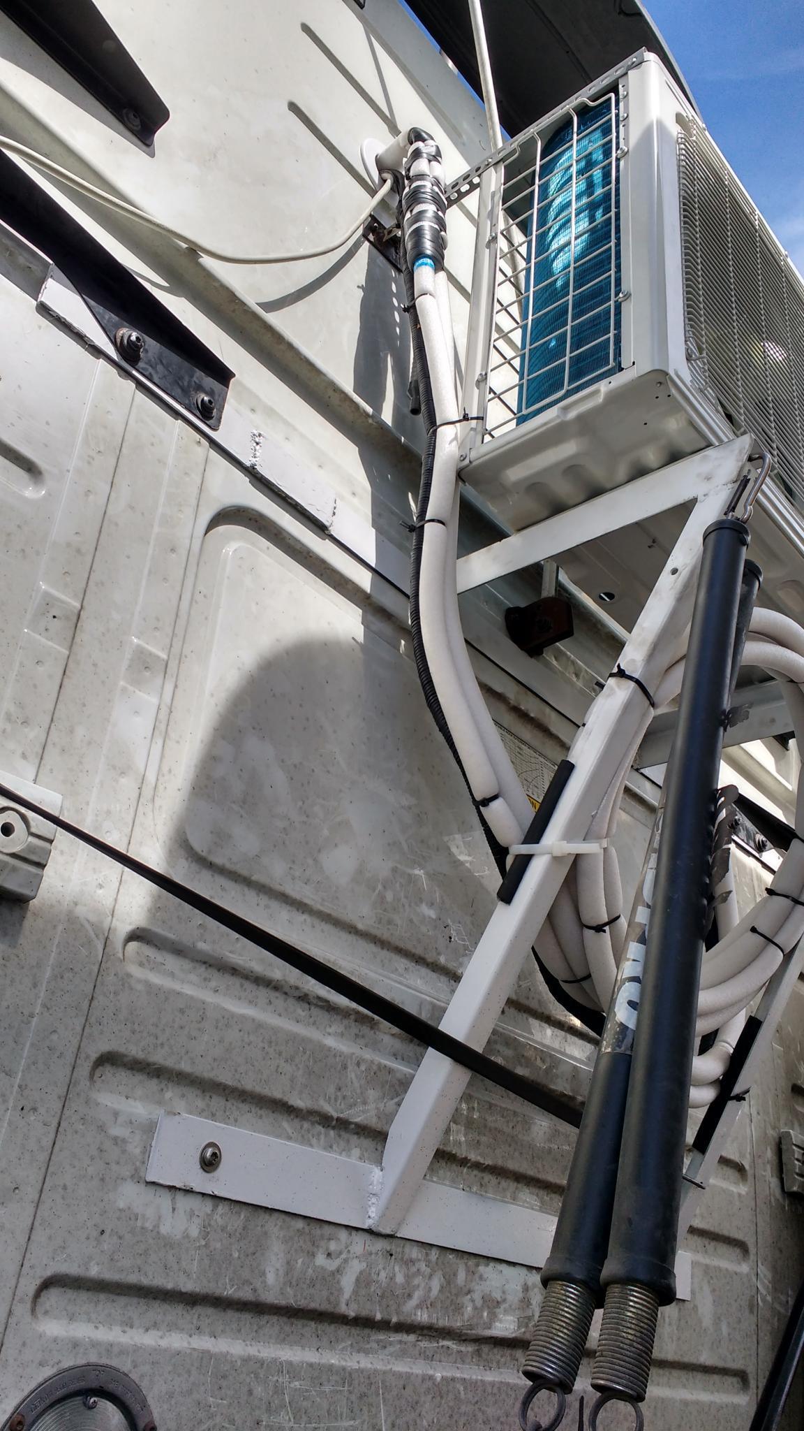

(04-16-2017 )simon999 Wrote:  Snailexpress did you connected it to your fuel tanks? Does it has fuel pump or you use some electric fuel pump?
Generator is connected to the fuel tank. It has a electric fuel pump for prime same as we have on truck engine.
That is impressive to me! How many holes did you drill? Or was there holes to drill? Im sure those tubes had to be feed in some how...
You have to drill only one hole to slide tubes and wire inside the cab. About 2 inches in diameter.
