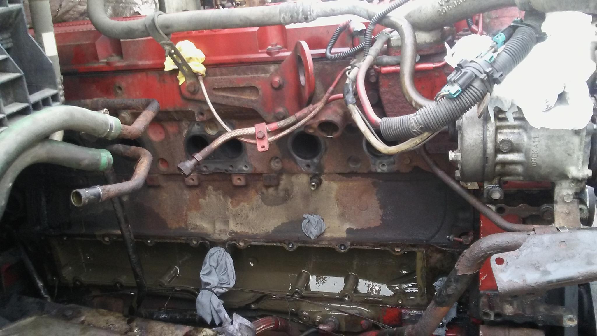

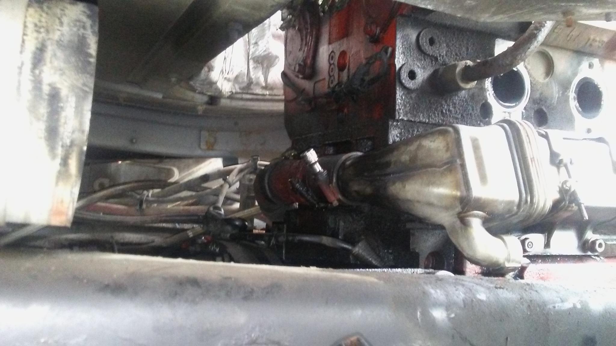

| RE: bad oil cooler have cm 870, removed all parts today, there was no access/ or limited access to top screws of egr cooler so had to remove exhaust manifold to remove egr cooler put most of screws into diesel overnight was thinking about oil (give advices for next repair) have most of parts for reassembly tomorrow will do some more pictures so it might be helpful for others will use anti-seize compound on exhaust manifold and turbo-manifold screws please let me know if you have any thoughts regarding assembly | |||
