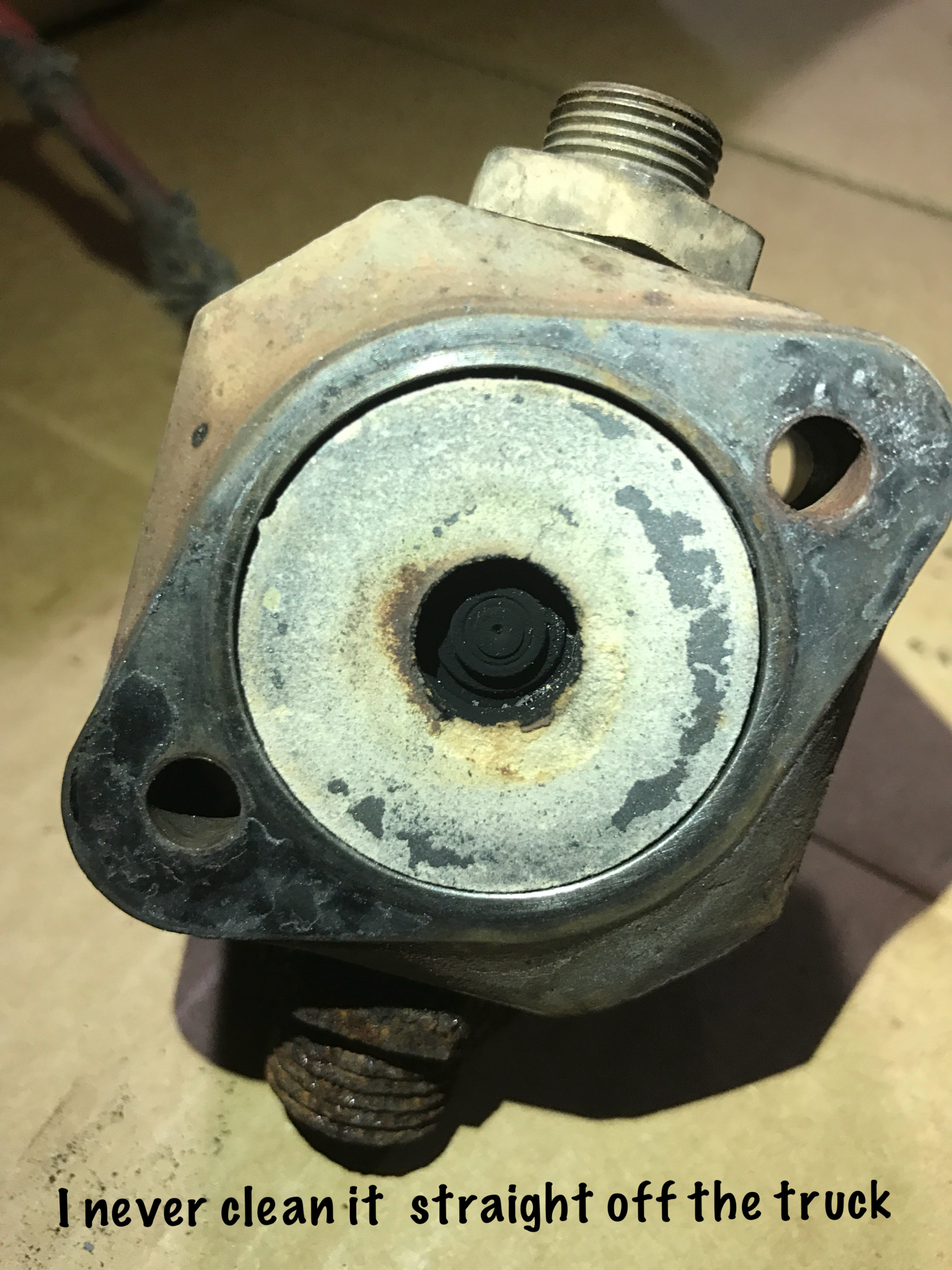

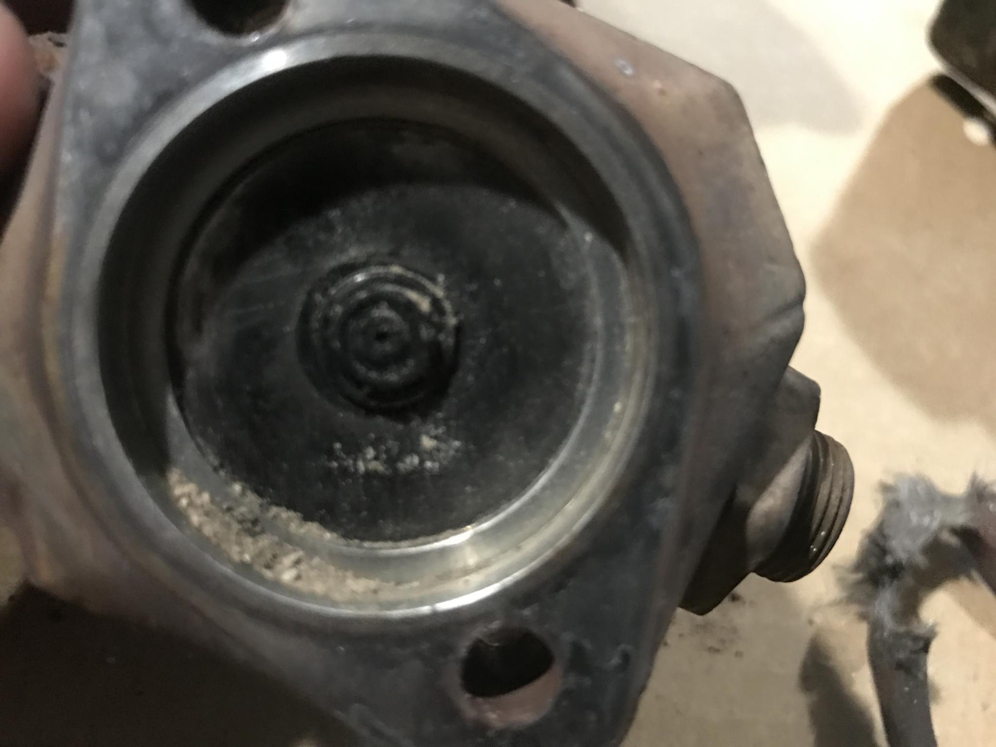

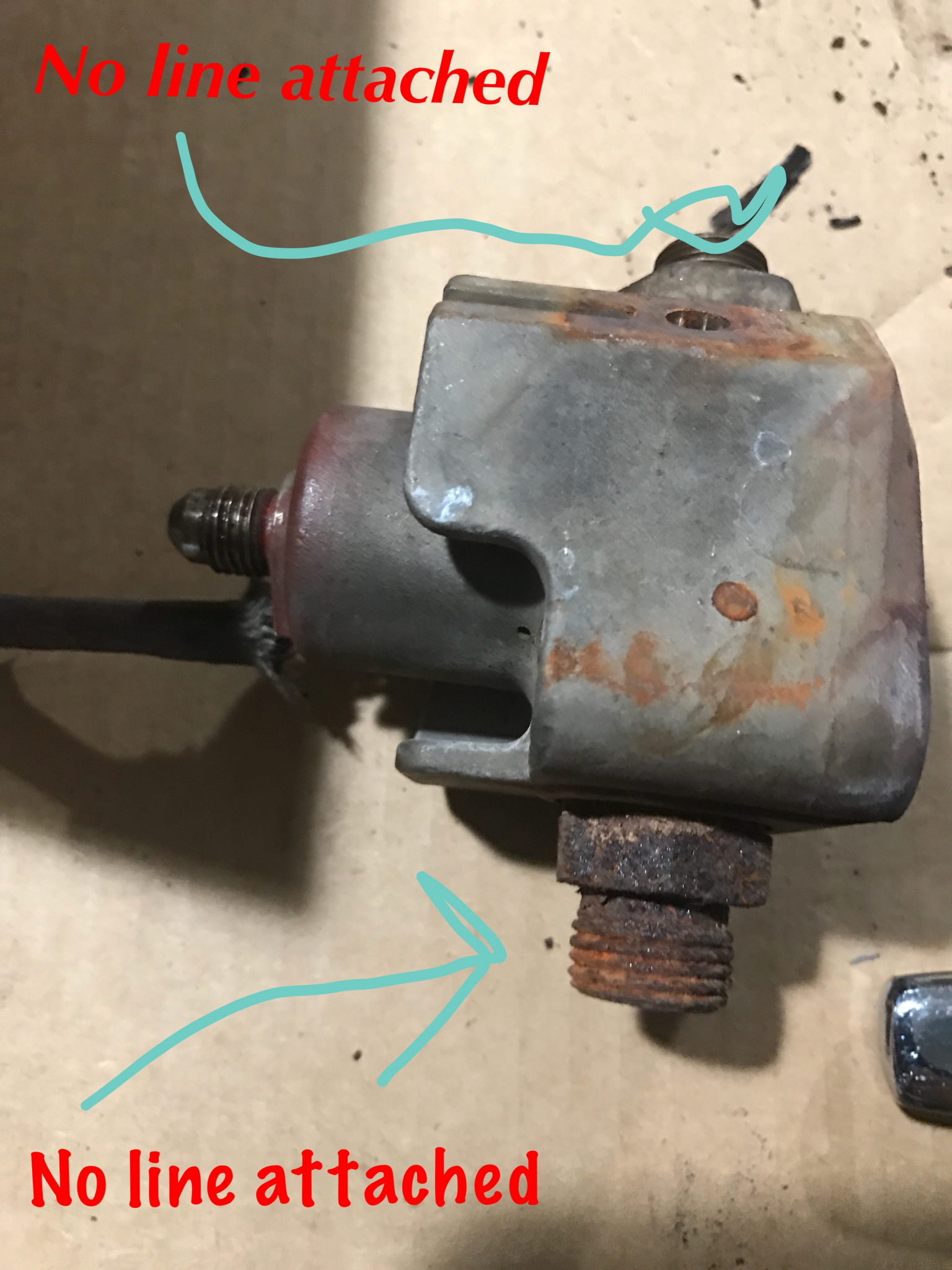

I pull off the doser, the only two things connected was the power and fuel line, should I replace the doser, I have a brand new one but it seems to me its not even connected.
