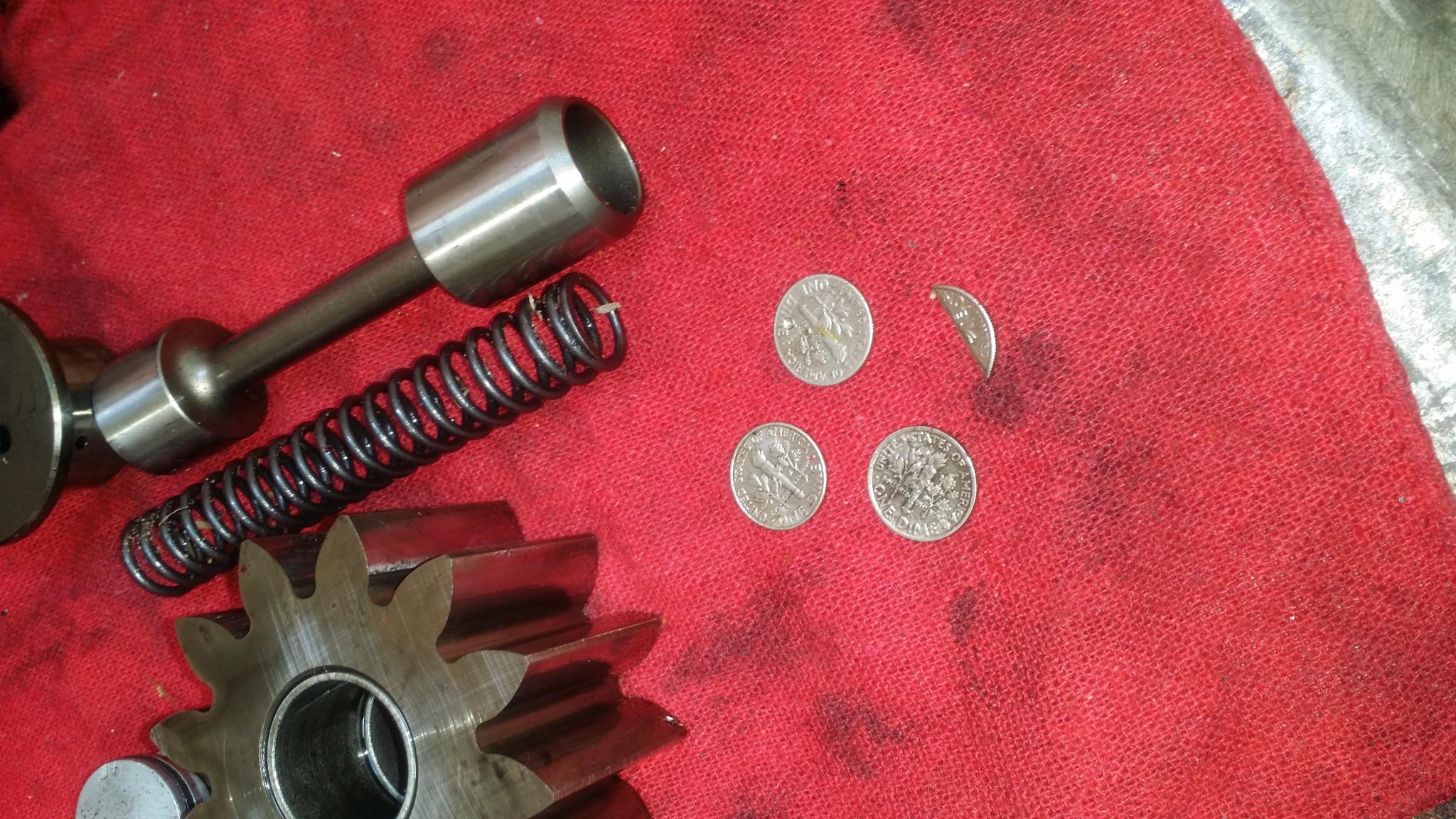

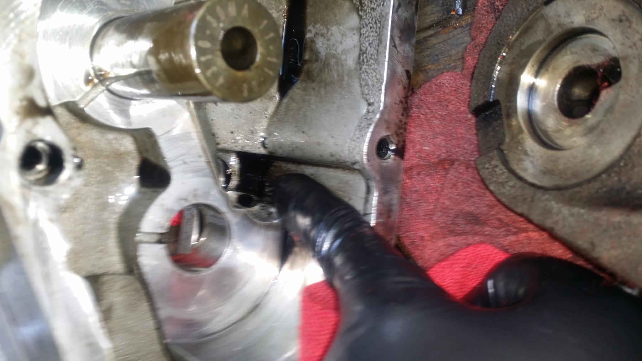

Well I'll NEVER EVER put dimes in the regulator again. Five in 3 out. Small piece came out from internals of pump. Gears turning fine.
0 psi pressure. Wanna guess where the other 1 3/4 are? I sure would like to know! Hopefully in the rifle before the oil thermostat. Probably where the blockage is. Those dimes can turn right at the passage in the second pic if you aren't careful.
