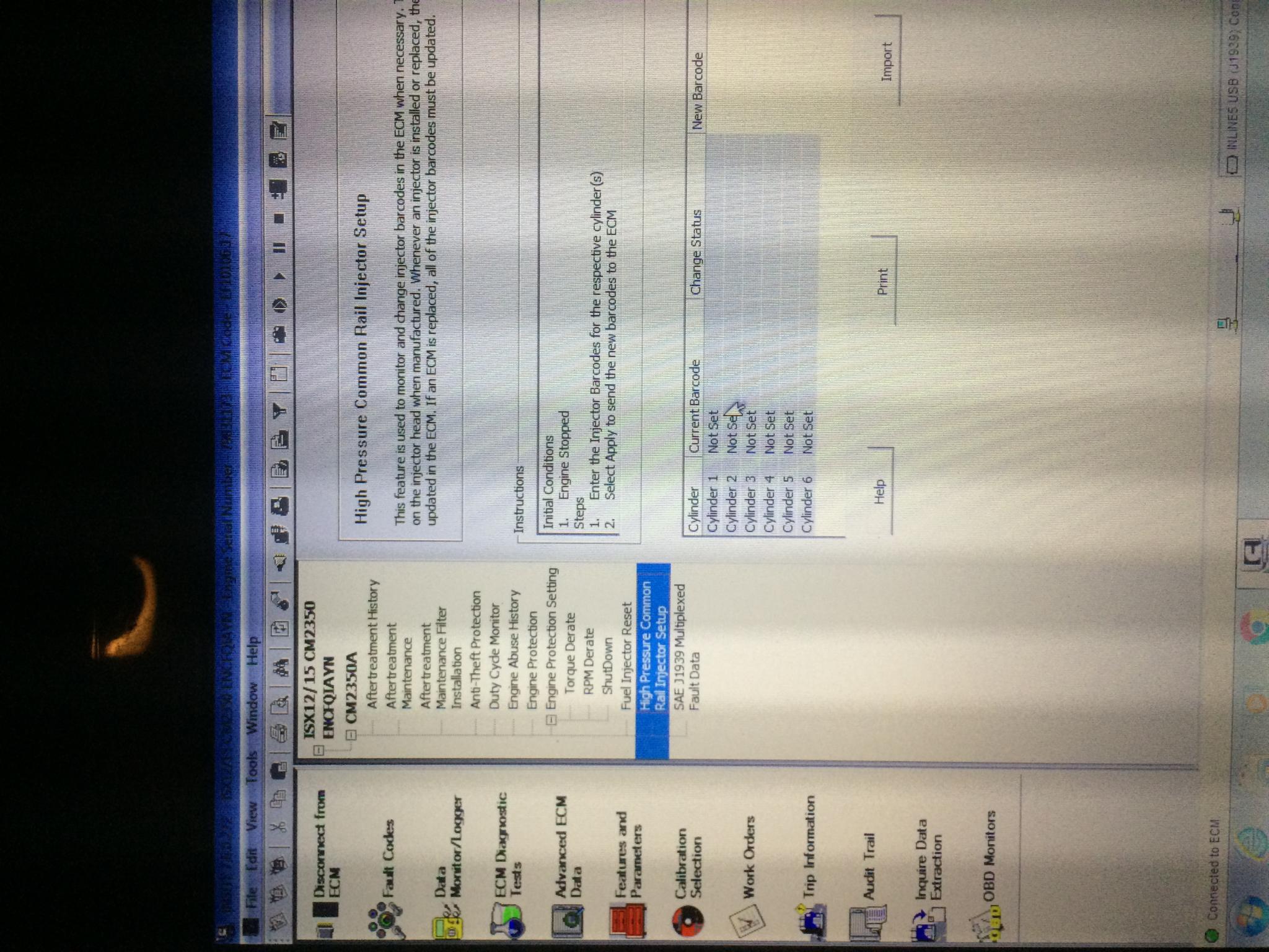

(11-25-2018 )indian_richard Wrote:  Ok good to know. I did not do that. Can that be accomplished by using Insite? What kind of concequences will I suffer from not changing the code in the ecm?
Yes you need to run Insite and need to know the code from injector. In sectoin Advanced ECM Data click on High Pressure Common Rail Setup, and change the code on injector#6.
The bar code is telling ECM ijector flow and timing characteristics to maintain proper fuel/air mix. Wrong code might lead to really bad consequence but might not. Depends how two injectors characteristics are different. Change it ASAP.
So I looked in my eyes and I noticed that none of my injectors have barcodes. Almost like someone reset all of them and left it.
