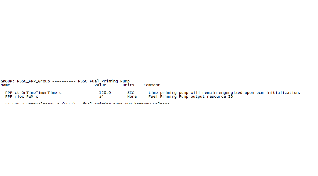

RE: Lift pump? (01-27-2019 )Moose Wrote: It will run and still not make pressure. It should only run for 30 secs key on engine off. You need to check the PSI at the compuchecks to see if it's doing what it's supposed to. Just for reference, a CM870 and Cm871 engine, it should run for 2 minutes (not 30 seconds) when the ignition key is turned on. User's Signature: ->: What I post is just my own thoughts and Opinions! --- I AM Full Of S__T!. | |||
