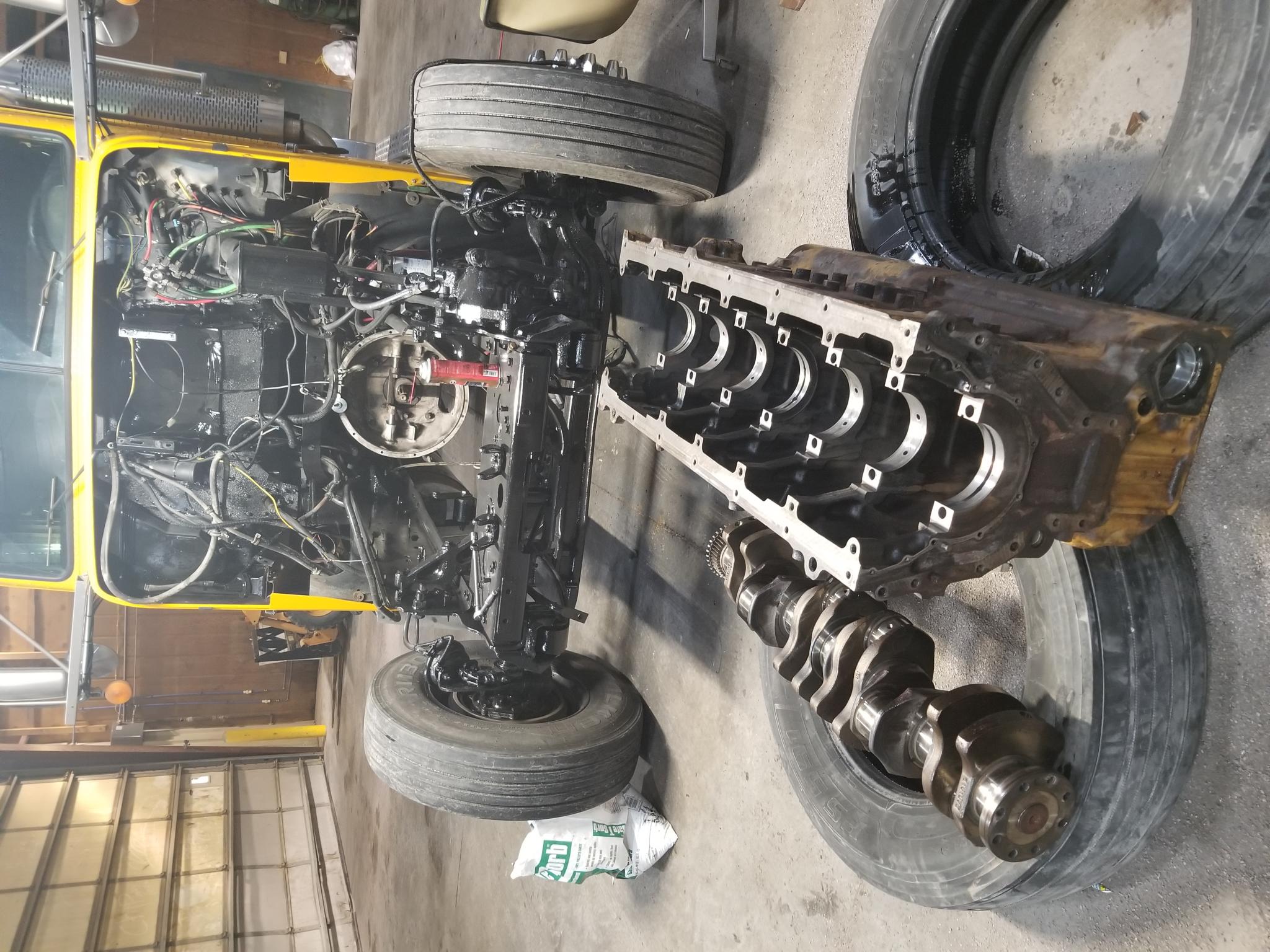

I am taking to a machine shop that cat takes there stuff to in the morning. Guy at machine shop said same thing, said sounds like it has foward pressure.
There going to check line bore etc etc, going to take the head in to see if it's rebuildable. It needs new cam bearings anyways. And a cam and cam followers lol it doesn't end. Everything in and on the motor will be replaced.
I get the planning for a overhaul. But in my head I feel like I'm half assing it if I don't get new /rebuilt everything. I guess I can advertise it as pre eld truck and ask 100k for it. Lol jk I'm never going to sell it now.
But the cat platitum kit is still almost the better deal, as it comes with injectors etc.
Hopefully the block is good.
Anyone know of a good place to buy a engine stand that's not 5k? I got everything cleaned up but my old tire engine stand isn't going to cut it when it goes back together. Lol
