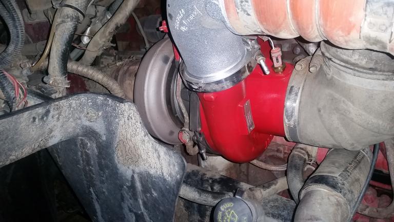

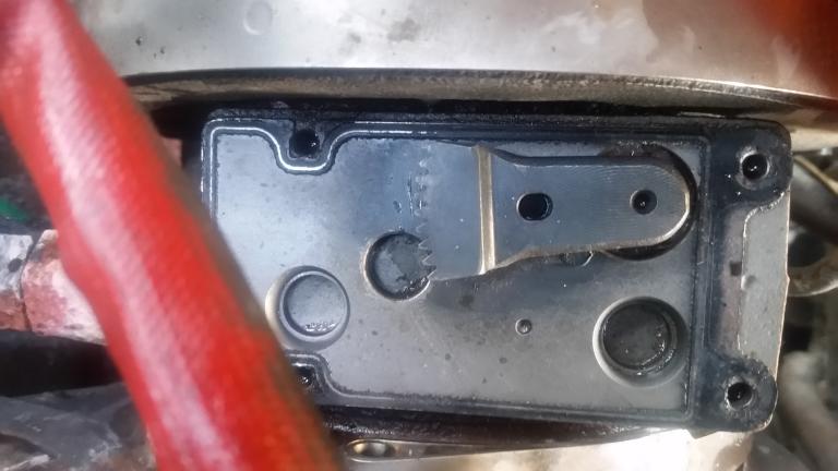

(06-27-2016 )Unilevers Wrote:  your turbo is toast - it is fine in the sub 50ish percentages but it cannot swing into the 75+ needed for jaking and proper regens and you have verified that the turbo arm does not have full travel. You are running on borrowed time and no amount of turbo calibrations is going to fix this - it is very common for those turbo's to do this. if you had the mandate removed it wouldn't be a issue as the turbo almost never swings that high but it is needed with the systems functioning.
also driving around at 5 and higher on the differential pressure is extremely bad. you are destroying your engine from the inside out - food for thought.
Not that I haven't seen new parts br bad but it's a new turbo.
./uploads/201606/post_1367_1467041604_8a7f9a0666dcc129a88b1cccda83a173.jpg
the lever seems to have perfect full range of motion. it glides across real good and it doesn't feel like it hangs up, it feels like it hits a wall and clunks at either side.... it's just when it clunks all the way to the right, the hole is lined up perfectly at that point.
I know you can't see the hole in the pic but that's dead on lined up in that position.
Code is still coming up today so calibration didn't do anything.
./uploads/201606/post_1367_1467041639_3ec98bf95e64aaf8c9f659adfda04326.jpg
