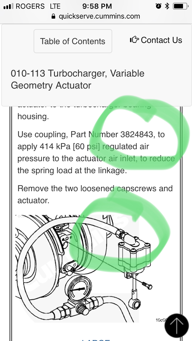

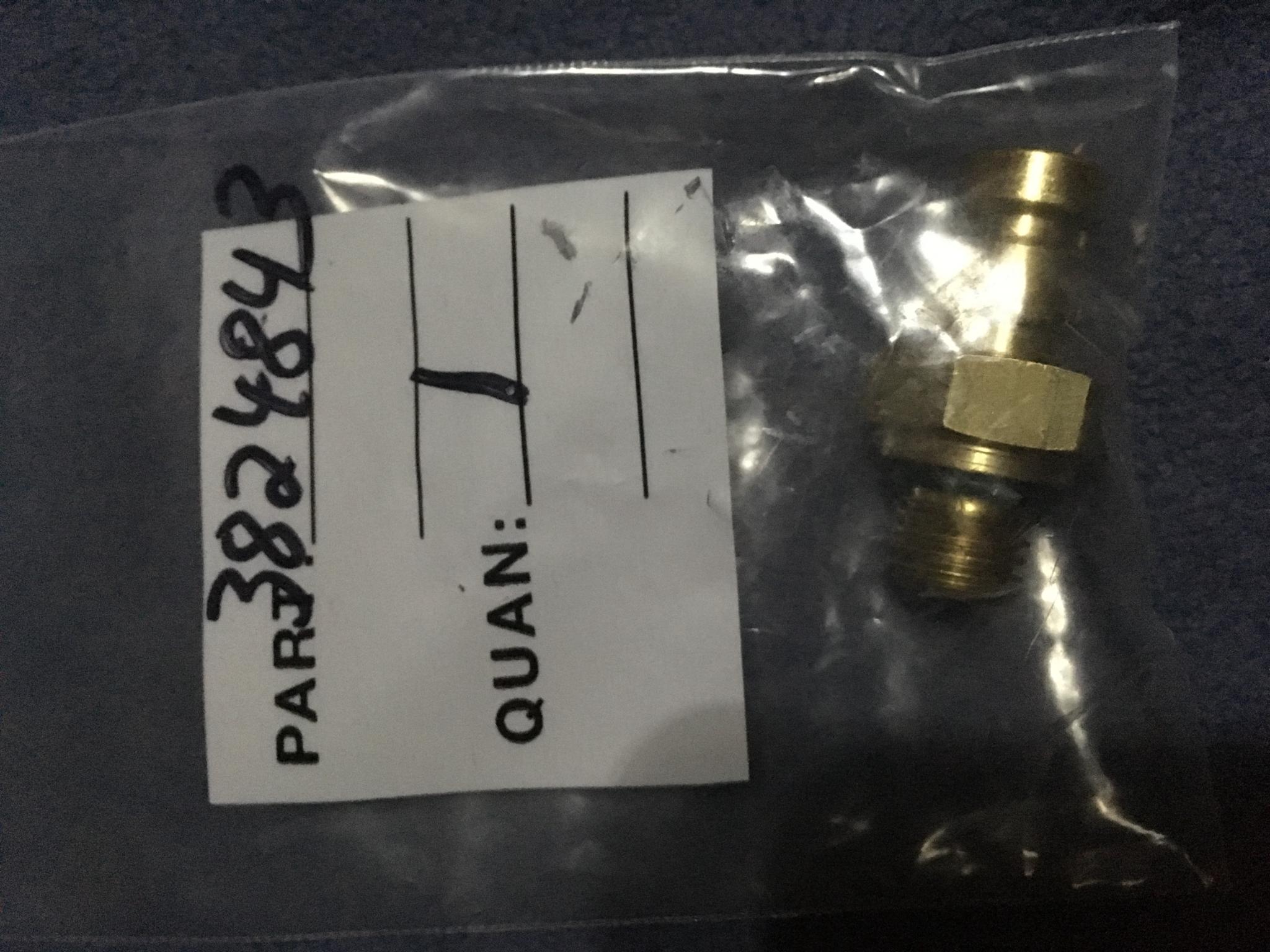

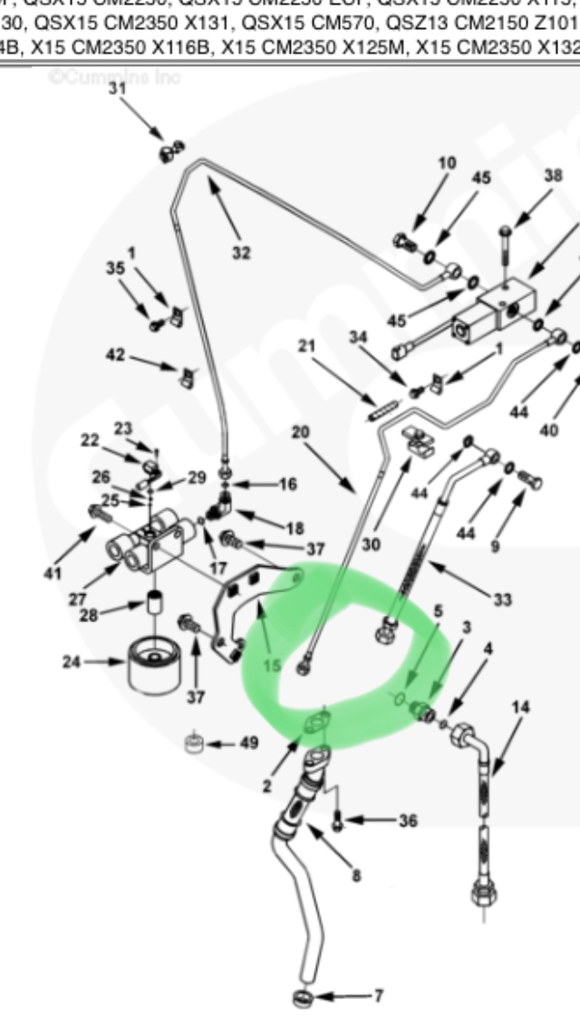

 RE: 06 CM870 450 ISX egr tuneup  ![]() ![]() I have a dumb question. Bear with me I’m on the road and am not gonna start taking things apart until I’m at the shop again. I was able to grab the fitting from Cummins in the USA, but it’s a male/male fitting. I picked up a female compucheck fitting while I was there, too. So...do I unscrew the fitting from the actuator...install this fitting to perform the stroke test? I went back and reread the instructions from Cummins on how to perform the test, but it’s not clear Then the next question, how do I pressure test the line between the actuator and the actuator controller? User's Signature: I have no idea what I’m doing and probably need supervising  |  |||
