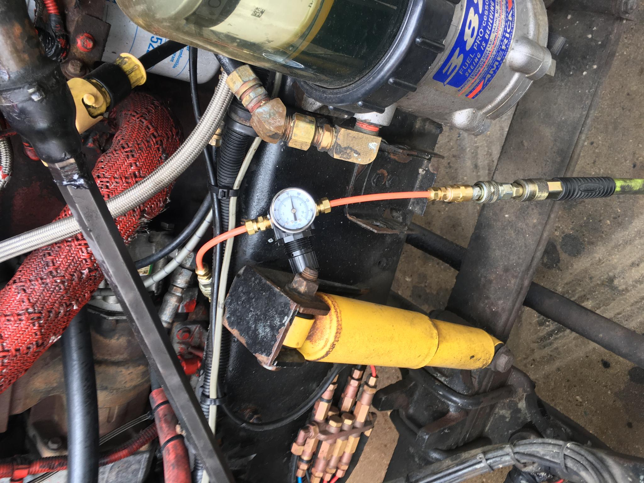

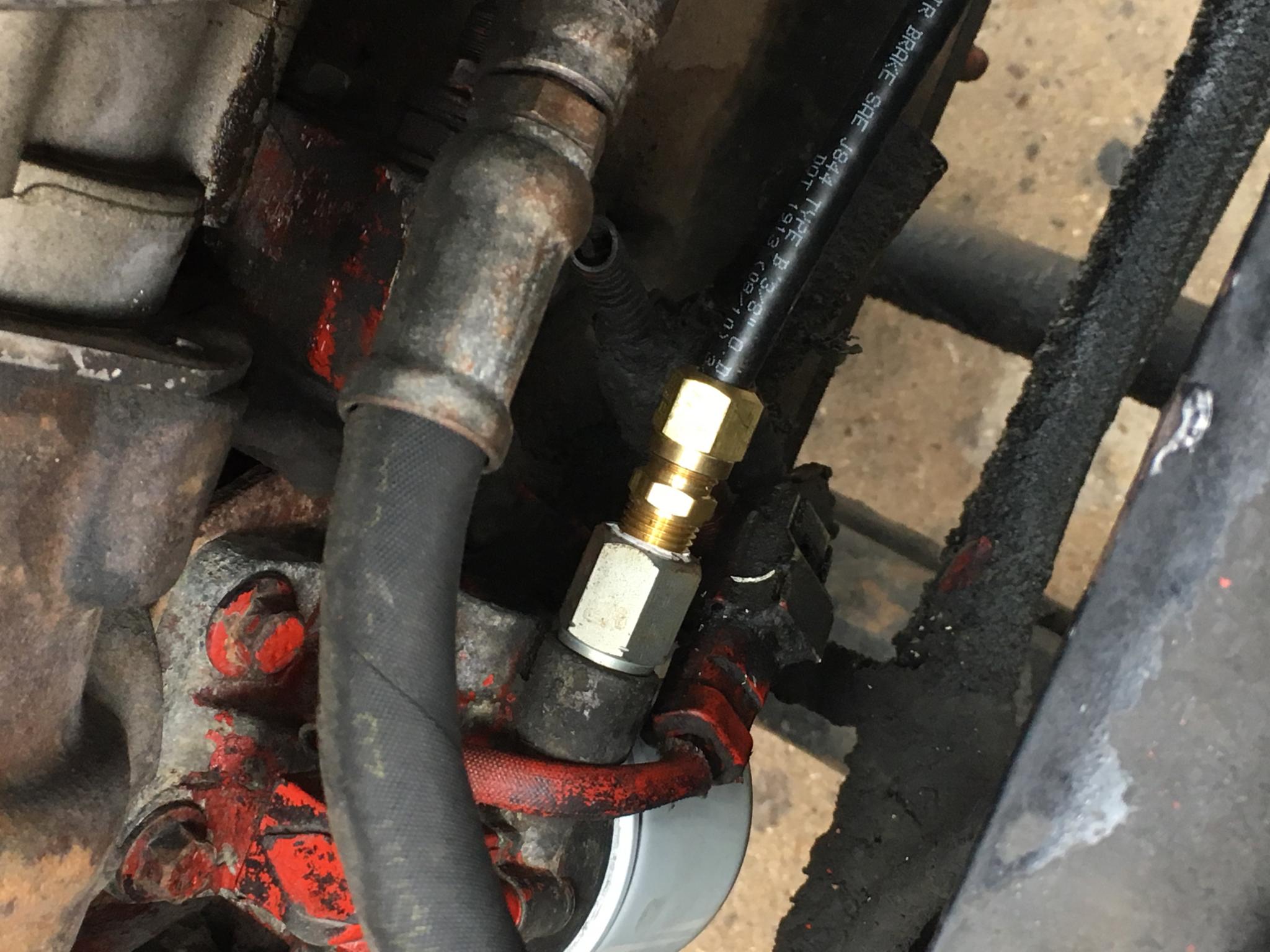

Fed regulated shop air to the system. The only leak was that fitting. Added a regulator, cut out the 1/4” line, new 3/8” line to a new fitting.

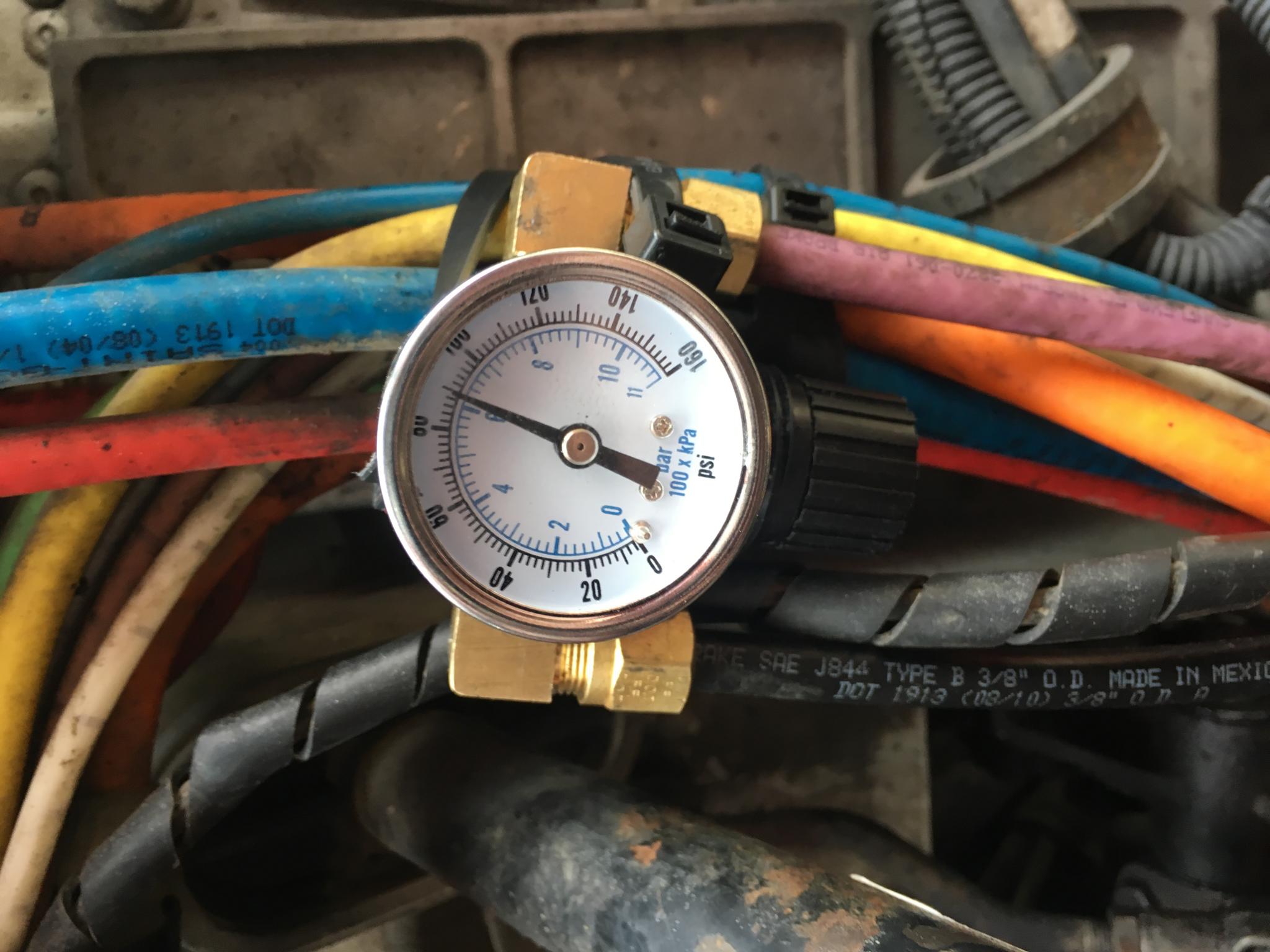

The trucks been shut off for around 5 minutes and the gauge still hasn’t moved. It’s a little crude but it’ll work for now I think
