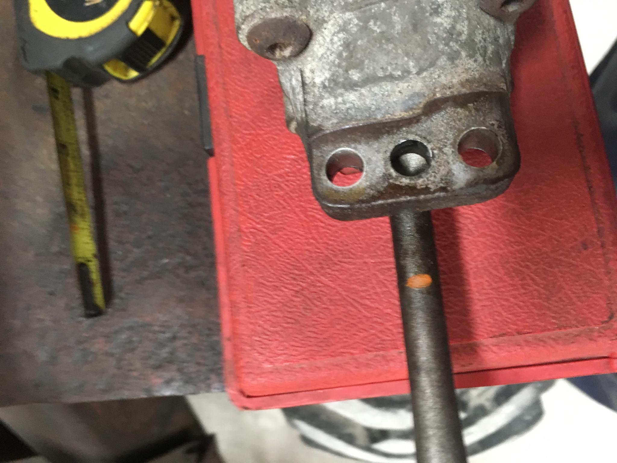

RE: 06 CM870 450 ISX egr tuneup (09-29-2019 )Chamberpains Wrote: What does the the travel of the arm on the VG ring measure. Is it free moving with a slight high pitch metal screech to it (normal)? Does the shaft move up and down at all (signs of wear) I have roughly 1/2” of travel. Using a mark and a tape measure. Using a blow gun to feed it air the dial indicator spun too fast for me to count the times it went past 0 The arm on the turbo, you’re asking how far did it travel? It seemed to travel the same distance with the actuator on or off, moving it by hand That’s probably not precise enough to give you the answers to what you were asking me User's Signature: I have no idea what I’m doing and probably need supervising | |||
