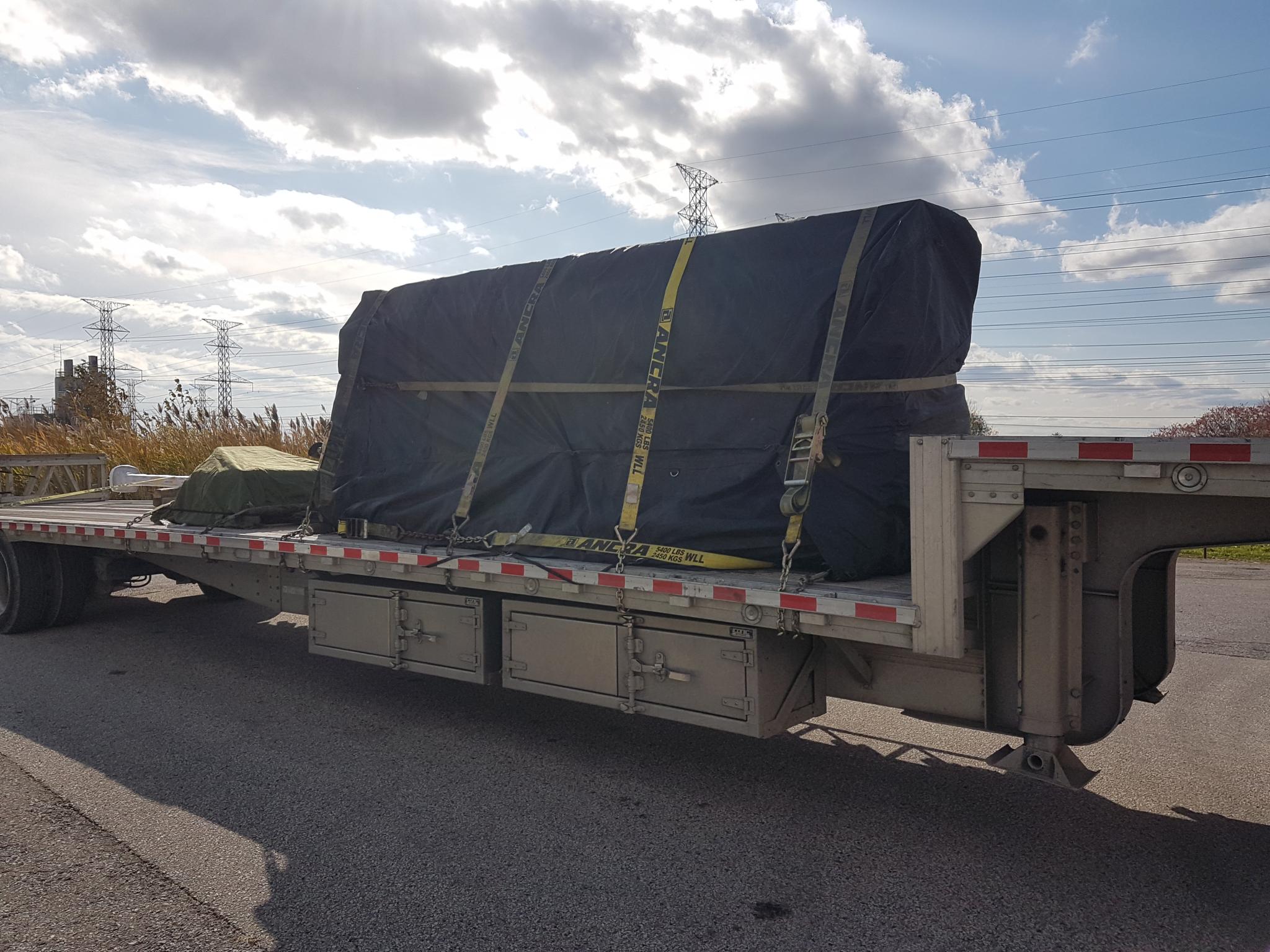

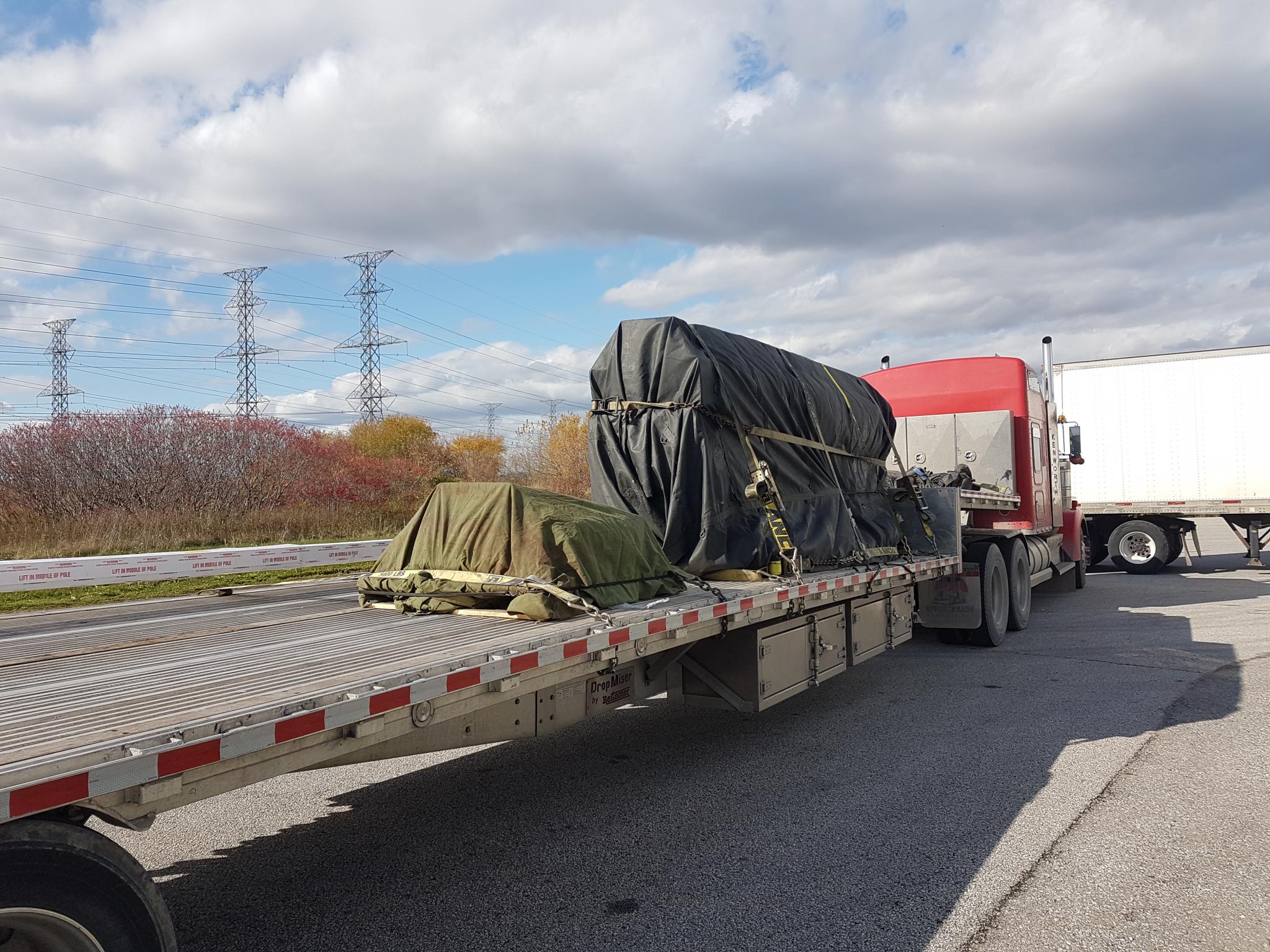

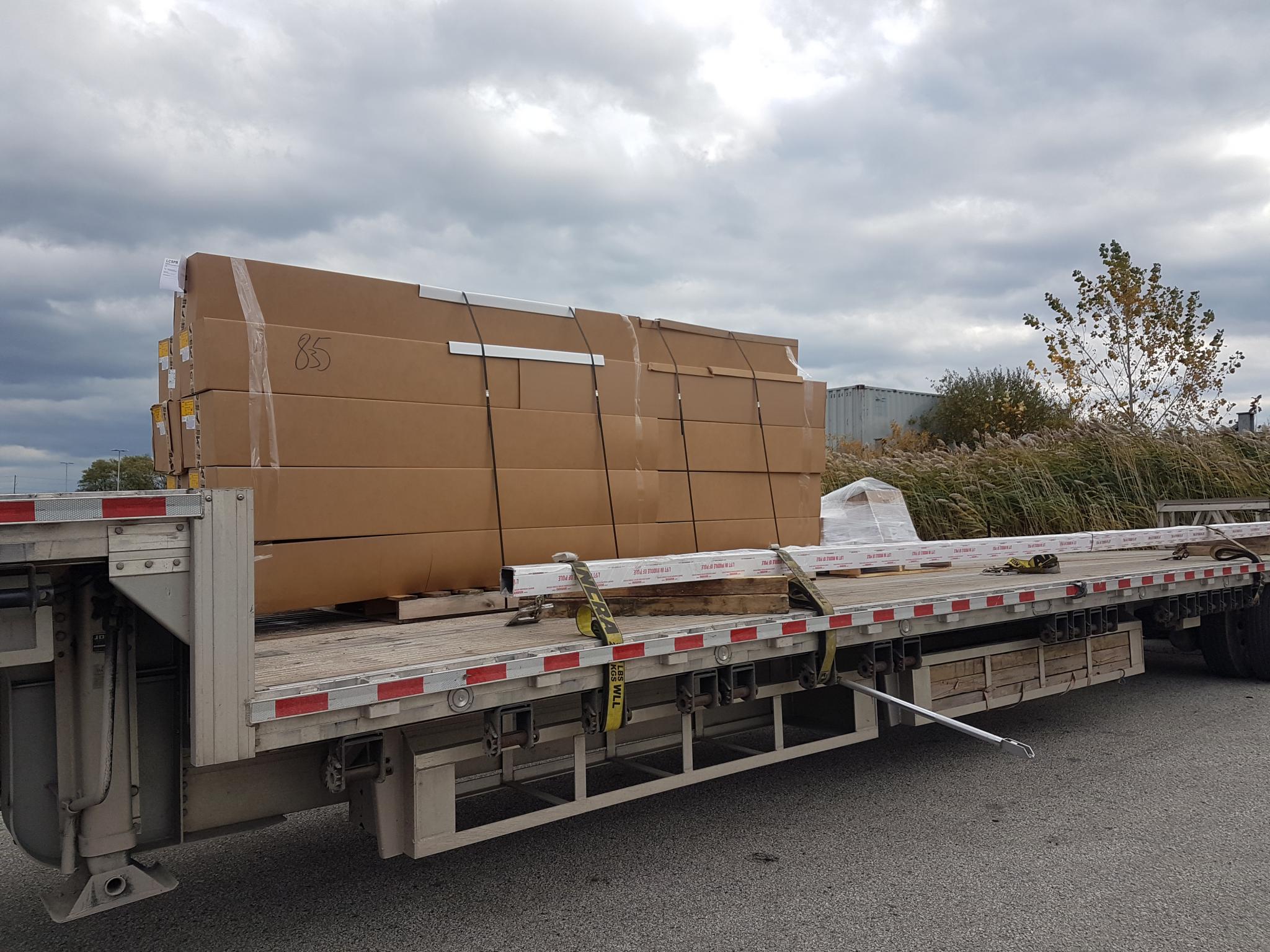

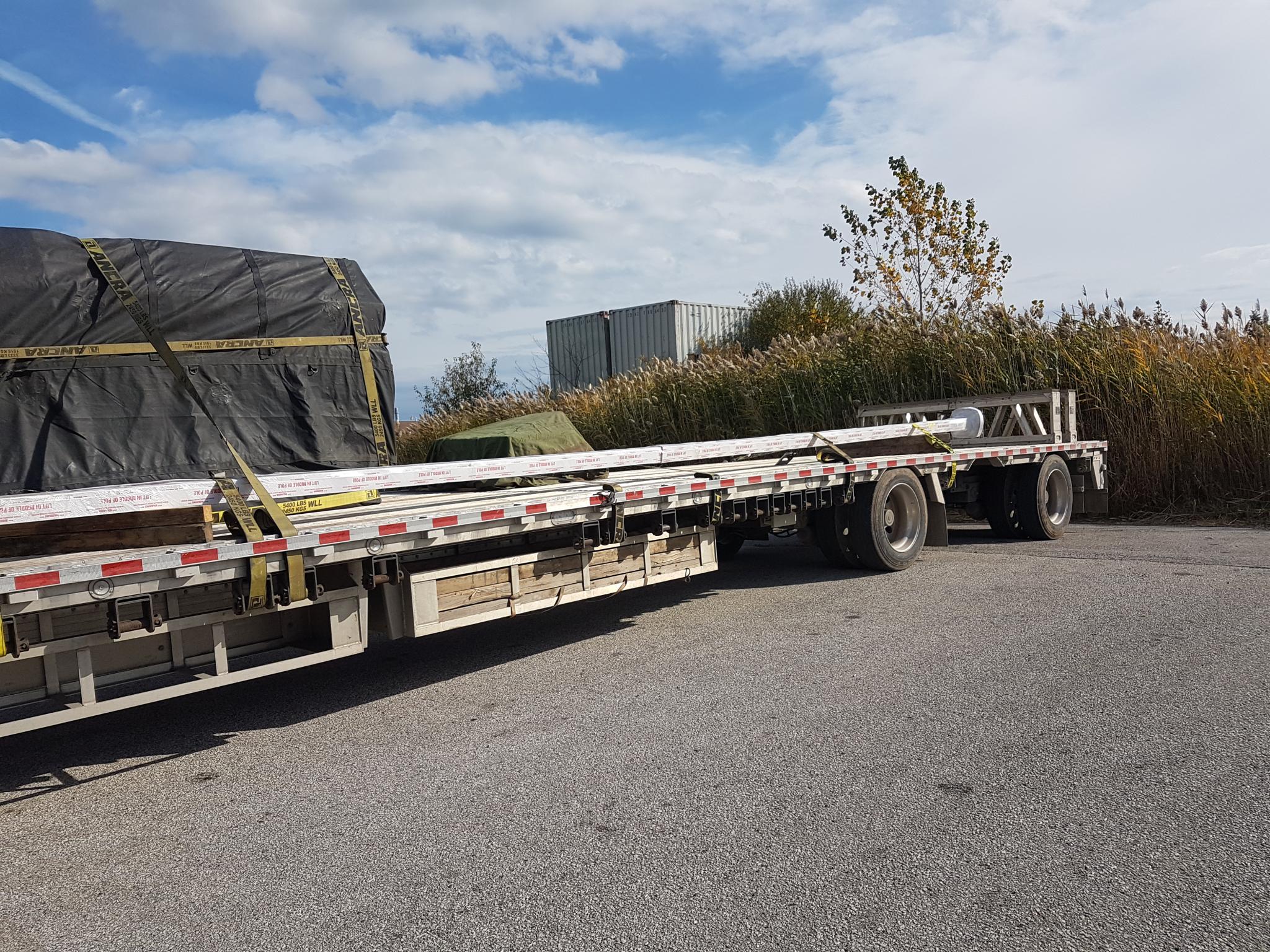

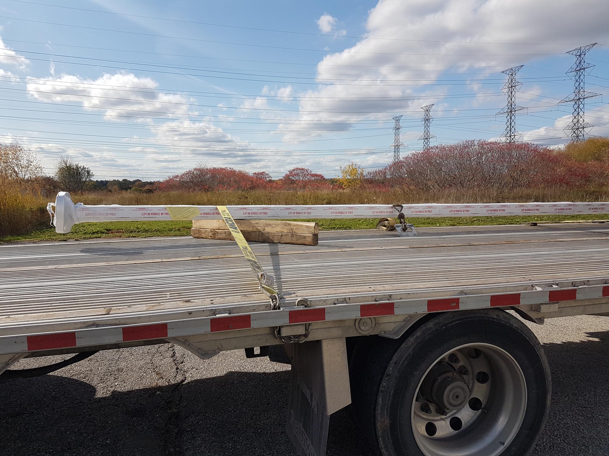

I figured i'd keep this thread going with this interesting load an my distain for cardboard boxes on a deck, this load so shoulda been on a curtin side or a van.
I only took one before pic an was halfway done before thinking of posting it here.
For today's discussion we have one 30ft long pole an 9 12ft boxes strapped to a 9ft pallet, a literal house of cards ready too tip at any time an a single pallet wrapped in plastic.
Nothing is heavy, the boxes i ended up 2 strap under an over to create a pocket too stop them from trying too tip over going down the road, i know im gonna be stopping alot too tighten straps. The last pallet not gonna lie the only thing holding it boxes in place is the tarp as i strapped the edges of the pallet.
This is one of those paying for fuel too get too my next load pickups.
