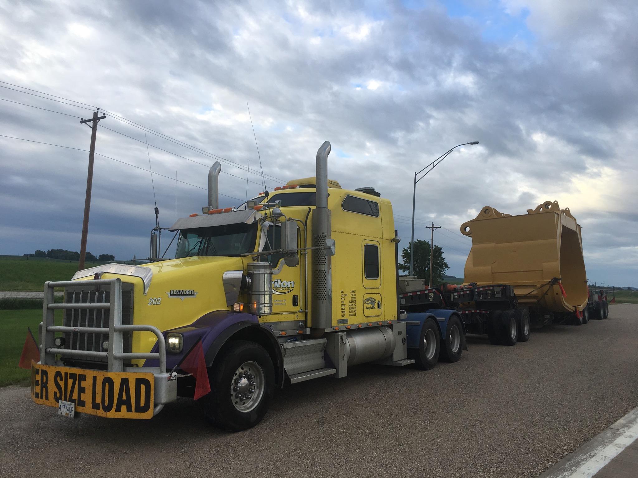

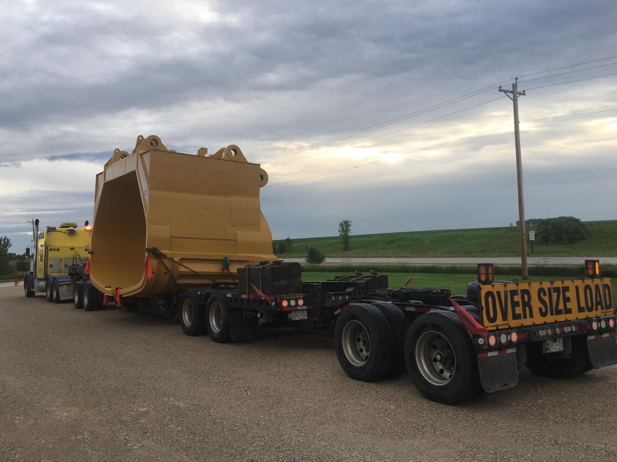

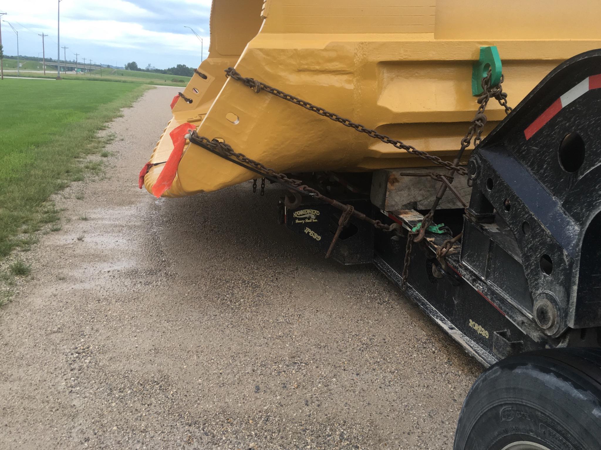

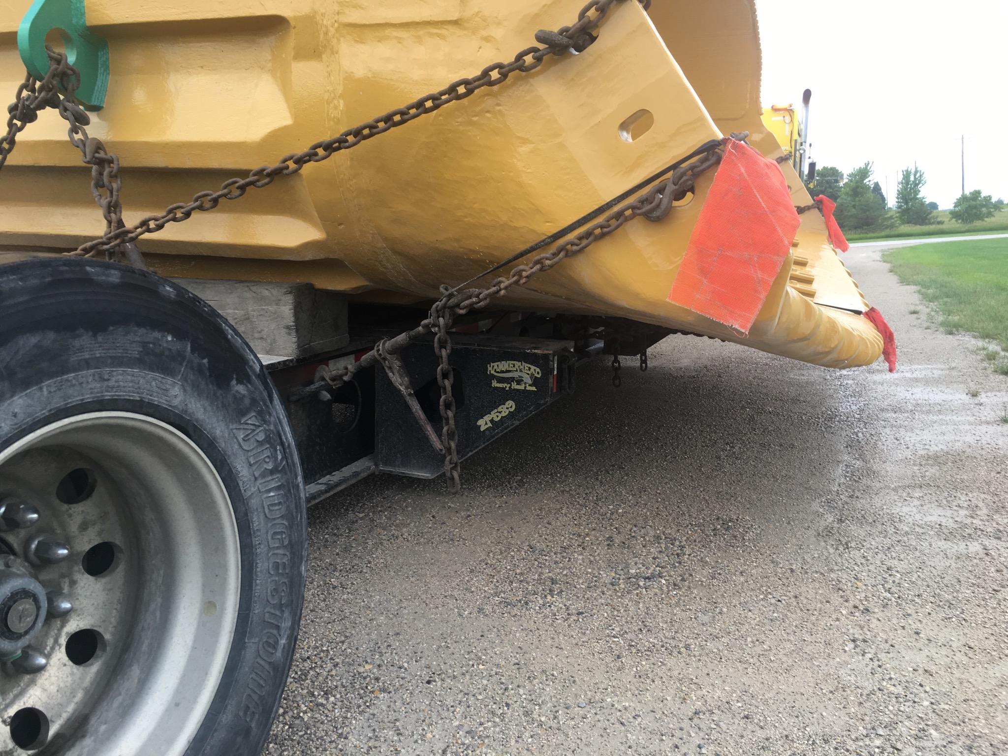

| RE: What would you have done differently?? I don't have any real close up pics of the securement on these loads. The new bucket is 14'4"W x 13'10"H x 18'L and weighs 109,000lbs (height is OTG, on the ground. Actual loaded height was 15'10". The used bucket is 15'W x 14'H x 19'L and weighs 122,000lbs. Both buckets were hauled on my rail/beam, so the actual under the load trailer width is 44"! This is a California legal 9 axle trailer, so it's lively! What does that mean? It rock and rolls constantly, so much so that heading north out of Vegas with the used one, the Lamborghini passing me slowed down to take pics/video of the load. Each load had sixteen 1/2" chains with direct contact securement. User's Signature: Why? Why do I always ask "why?" Because I can't learn or help teach others with "'cause I said so..." | |||
