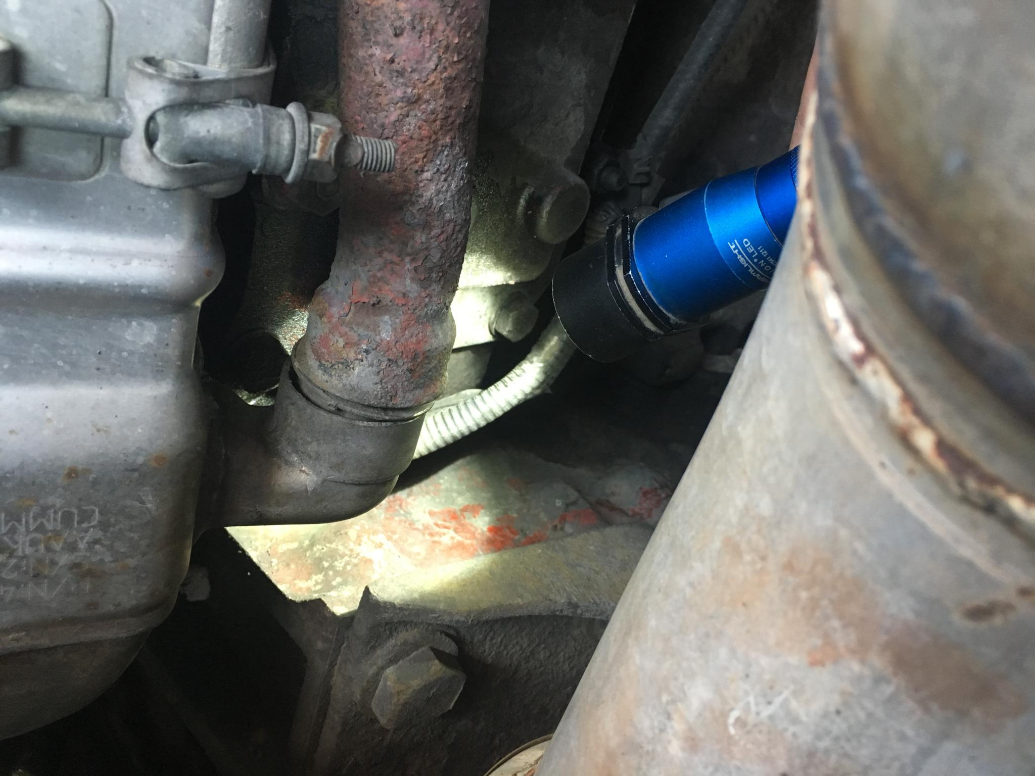

(11-24-2019 )Moose Wrote:  The VIN gives this ESN
Which gives a superseded turbo assy of 2881993 for a family 2
If I go try to build a 8287 engine the best they offer is a long block which does not include a turbo... the 8287 long block also includes 8288, 8520 & 8523 which all appear to be family 1 engines and would be a different turbo (2881994)
The engine number would be back here if it's accessible.
I see where you’re saying to look but it’s a little buried. Thanks!
So a family 2 CM870 takes a larger or just different turbo than a family 1 CM870?
