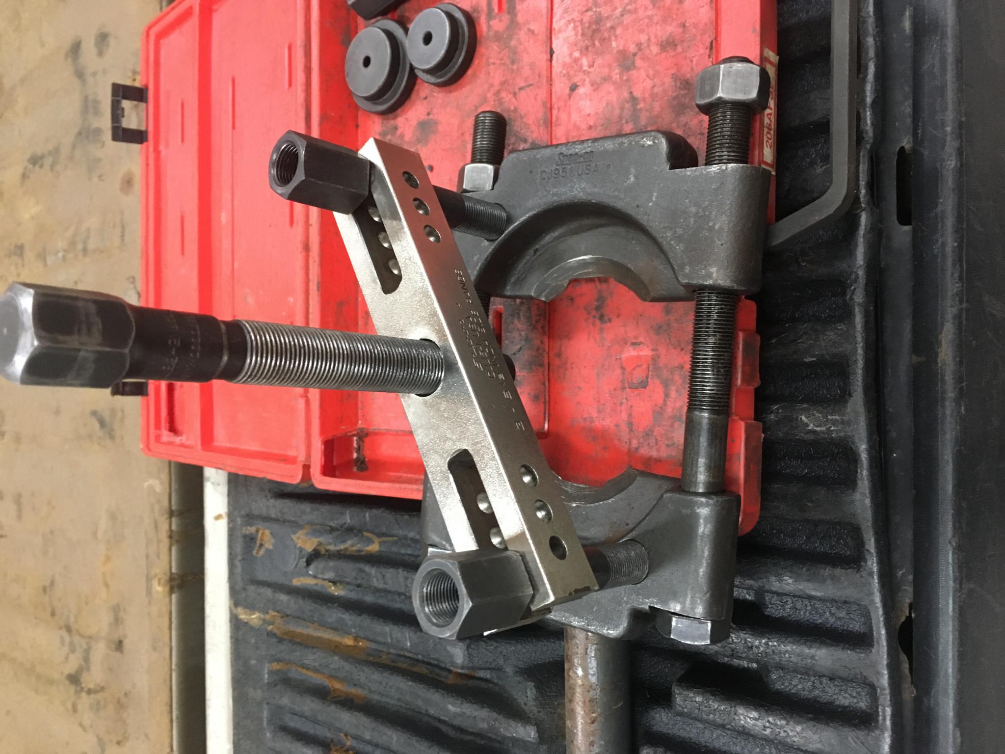

You should be able to use a puller and BFH on the yoke.
Or, possibly use just the bar puller with centre screw, put the straps back on over the bar. Tighten it up, smack with the hammer, tighten, hammer
Air hammer might help too
