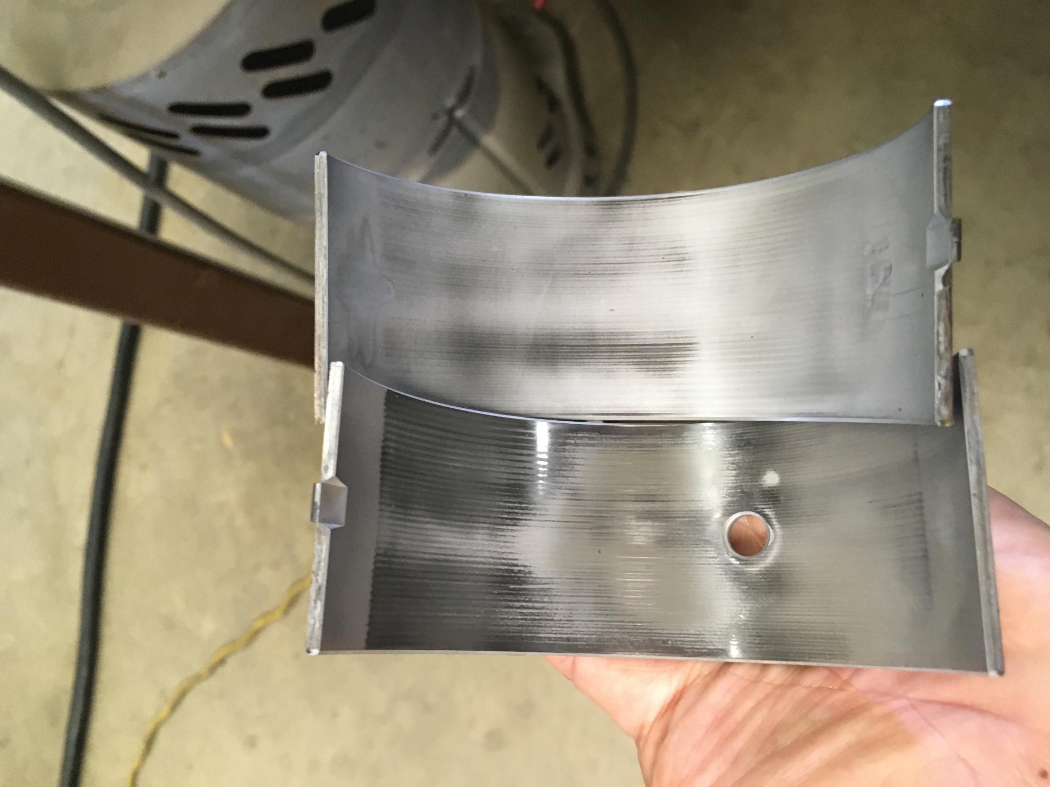

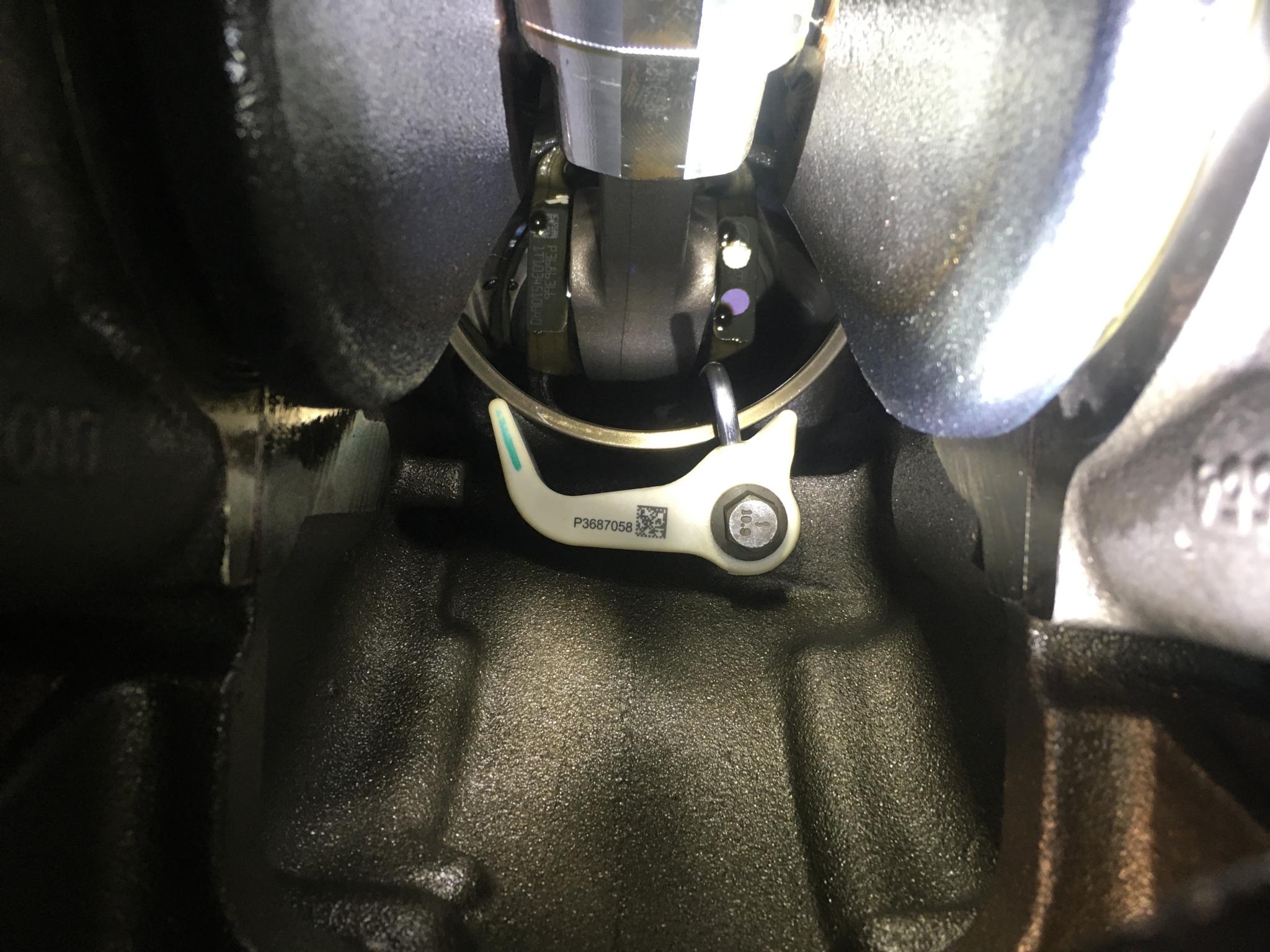

Update: so at the end of today I have finished all the rods, mains, and piston cooling nozzles. I am very glad I went ahead and did this service, because I did find wear on all the bearing surfaces, but the crank journals all still looked great.

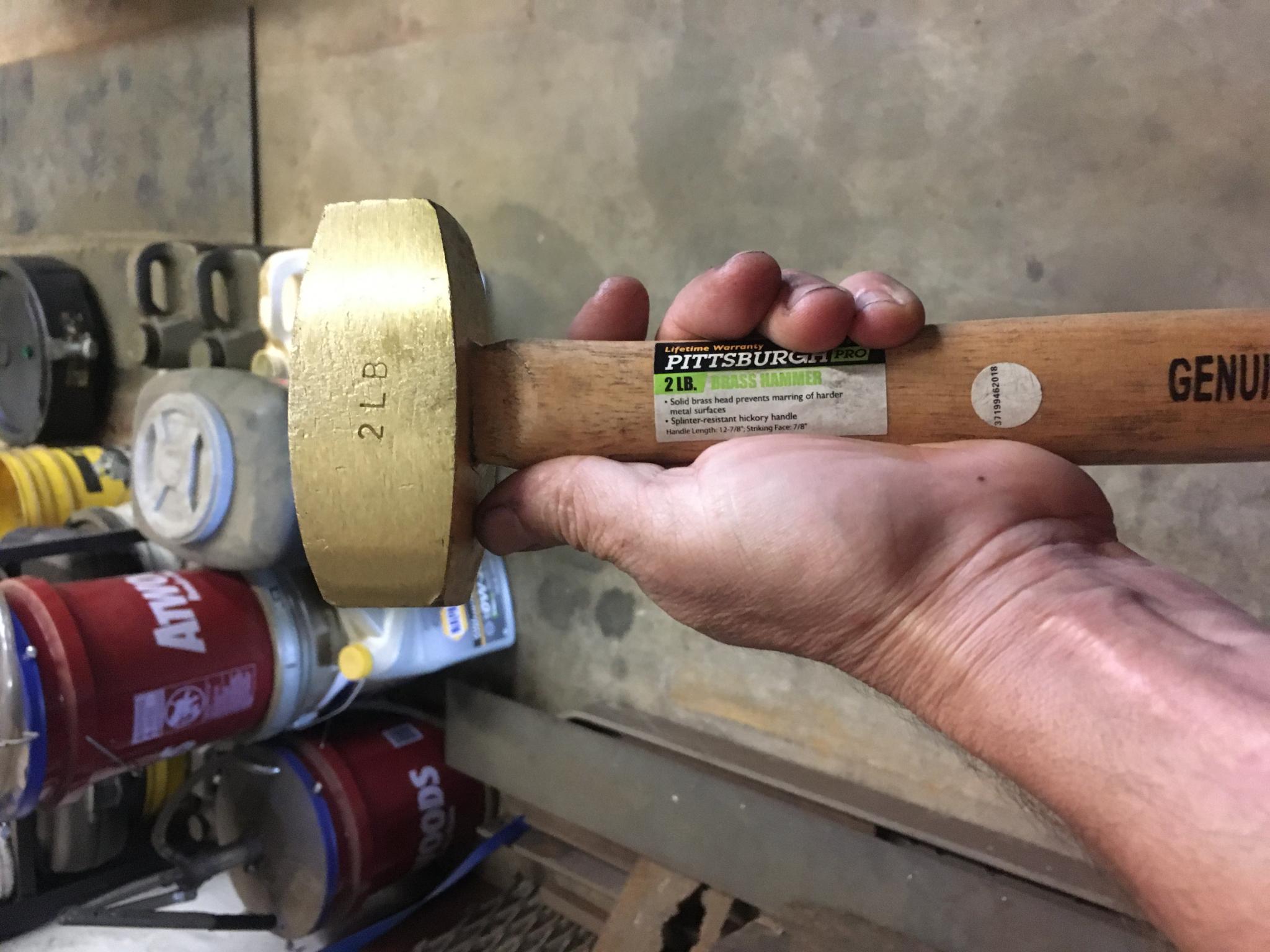

4. Removing the rod caps was a lot tougher then the mains. I feel Cummins really dropped the ball in the manual on this one. The manual says only “beat on the loosened bolts with a rubber hammer to loosen the caps” This does absolutely nothing other then gall the threads on the rod cap screws. (And I bet those bastards know this) anyway after beating the hell out of the first screws I tried using a large pair of channel locks with the jaws taped up with gorilla tape to protect the rod cap. I wiggled and shook, and pulled and squeezed and cursed but finally got the cap free. However the channel lock teeth did gall the rod cap up a bit. I did 4 like this, wrapping the teeth up with pieces of cardboard and more gorilla tape and shaking the shi#t out of them to finally get them to break free. THEN, my brother came home and showed me how he has always removed rod caps in the old CAT motor. He took a 2lb brass mallet and holding the handle about 3” from the head, barely tapped on the sides of the rod cap. So lightly you could barely even hear it. About ten taps on each side and it dropped right down. No pulling, no cursing, no shaking, and no marks at all on the rod cap. So hopefully the ones I marred with the channel locks won’t cause any problems later.

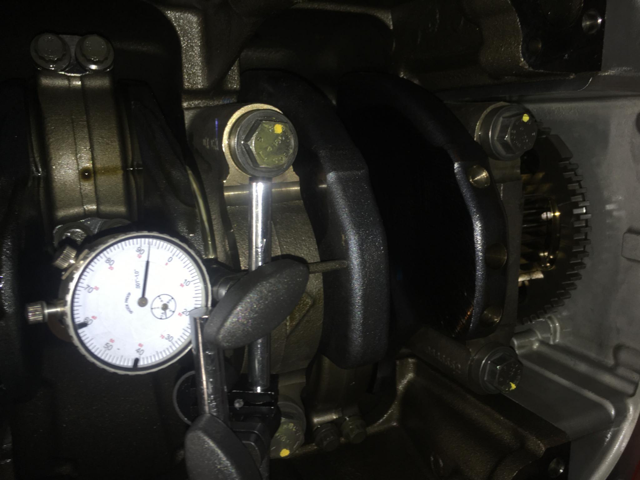

Other then the above, things went well. It took way longer then I thought it would because I was working alone. The motor bars over nice and smooth. I had the appropriate play in all the rods after final torque. Also checked the in play in the crank which was good.
