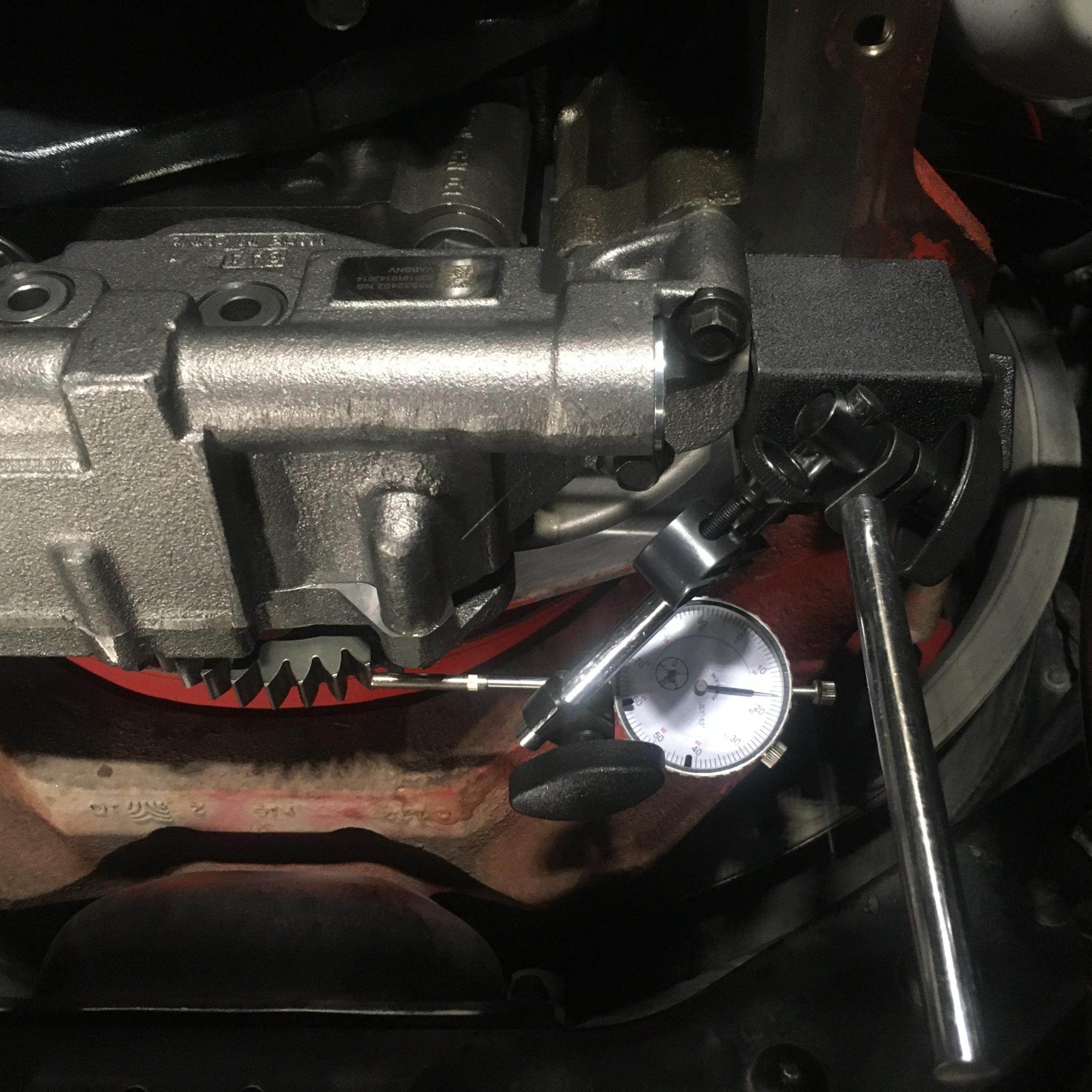

Thanks Uni, I’ll look for the TSB. The lash seemed fine though. The pump itself idler to drive gear was .006” off the truck. Then mounted up it had .017” at the bottom gear. Which makes the idler to crank .011”, the spec said .003”-.022” Where I am showing .011”
