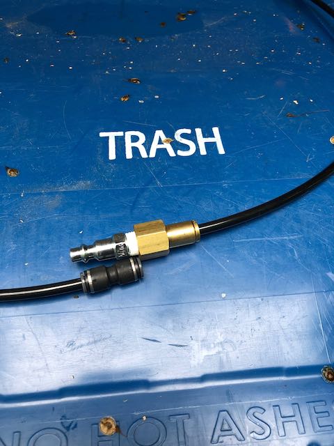

| RE: Bad temperature gauge or sensor? Could the fan clutch simply be stuck? I had issues with mine after it sat, I could not break it loose for the life of me, and it was a new fan clutch, so I figured it still had to be good... So, I rigged this little tool up... FleetPride hooked me up with the 1/4" air line and fittings, I think it all cost around $15 or so... ![]() I hooked the push pull fitting to the air line running off the solenoid to the fan clutch, and hit it with a full blast of air from my little Lowe's 90psi compressor. POP! That is all it took, may be worth a shot. The motor was NOT running when I did this. CM-871 | |||
