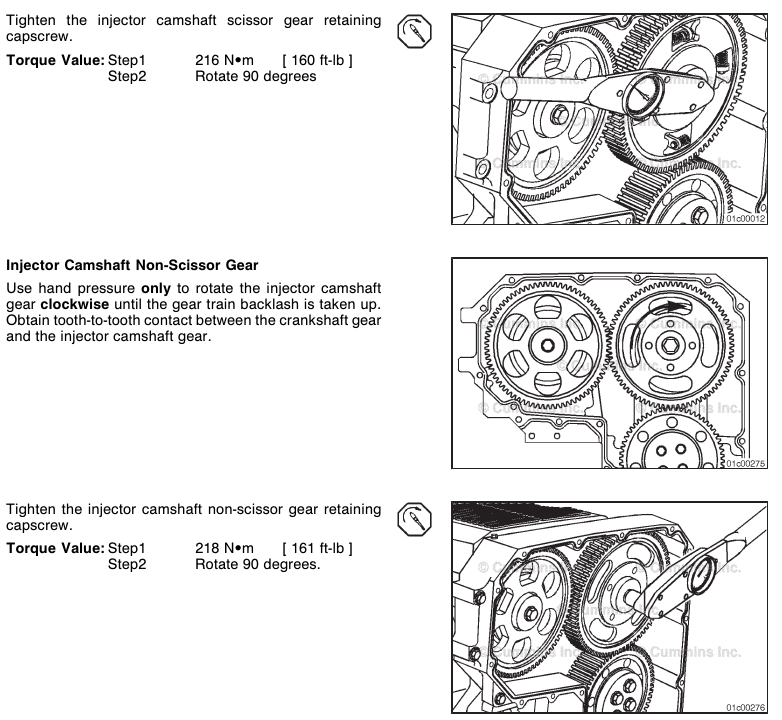

(10-23-2021 )Nostalgic Wrote:  Here's an old copy I had saved...
And from today...
Not sure why exactly those specs are changed so much, but it screws with my head when I think I know it, look to make sure, and it's different. Dear Cummins, I don't need any help developing dementia lol.
I don't know where you got that top picture but that is NOT what I am showing for my ISX. Even my old manual from 2007 says 160-Ft.Lbs then 90-degrees.. this is what I set all of them to (CM570, CM870, CM871).
(this is from the 2007 ISX service manual) ...
