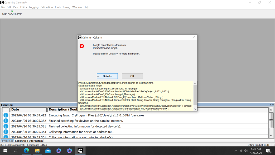

RE: Increasing HorsePower -- What You Need To Know (04-21-2023 )Rawze Wrote:(04-21-2023 )jrbmechanical Wrote: ... Ok thank you sir, would EF10398.17 or EF10399.17 be a direct comparison for EF10392.17 or EF10394.17? ECM took the EF10394.17 file. Customer wants to be at 600HP and 2050FTTQ Also I am running into an error when trying to connect Calterm to the ecm, it says "Length cannot be less then zero. Parameter name: length. Reason I trying to connect with calterm is even though all of the load based speed control and other similar parameters are maxed out and disable in insite, truck still falls on its face around 1700-1800 rpm. Trying to see in calterm all of the other parameters are disabled that you had listed in another posting about LBSC | |||
