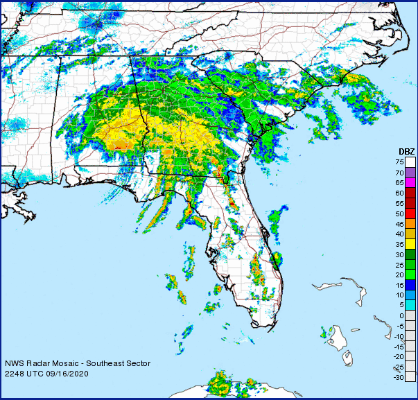

RE: Helping JimT out with an inframe ... (09-16-2020 )Mattman Wrote: How about got it back on the road yet? I think he put the front structure back on it earlier today. Thing looks pretty good with all the fresh paint. Of course, there is the edges of a hurricane bearing down on us and it started raining today. Not sure how much that will slow him down. User's Signature: ->: What I post is just my own thoughts and Opinions! --- I AM Full Of S__T!. | |||

RE: Helping JimT out with an inframe ... They say it has done some raining over Alabama's way. User's Signature: 2015 Kenworth T660 | |||
