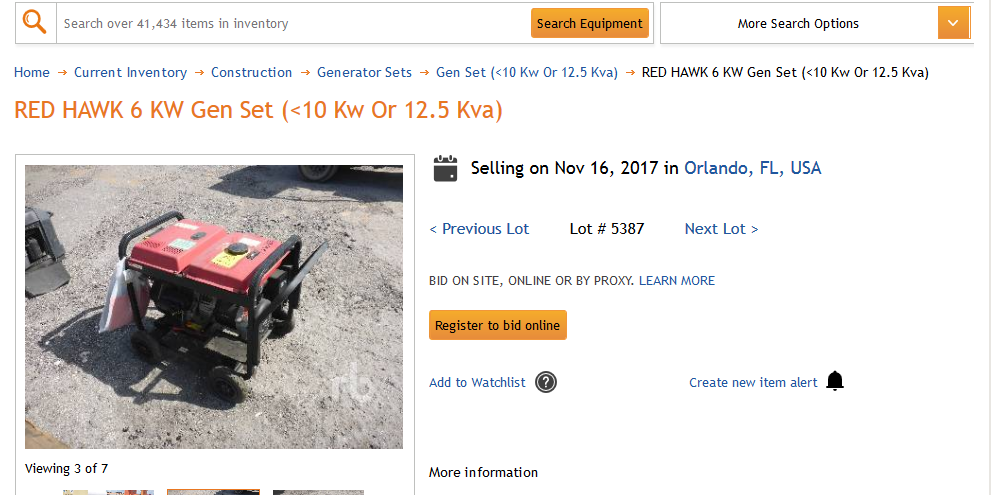

If you still looking at diesel generator one is going to be on Ritchie Brothers auction on 11/16/2017 in Orlando, FL lot# 5387. The generator is brand new. Good chance to got it for nothing.

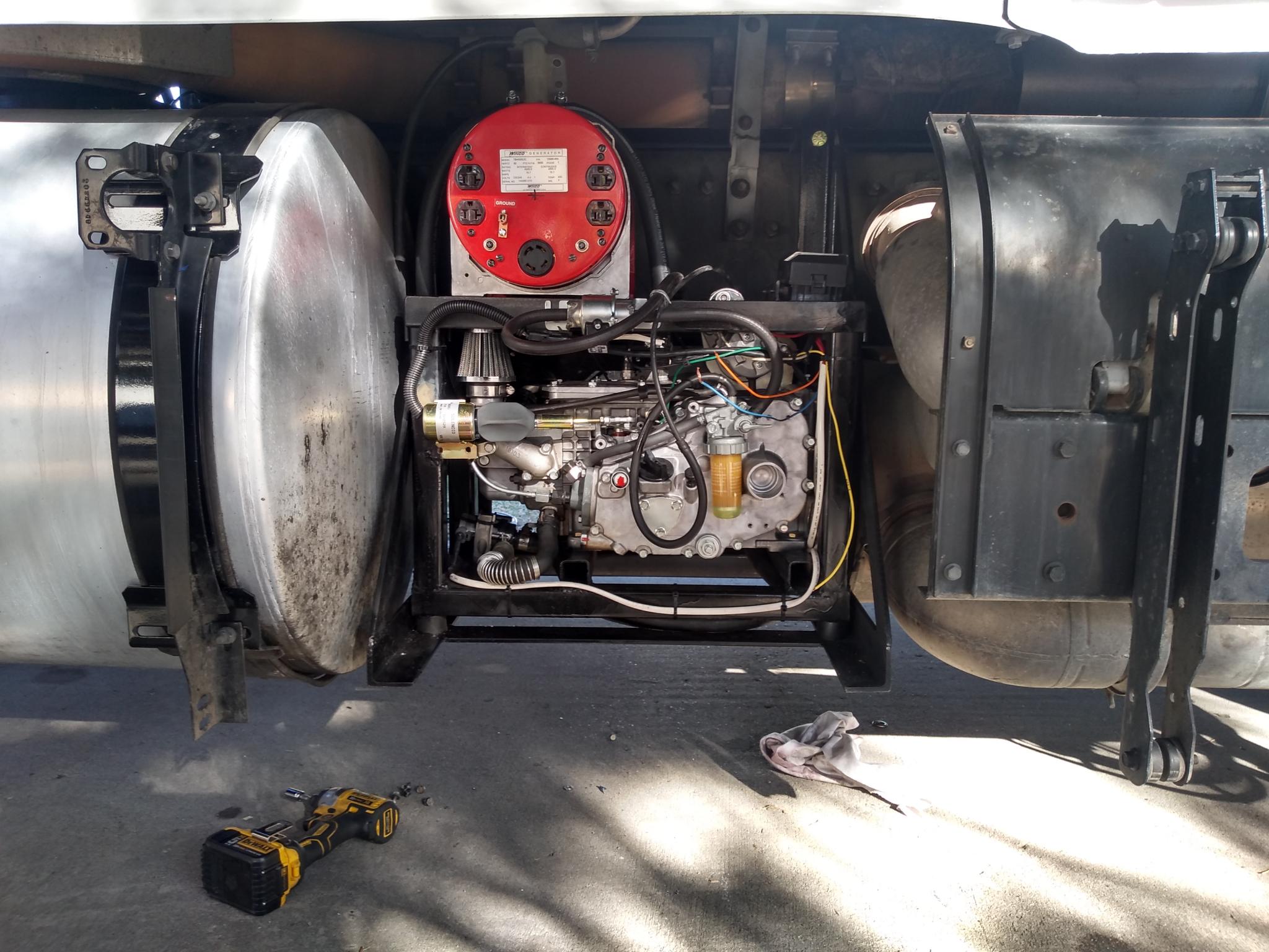

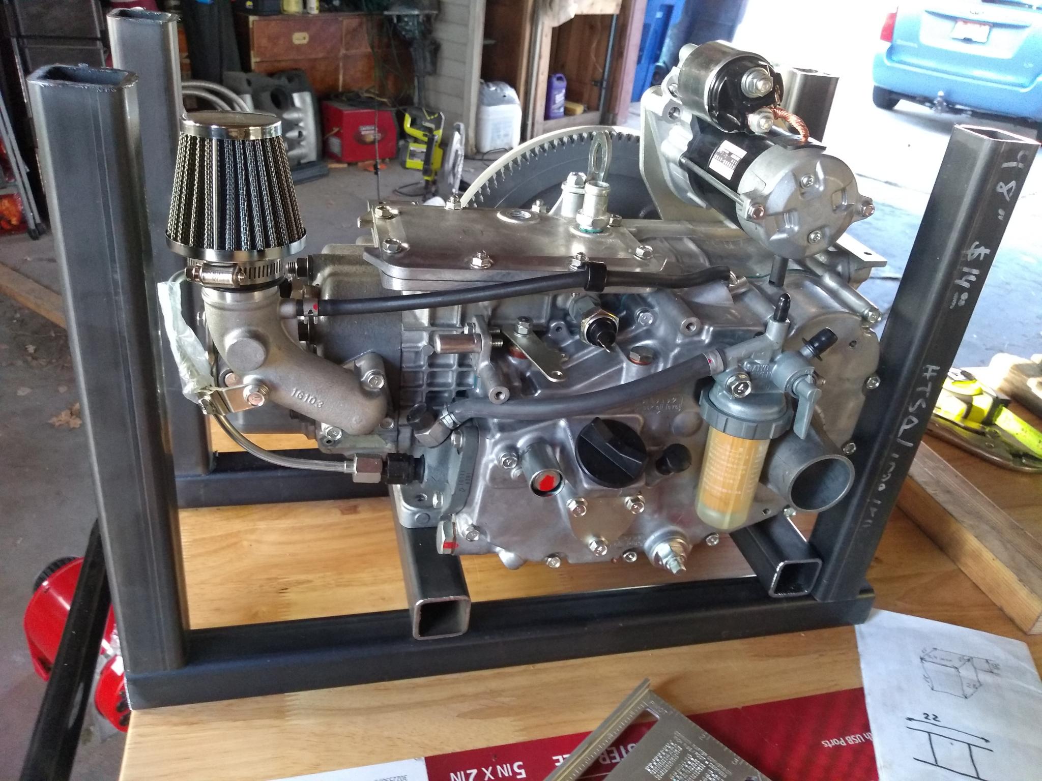

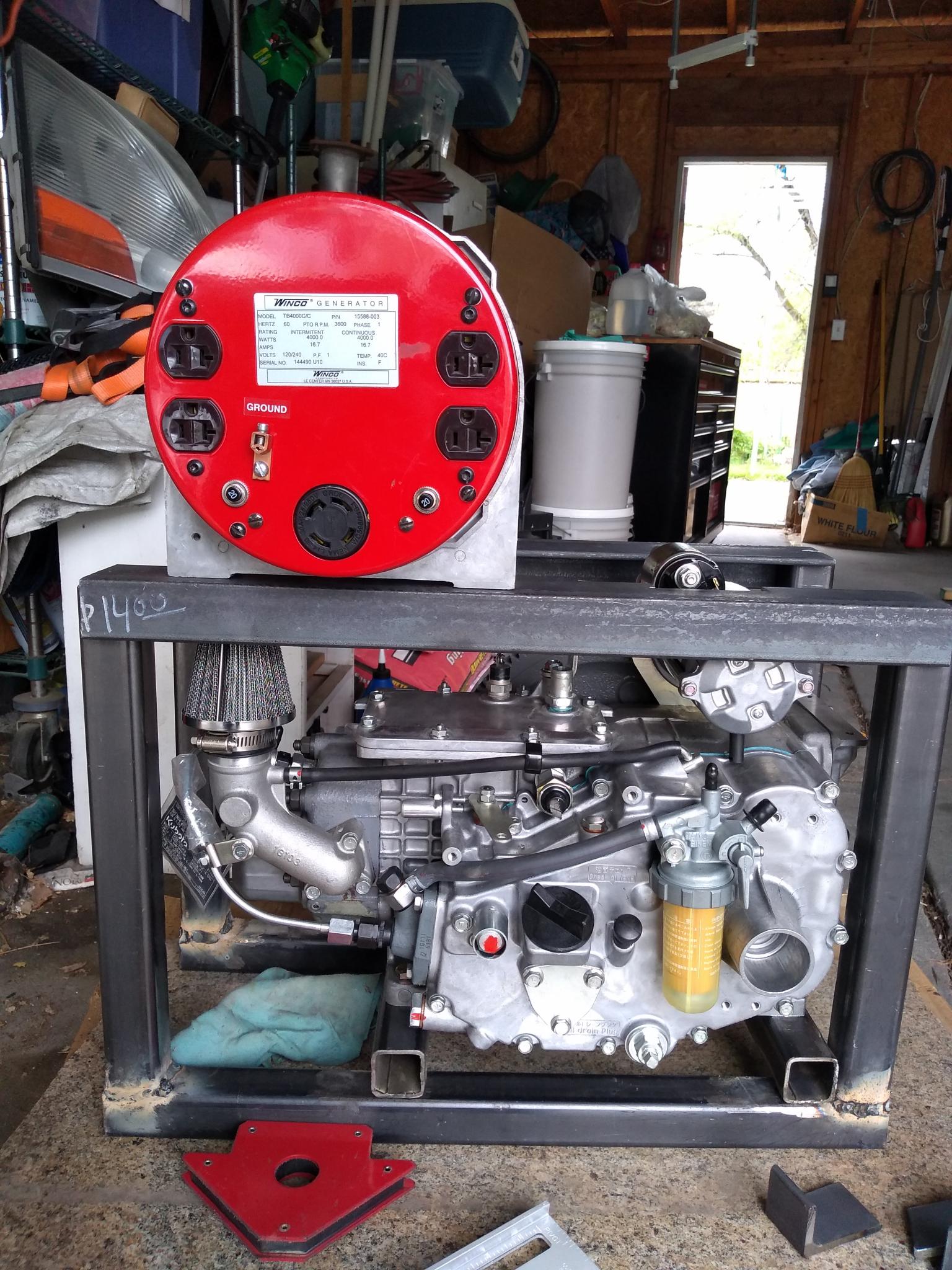

I'm running one right now all day long waiting my appointment time. DIY from the parts.
