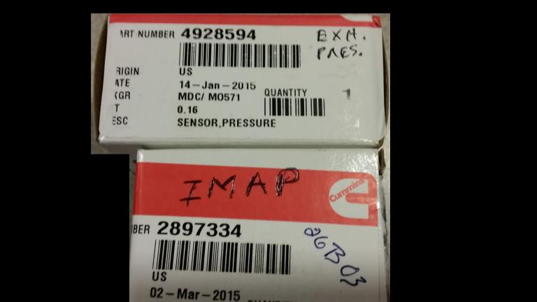

* Immediately REPLACE the IMAP and Exhaust Back-pressure sensors on it.
