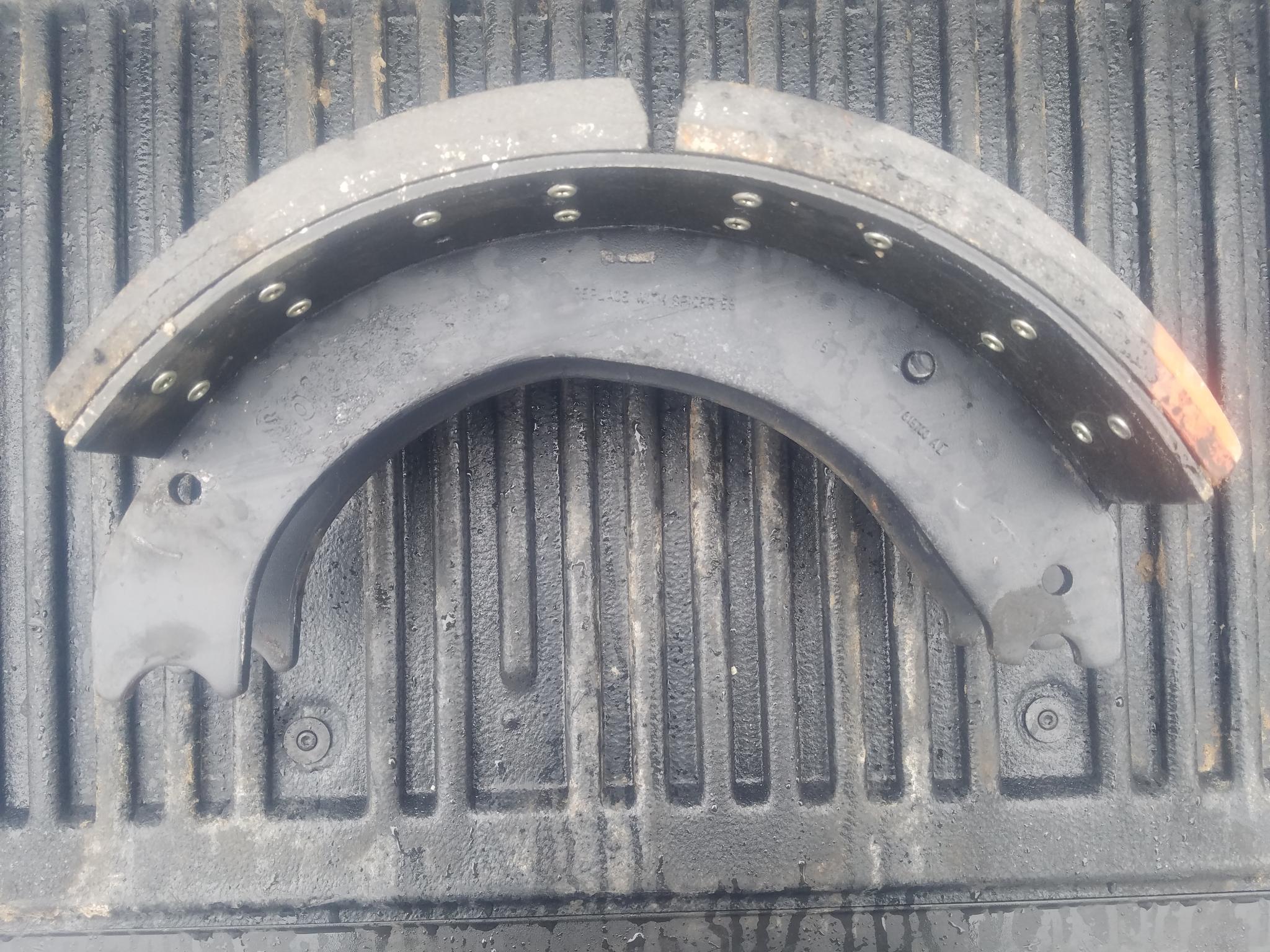

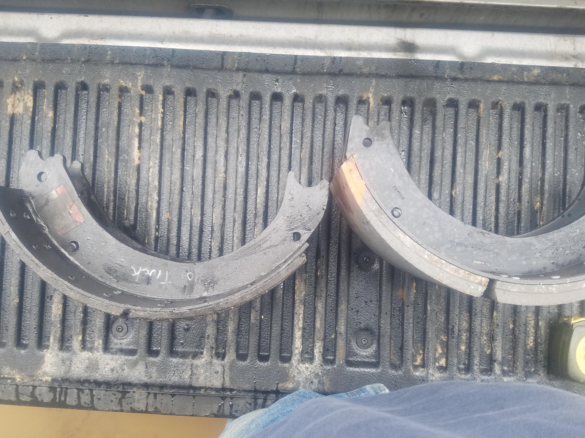

RE: A real head scratcher !! (02-20-2018 )Rockhwy Wrote: I had same problem once put all new brakes and drums on, last drum wouldn't go on went to opposite side wouldn't go on so I started measuring and brand new drum was warped enough that it would not go on so measuring every thing is good idea like other's have said good luck I can't even get the old drum to slide on. The new shoes are not Q+ here's pics. | |||
