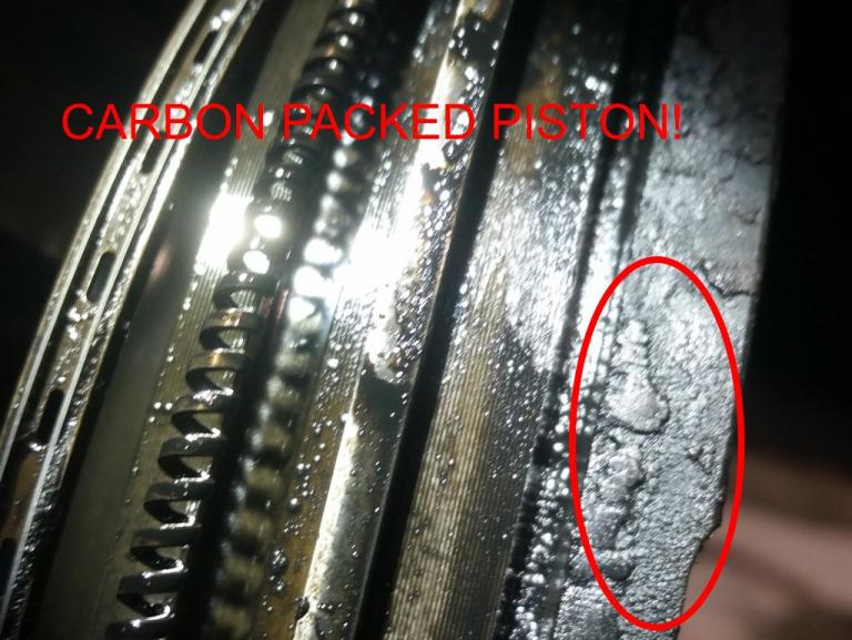

You are describing the excess soot scenario that ISX engines get.
It is caused by the engine producing a LOT of soot!. Much more than normal, most of the time, due to a lack of any kind of regular tune-up works, sensor cleaning/replacements, etc. The result is...
* Lower than normal fuel mileage.
* soot packing up the oil filters making for low oil pressure after a while... but goes away for a bit when replacing oil filters.
* eventual carbon packing on the pistons
./uploads/201602/post_1744_1456209480_cb1a6a607e723a6321384b040dd97e78.jpg
* You get ...
* When it gets bad enough you get clogged IMAP and other EGR sensors, causing the engine to have power loss or hesitation in response. this also makes the problem accelerate.
* a LOT of excess engine wear.
* Clogged passageways and cross-drillings in the rocker shafts, rocker arms, rollers and cams start to run dry in the head.
* Clogged oil filters and oil filter plugging
* It leads to Clogging of the crank case filter, and that leads to oil seepage at the engine brake harness plug, and at the oil filler tube. And can also wipe out the face seals to the turbocharger.
You are likely slowly destroying your engine by driving it around like that!
