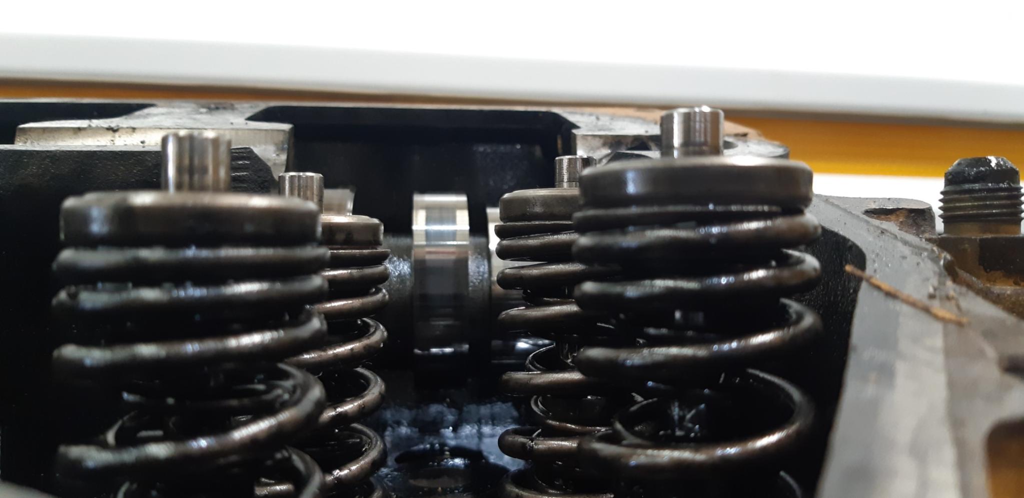

Head is off, extreme valve recession, check out the 2 right ones:
./uploads/201908/post_2967_1566366639_3cb57faea40304a4746e13e67b5f8b5c.jpeg

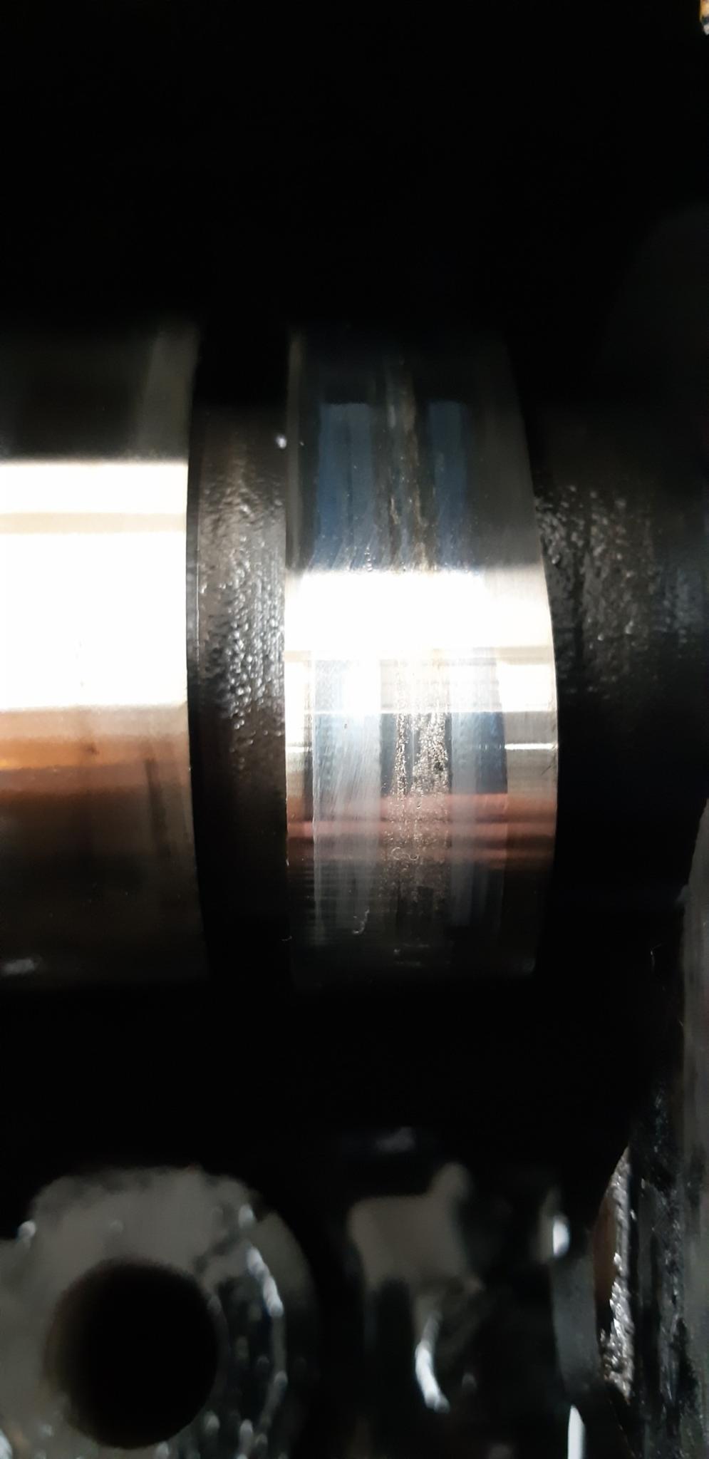

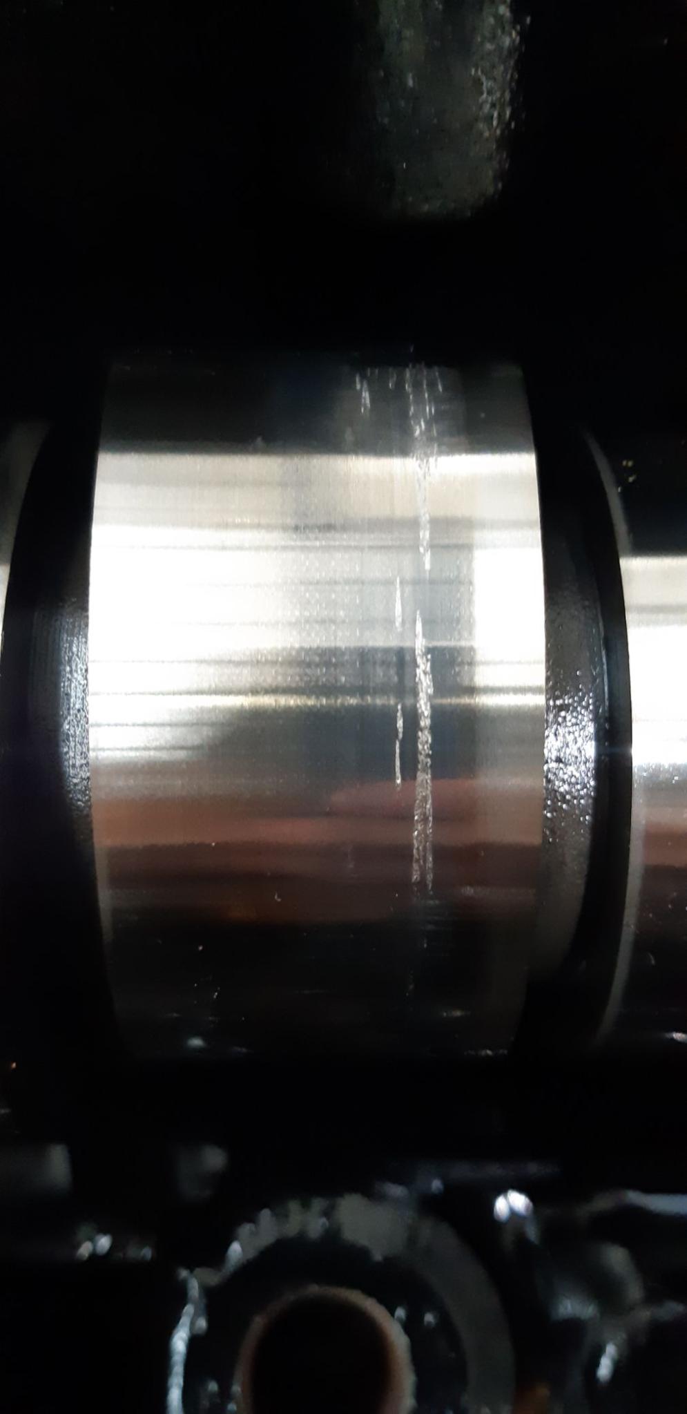

2 of the cam lobes aren’t in the best shape either:
./uploads/201908/post_2967_1566366722_301e77f44c7c1514817a65764b4382b5.jpeg
./uploads/201908/post_2967_1566366776_395295af7c12d05c30d41982ffedd38e.jpeg
My brother has gone to Cat and ordered a new head, gasket kit, cam and a rocker.
Also ordered an aftermarket piston/liner kit according to Uni’s recommendation.

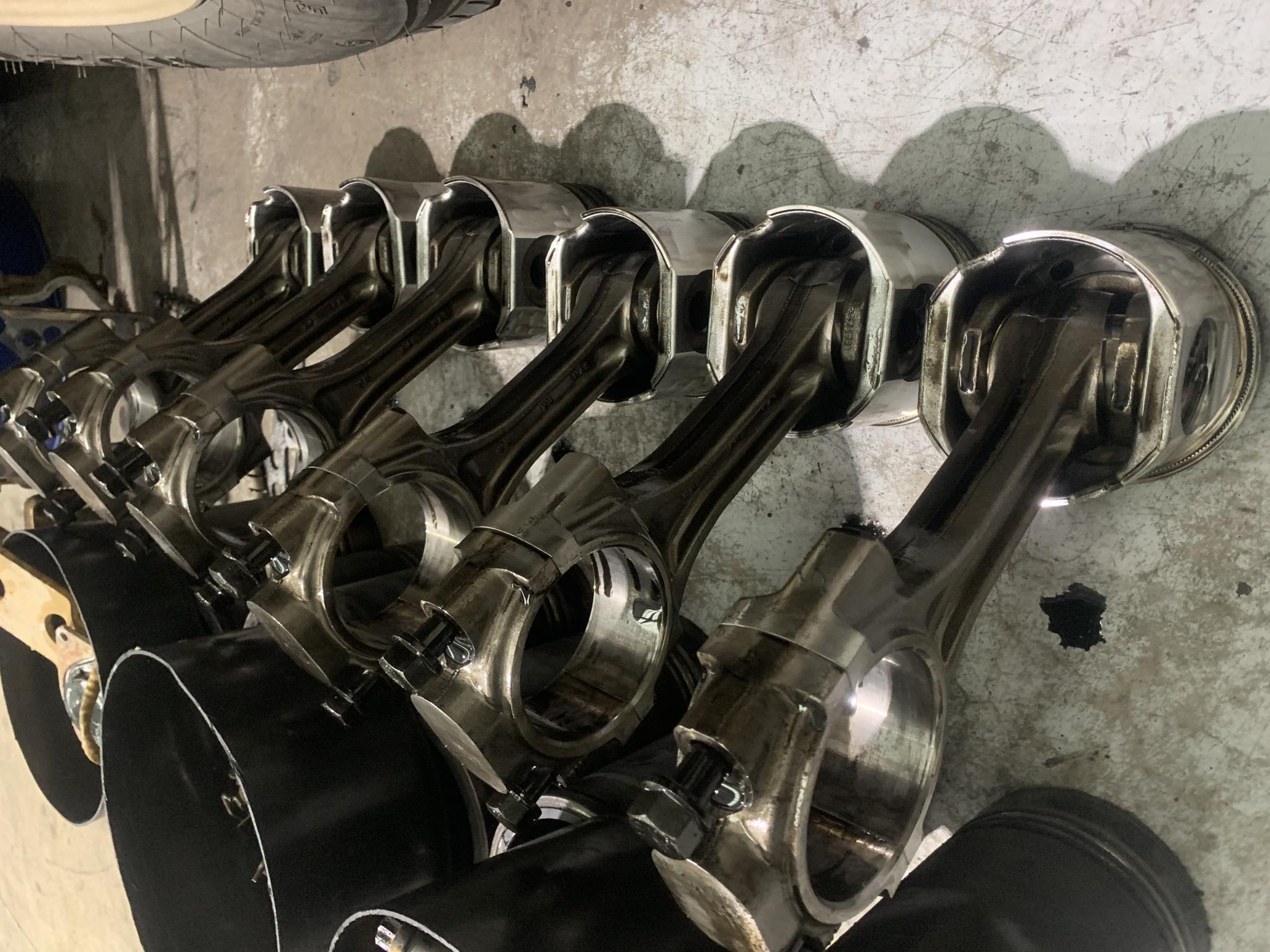

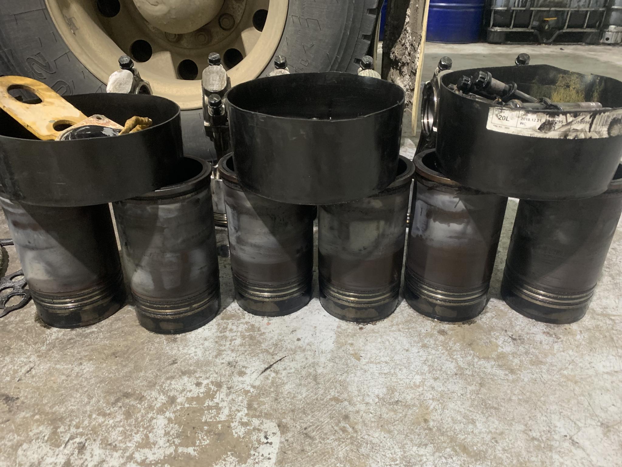

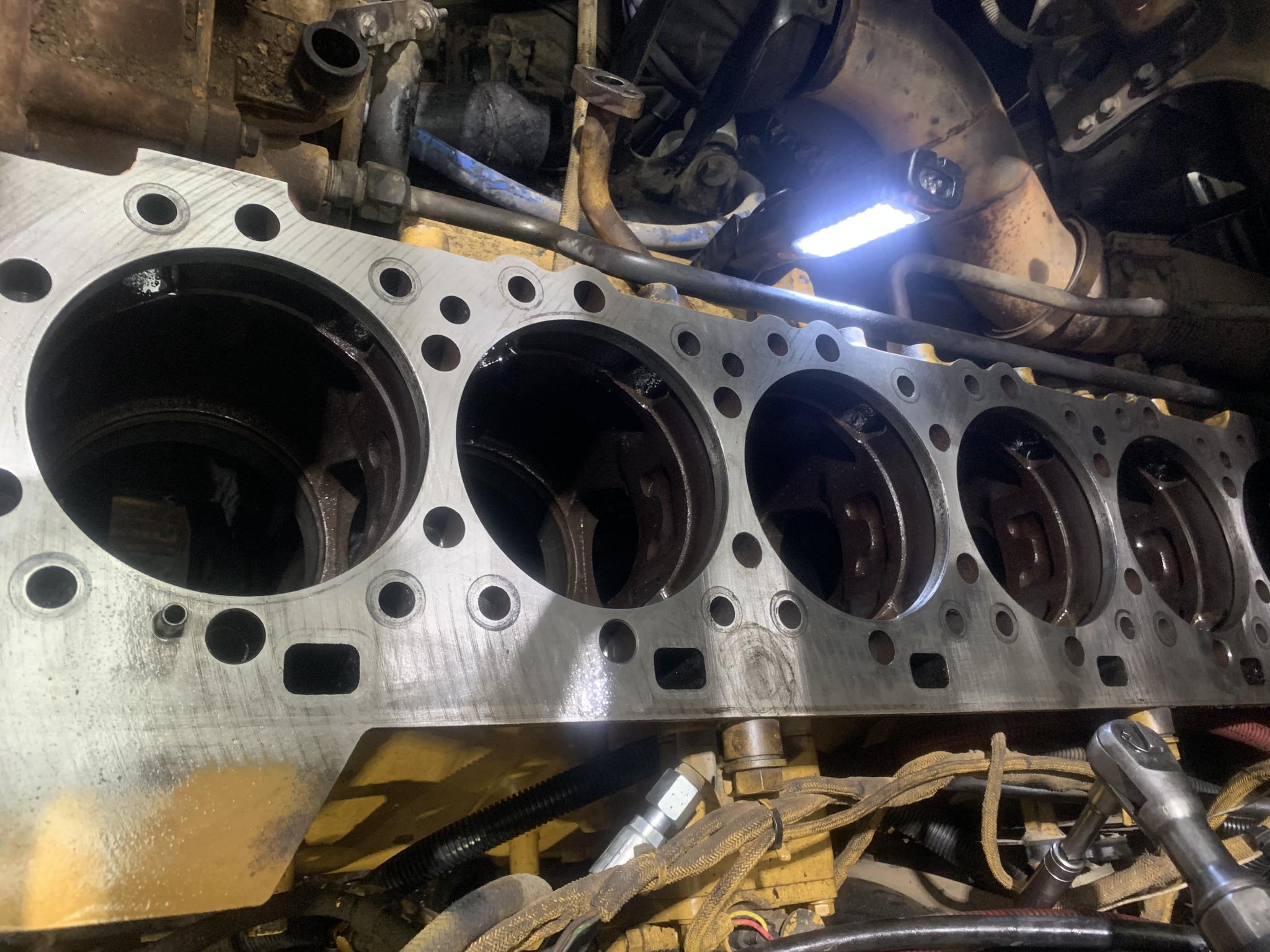

Block looks flat as a pancake! Looks virgin to me, will take some measurements:
Even the pistons looked good, liners smooth with no pitting:
If it wasn’t for the head being worn could of just put a headgasket on and off we go. Looked like was pushing gases through cylinder 2 & 4 of the firing ring.
08-21-2019, (Subject: C15 6nz Inframe time )
RE: C15 6nz Inframe time
i would cut it, i can see the block fretting from here. Make sure you measure the new head for flatness.
