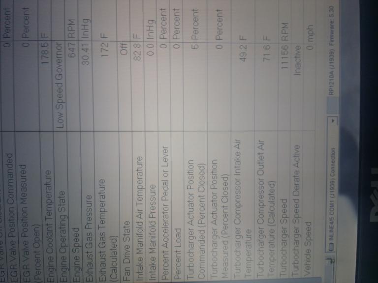

02-24-2016, (Subject: Help low boost )
RE: Help low boost
./uploads/201602/post_824_1456331368_43908e9f644a44dc70aa26fc1cfa6904.jpg
This is what I'm seeing
RE: Help low boost
Also 0.0 crankcase pressure.
0.0 for the cc pressure senor
0.0 for turbo actuator signal sensor
RE: Help low boost
(02-24-2016 )gonzo1949 Wrote:  Also 0.0 crankcase pressure.
Those are all normal for that type of tuning
turbo actuator signal sensor > not used by computer because it is J1939 instead.
cc pressure senor/crankcase pressure > not used after that type of custom tuning. unrelated.

What about the meatured being 0% for the turbo position that's not right. Sounds like wiring or actuator problems.
RE: Help low boost
Boost was 43 hg which is like 22 lbs . That's what the gauge reads. Voltage for the actuator senor reads 0.0 as well .
