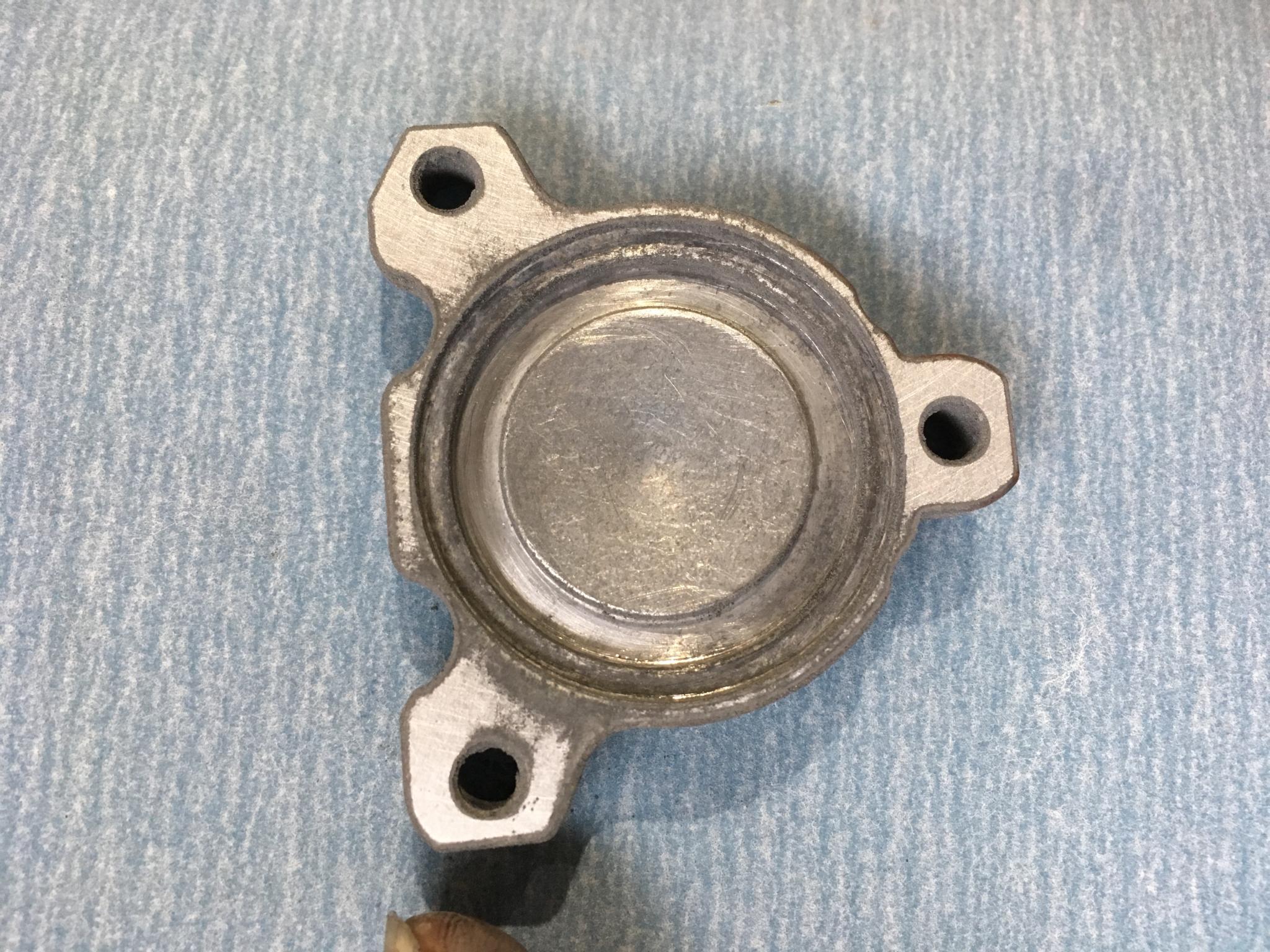

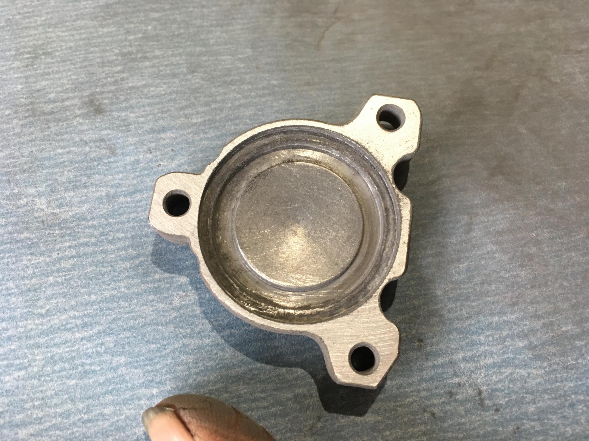

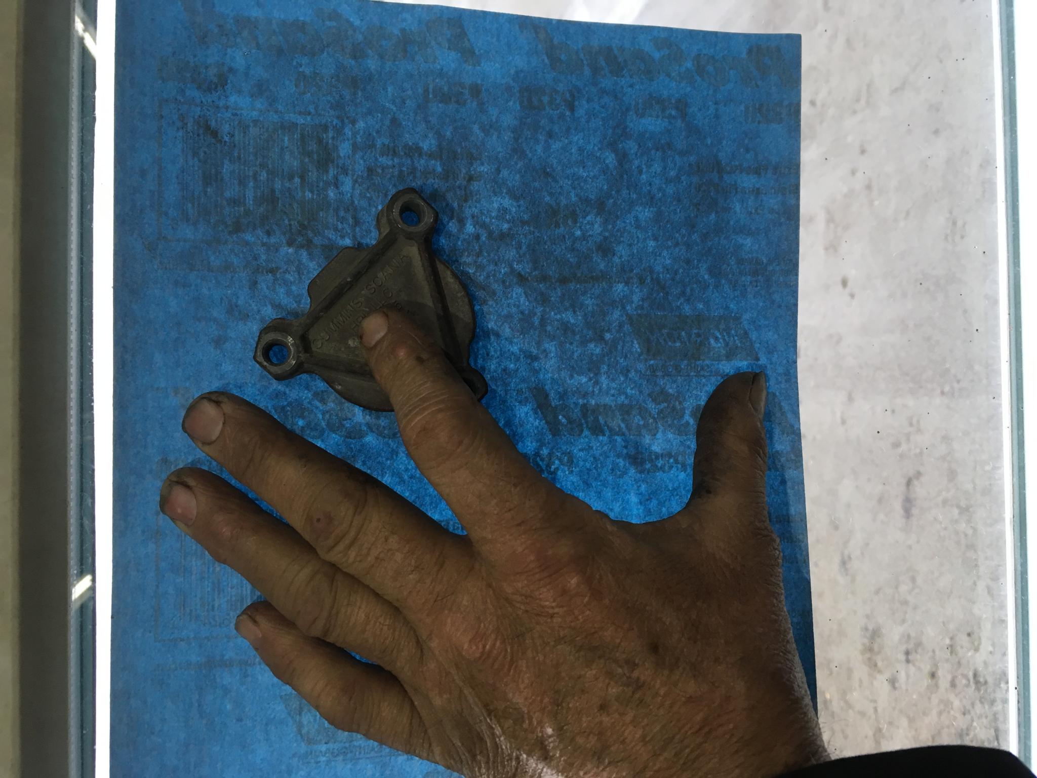

Thanks Everyone got a kit coming out US should be here thurs or monday. Rebuilt the pulsation dampeners today. Just thought i would through this out there. I usually go to the window when im working with something like this. Glass being as flat as it is makes an awesome surface to face anything. Im using 320 and in less than 5 min nice flat faces again FYIW
