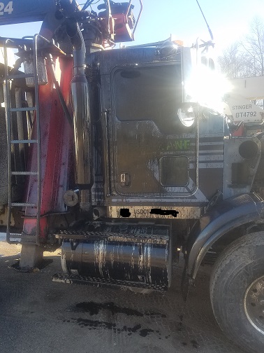

RE: Oil leaking from turbo (07-18-2020 )Chamberpains Wrote: I threw 7 gallons of oil out the exhaust on a 60 series I had. After I replaced the turbo in the parking lot at the Detroit dealership I drove it down the road till it stop smoking.... a day or 2 later.... Did it look something like this? ![]() Truck got towed here after the turbo grenaded. I replaced the turbo but it never dawned on me that the exhaust would be full of oil.......... lesson learned | |||

| RE: Oil leaking from turbo ^^^^^^^^^HAHAHAHAHAHAHAHA^^^^^^^^^ That really made me LOL. Such carnage makes me laugh because its sucks but there is nothing you can do about it. It brought back such fond memories. Except my stack was behind the cab and my tarps covering the rebar I had on were dripping with oil. Gooood times.... :-) | |||

| RE: Oil leaking from turbo Very close to that. I don't think washing the inside could hurt anything. | |||

RE: Oil leaking from turbo (07-19-2020 )74bassman Wrote: Very close to that. I don't think washing the inside could hurt anything. assuming they are hollow... (de-mandated) ... not a bad idea to check em to ensure there is not a couple gallons or something in em. User's Signature: ->: What I post is just my own thoughts and Opinions! --- I AM Full Of S__T!. | |||
