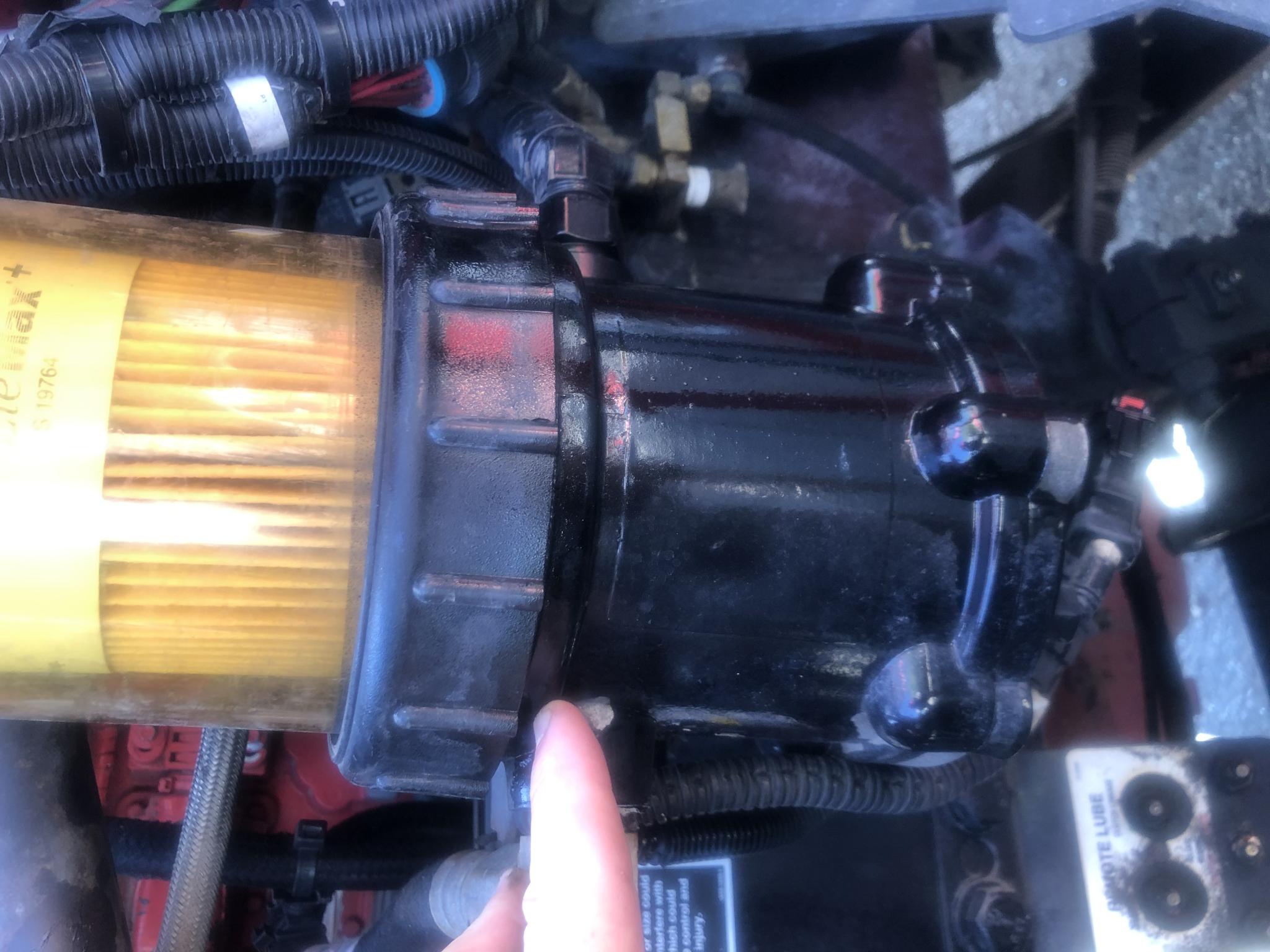

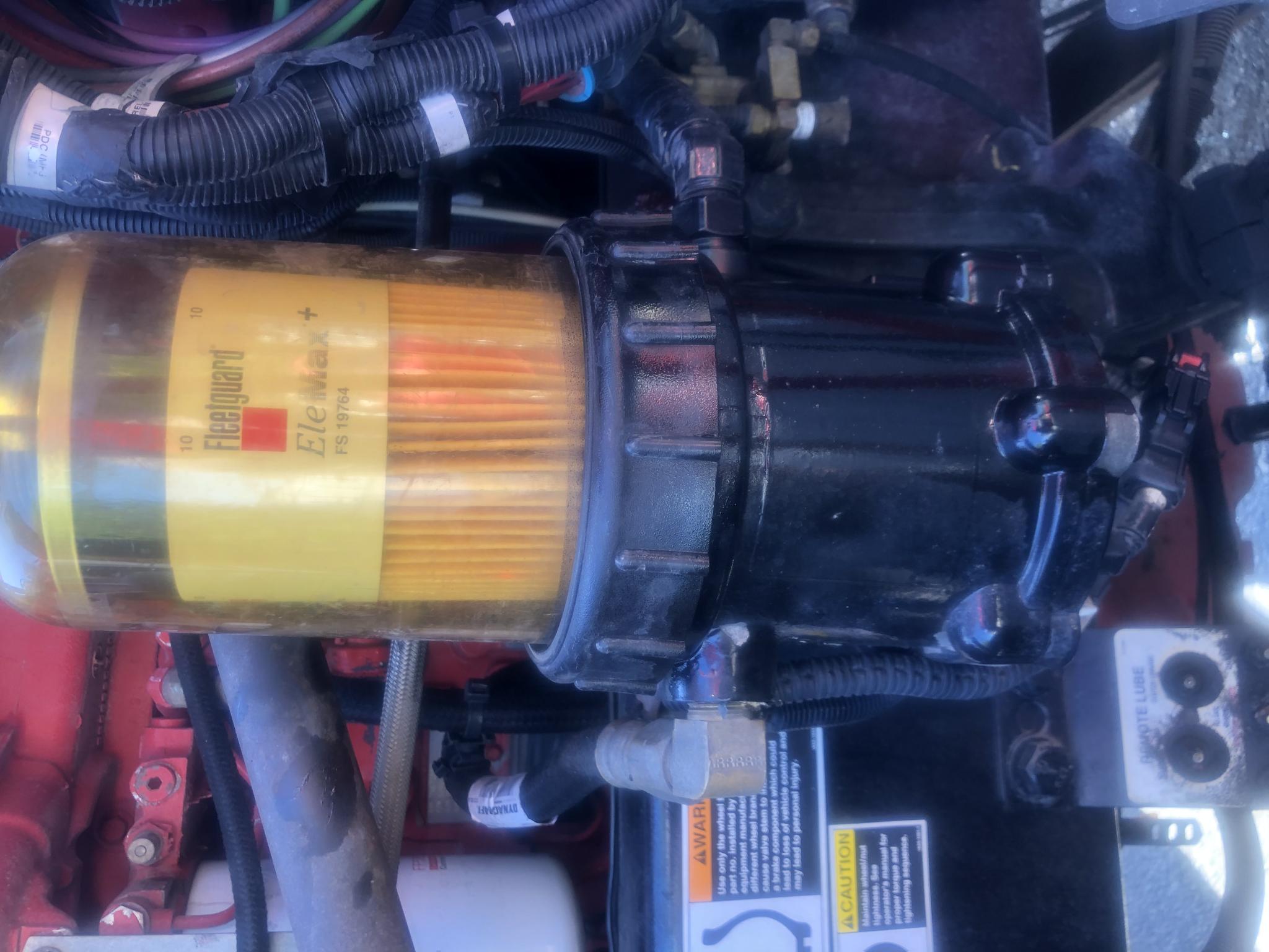

RE: Fault Code: 1145 if the fuel water separator is empty, it will cause air to get in the system. What type of unit do you have?. Maybe a pic or 2 would help too. likely the anti-drain-back valve in the fuel water separator .. or your sucking air somewhere before the FWS unit. User's Signature: ->: What I post is just my own thoughts and Opinions! --- I AM Full Of S__T!. | |||
08-25-2020, (Subject: Fault Code: 1145 ) Post: #12 | |||
RE: Fault Code: 1145 (08-25-2020 )Rawze Wrote: if the fuel water separator is empty, it will cause air to get in the system. Im not sure the maker of this unit as there are no markings left. The second pic with my finger is current fuel level. Last Friday in Amarillo after PM it was about an 1” above the collar. | |||

RE: Fault Code: 1145 take the glass bowl off it and make sure the o-ring is between the glass bowl and the lower housing and not between the retaining nut and the glass bowl. - I had a speedco once stick the o-ring and nut down onto the clear housing from top down then screwed the nut on and it caused mine to run empty like that too. -- you might also want to pressurize the fuel tanks to 10 psi air pressure and see if something starts to pour fuel somewhere. With a 10 micron filter in it, there should always be fuel up on the filter. User's Signature: ->: What I post is just my own thoughts and Opinions! --- I AM Full Of S__T!. | |||

RE: Fault Code: 1145 (08-25-2020 )Rawze Wrote: take the glass bowl off it and make sure the o-ring is between the glass bowl and the lower housing and not between the retaining nut and the glass bowl. - I had a speedco once stick the o-ring and nut down onto the clear housing from top down then screwed the nut on and it caused mine to run empty like that too. I’ll head back over and check that. And considering the fuel pressure drop im getting and 7 counts on fault 1145 for the #6 does it make sense do just replace that injector? Or am i just throwing darts? | |||
08-25-2020, (Subject: Fault Code: 1145 ) Post: #15 | |||
RE: Fault Code: 1145 Checked the o-ring on the glass bowl, it was as it should be, between glass and housing. So, not sure what that issue is, check valve perhaps? Talked to cummins about injector. Of course NO one keeps them in stock now because cummins decided to package them with the connector as a kit and you can only emergency order them at an extra $100. So a single injector with core is over $1100. And I dont have a clue whether i should even replace the #6 or not. 7 counts of the same and only fault, 10k psi fuel pressure drop in 60 secs, suggestions? | |||
